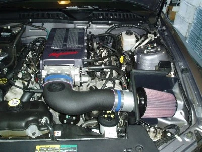

The C&L Racer Kit w/Diablo 93 tune has been working real good for us. Heading back to the Dyno next month to get the most out of it. :nice:

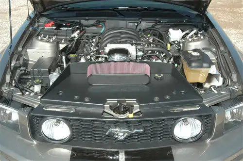

This is why I'm going to go with the WMS CAI using the ram air box as well. It has 3 holes at the front in the radiator cover that force the air in and straight back to the filter. I'm sure at higher speeds, that this could get more and cooler air flow to the filter than the other CAIs using the stock filter location.

Ordered my WMS CAI/SCT X-CAL 2 Tuner Package and Pypes O/R H pipe from Brenspeed just minutes ago!!!!! I also ordered directly from WMS the ram air box as Brenspeed does not carry them. I also want to get 4.10s, but I need to go talk to the people at a speed shop not that far from me that is a sponsor for a Mustang Club to see what they say about install cost and when I could get it done. I CAN'T WAIT, but I know I have to!!!!! The best thing about all this is that my job is paying for it all since it is from my yearly bonus I get every mid January!!!!! So it's not costing me a cent...:D :nice:
