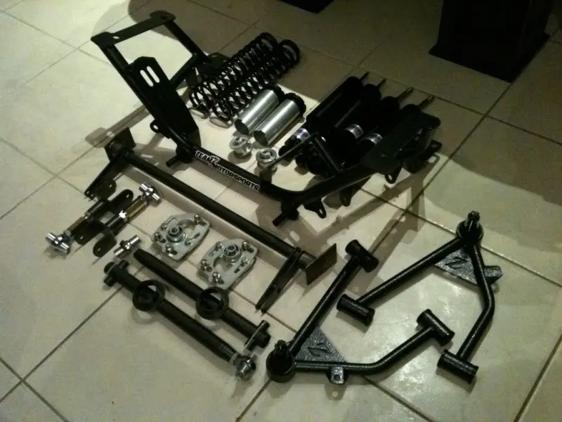

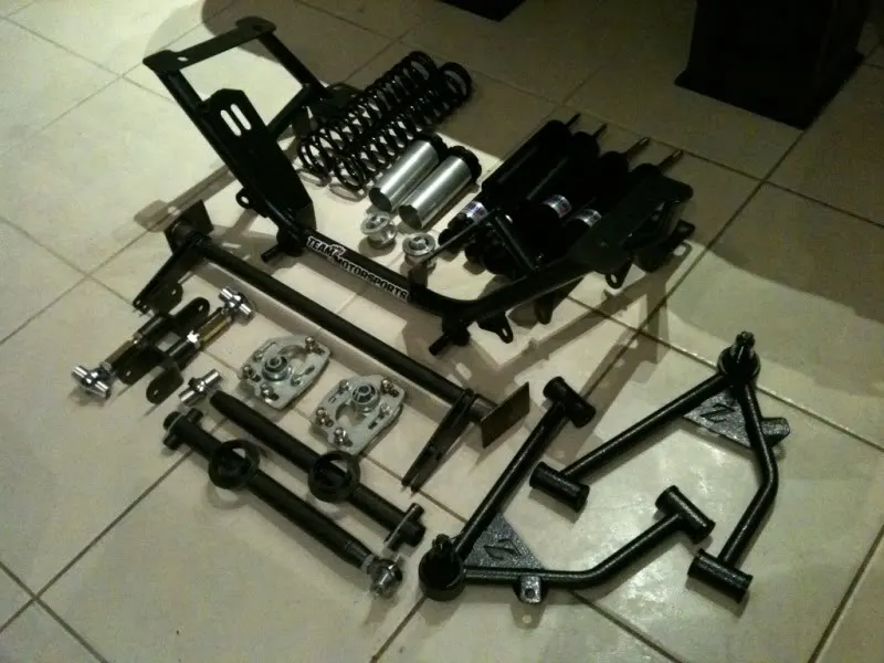

For the money and quality TeamZ is hard to beat. Send Dave Z. an email and he'll tell you what is needed for your application. For our 92 we chose to buy the entire front and rear suspension. You can buy these in sections obviously and I'll bet you'll be blown away by the price for the quality. My 94GT had full Steeda suspension with exception of a QA1 K-Member (not the best quality K-Member). We looked into Maximum Motorsports but it's pricey and we couldn't get enough answers to our questions. Dave Z. responded in like 30 minutes of the first email. He talked to my buddy on Sunday early AM for over an hour. The reason why yellowbullet.com forums and people swear by TeamZ is because of Dave.
Website. All units powder coated and made in the USA.
Team Z Motorsports - Suspension Kits and Components for hardcore Mustangs & more!
Entire front and rear suspension for FOX body Mustang.

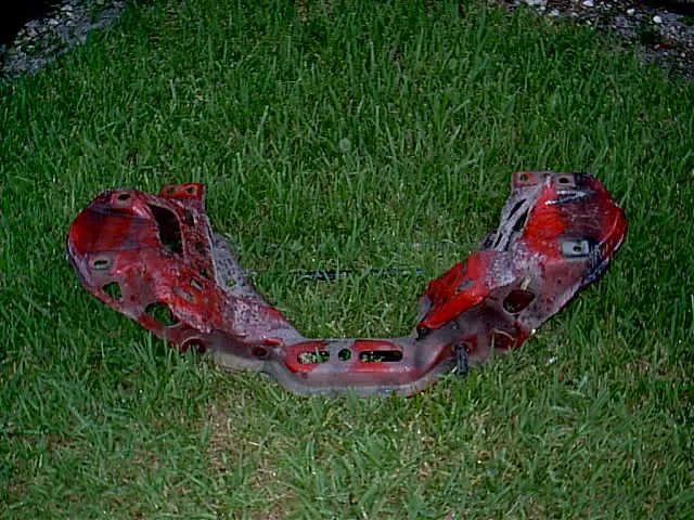

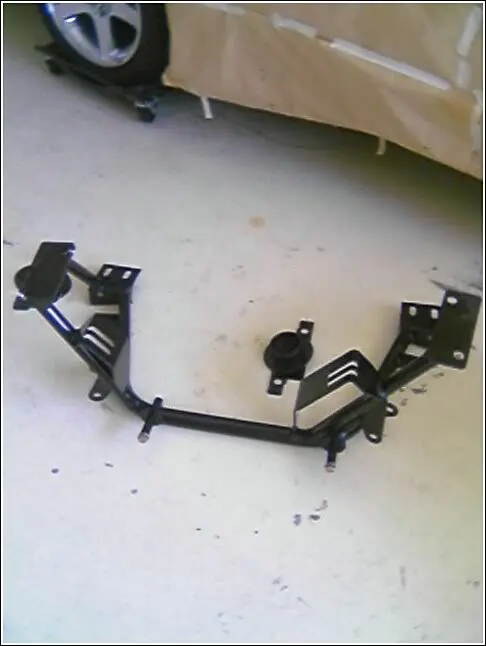

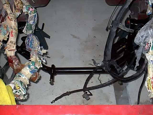

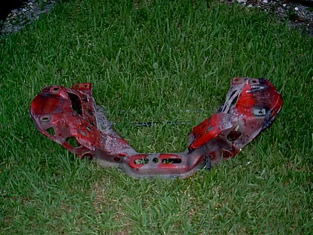

The only K-Member you can use stock A-Arms with is the QA1. You have to grind down some of the stock A-Arm so it can flex on the K-Member. I had that on my 94GT. Although the quality look of the QA1 isn't all that great. I was nervous with how thin the K-Member is and spotty welds. The beauty part about having an aftermarket K-Member other than the weight savings is the room. You can change shorty headers to long tubes in 45 minutes (I've done it with the car on the ground).
The TeamZ piece is serious stuff. It's not thin, the welds are solid and every unit is powder coated. The UPR stuff is nice too. However I'd suggest visiting www.yellowbullet.com suspension forum first for some reading before making a purchase.

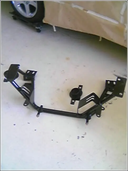

Found some pictures of the QA1 which I bought at Steeda for $219.
