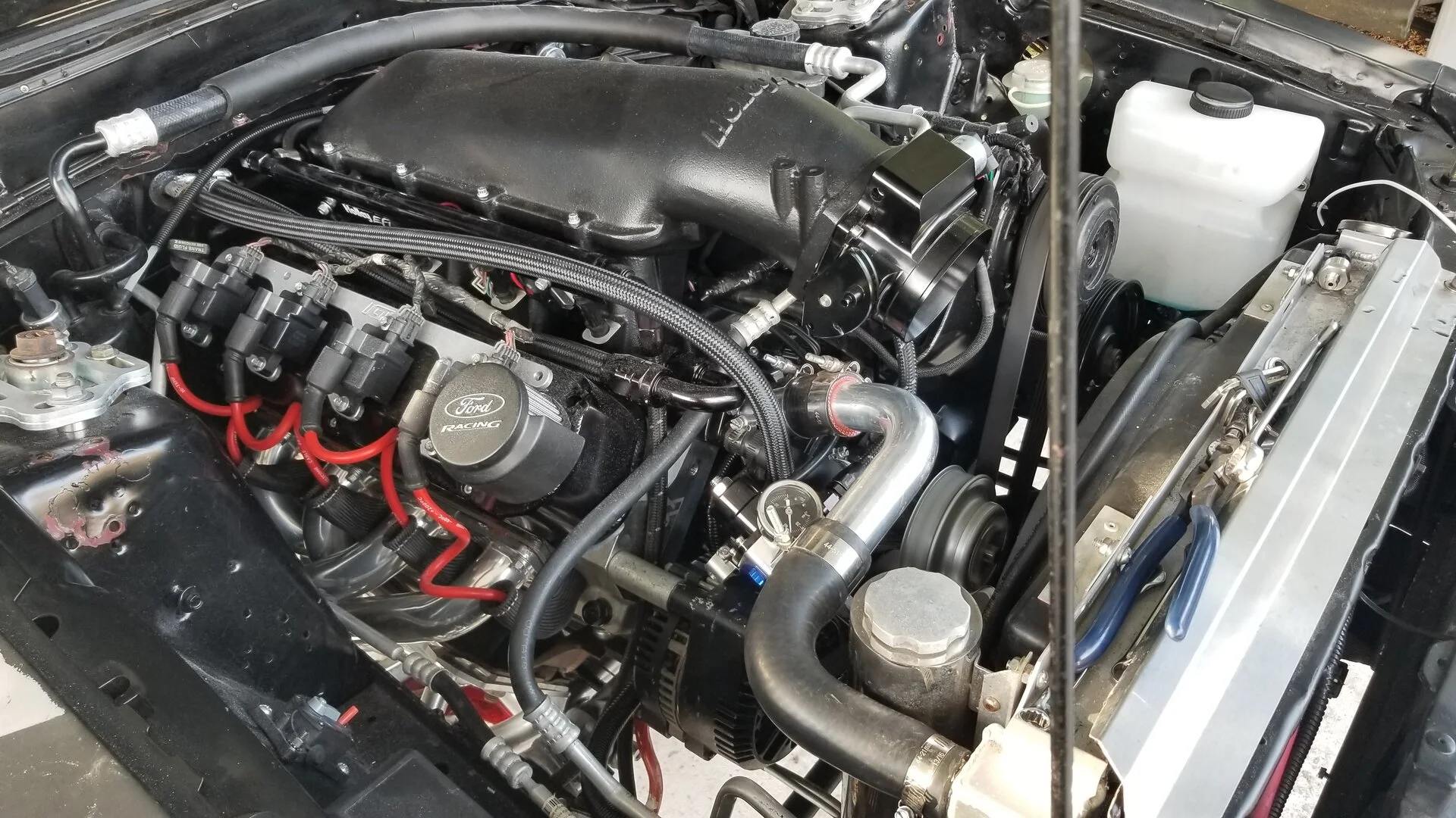

Save some money and use a megasquirt product. An ms3pro or equivalent can be found that will work with the fox harness. My suggestion is to purchase an LS drop on harness with an ms3pro evo. Simply repin the harness for the sbf and use the cam input for the distributor. Imo running a crank and cam sensor combo is more efficient, use an explorer cam sync and a 36-1 wheel on the balancer. Hall sensors make this easy to setup correctly.
Your intake choice is simple to deal with on megasquirt we can tune it with a map and tps combo and the ms even has an itb specific algorithm.
Ls coil packs, will make it look good.
A work in progress.
Doing it this way opens lots of doors..
