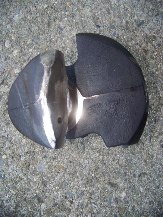

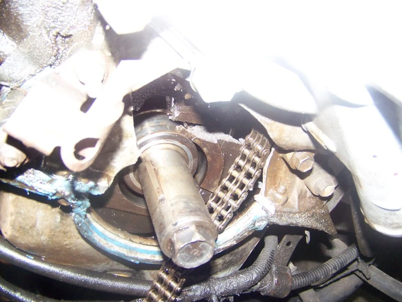

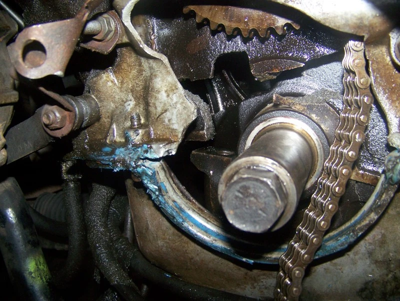

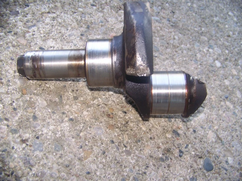

A5literMan said:
Tell her to get back into the kitchen and make you dinner! We got manly things to discuss. Jk. Out of curiosity how in the hell did you break a crankshaft? That is the first one I've ever heard of snapping without a blower hanging off the end of it. Also don't worry about doing that again. Lol. Plenty of ways to have catastrophic carnage but snapping a crank is unlikely.
From what I have read some stock 5.0 blocks develop cracks in the block, once that happens the bearings start to walk and all of a sudden with really no warning the crank snaps. Mine blew out the front of the timing cover, destroyed the block, twisted rods, bent the dist. shaft, snapped timing chain, bent the oil pan. Mine started running warmer, not hot and overheating just warmer than it should have been, I changed out water pump, thermostat, all the hoses, bought new spring for lower hose, blew everything out with air and it all seemed OK so I assumed the stock gauge was going bad, it never made any noise until it made a LOUD noise when it broke. I've talked to at least 10 other guys that have had the same thing happen, the crank broke almost exactly like mine did, luckily I was pulling out of a restaurant doing maybe 15mph when it broke.

BKM48198 said:
That's some good shootin' there. Even the cast cranks in these these are known for being pretty beefy. Don't think I've ever seen a broken one before that's not been from a supercharger.
Reactions: A5literMan

Yeah. All of us can trade stories of ex's and cars. My ex took my 85 race mustang that had an $8000 motor, 2k trans and etc. along with the $1500 trailer, slicks, and other parts and sold it during the divorce to pay for her divorce lawyer
For $4000
That is some serious carnage on the crank man. Never seen one snap like that unless a power adder was the culprit.
For $4000
Some people have said the harmonic balancer was what started it but mine seemed fine, I trashed the one from that motor just in case. I talked with an engine builder that was throwing away blocks because he was finding cracks in them, all in the same spot between #2 and #3 cyld. I must have had a bad block, or a lot of balancers are going bad.
