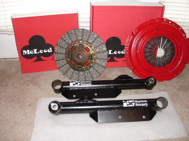

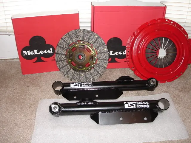

He's Dead. UPS man just stopped by. ;)
As far as 60' times go, I've cut a 2.05 on All-Season Sumitomo HTR+,, 245/45/17. Not the greatest, but with the gears and those tires, I'll take it. Now with the LCA's, I'll be disappointed in myself if I dont pull a 1.9.
Now, which TOB should I get with the McLeod? FRPP, or McLeod?
