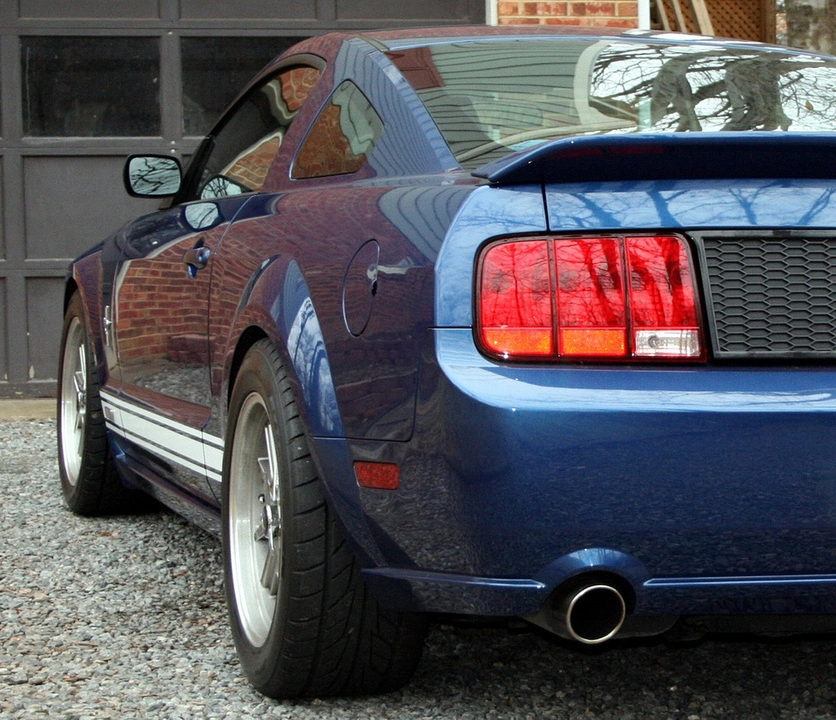

Yep. I'll be adjusting with my XCal2. You can set the tire revs in there. After seeing the setup on Kool's car, I had to have that same setup. It looks so amazing, and helps fill the wheel gap. These cars are craving bit meaty tires in the rear wells.
I use my SCT X-CAL 2 as well to change tire revs. I love how the tall/wide tires fill the fender as well:nice:

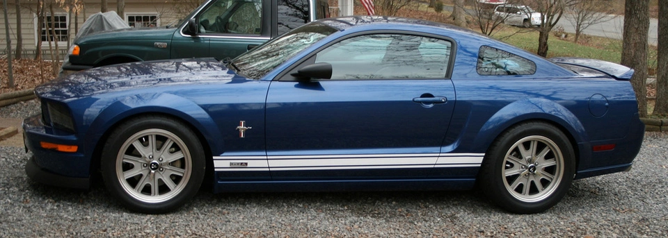

My 295/45 Nitto 555NT on 18x10 dropped 1.2" in the back(255/45 Nitto 555NT on 18x8.5 dropped 1.6" in the front).
