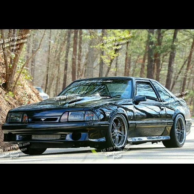

Both really nice cars.
But I can't see how the black car could turn the front wheels.
Let's just say you could get the car that low.
Why would you want to?
No point in asking if you should use a torque arm or what will perform better.
Ride quality is sure to be in the gutterl, that's pretty much zero travel.
Without a doubt traction suffers and there is such a thing as too low for proper handling.
My guess would be both those cars have air ride and can be raised.
If they don't, i'd guess both are capable of knocking fillings out unsuspecting passengers.
