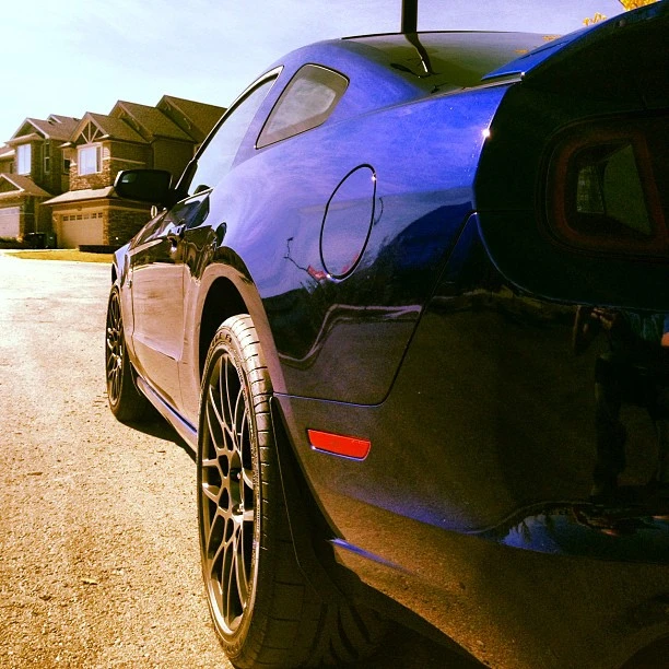

Hey guys,
I am wondering if anyone has some experience with this subject. I live in Canada and during the summer when the sun sets the temperature drops off quite a bit, I put GT500 rims and tires on my stock 2013 5.0 and they have the stock goodyear eagle f1 supercar tires on them, I find that they are very hard to hook up in 1st through 2nd gear, it tends to spin through the majority of first and maybe 1/4 of second gear. I am looking at putting on a set of Nitto NT555R drag radials... they are 305/35/20 and call for a minimum 10" rim to mount them on, I believe the gt500 rims are 9.5" on the rear...
Any other suggestions or experiences would be welcomed. Thanks in advance.,
Same tires on my GT500. They stink in the cold. In fact, Goodyear tells you not to run them in temps less than 40 degrees F.
The go-t0 tire for all of the guys running the 13 GT500s are Michelin Pilot Super Sports. They seem to vastly improve the traction, and don't appear to have cold temp issues. I doubt they'll be any good in snow, if that's what you're looking for. I've heard good things about Continentals for an all-season.
You're definitely going to have to widen your rims to run 315s.
What kind of "cold" temps are you talking about? If it's regularly around 0*C or lower, I'd go at least with all-seasons, or maybe even snow tires (if you're going to get caught in the snow occasionally with it). I've heard very good reports on the Conti. Extreme Contact DWS tires. :)
The car will not be seeing any snow, I will generally be driving it from June to October... I would say on average the evening temperature would be around 10-15°C with not too many nights with warmer temperatures, there were very few warm nights last summer where the tires would grip under hard acceleration.
