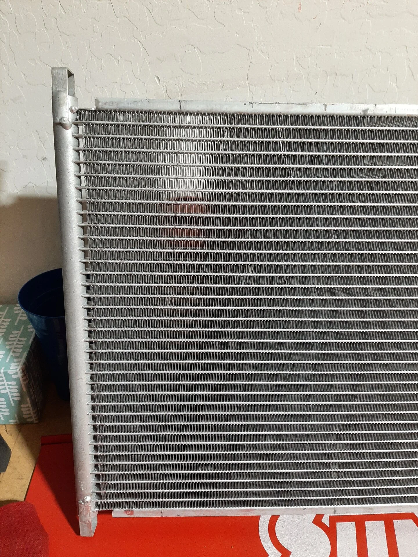

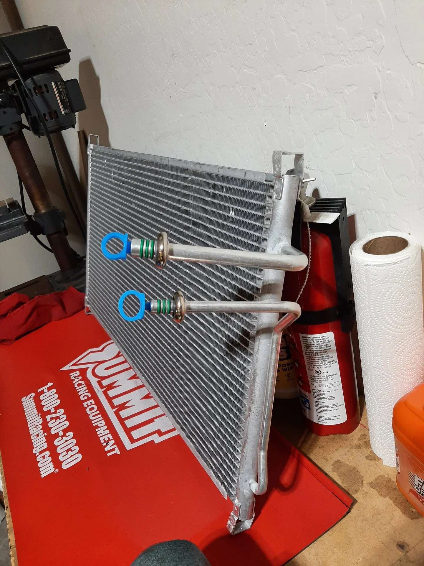

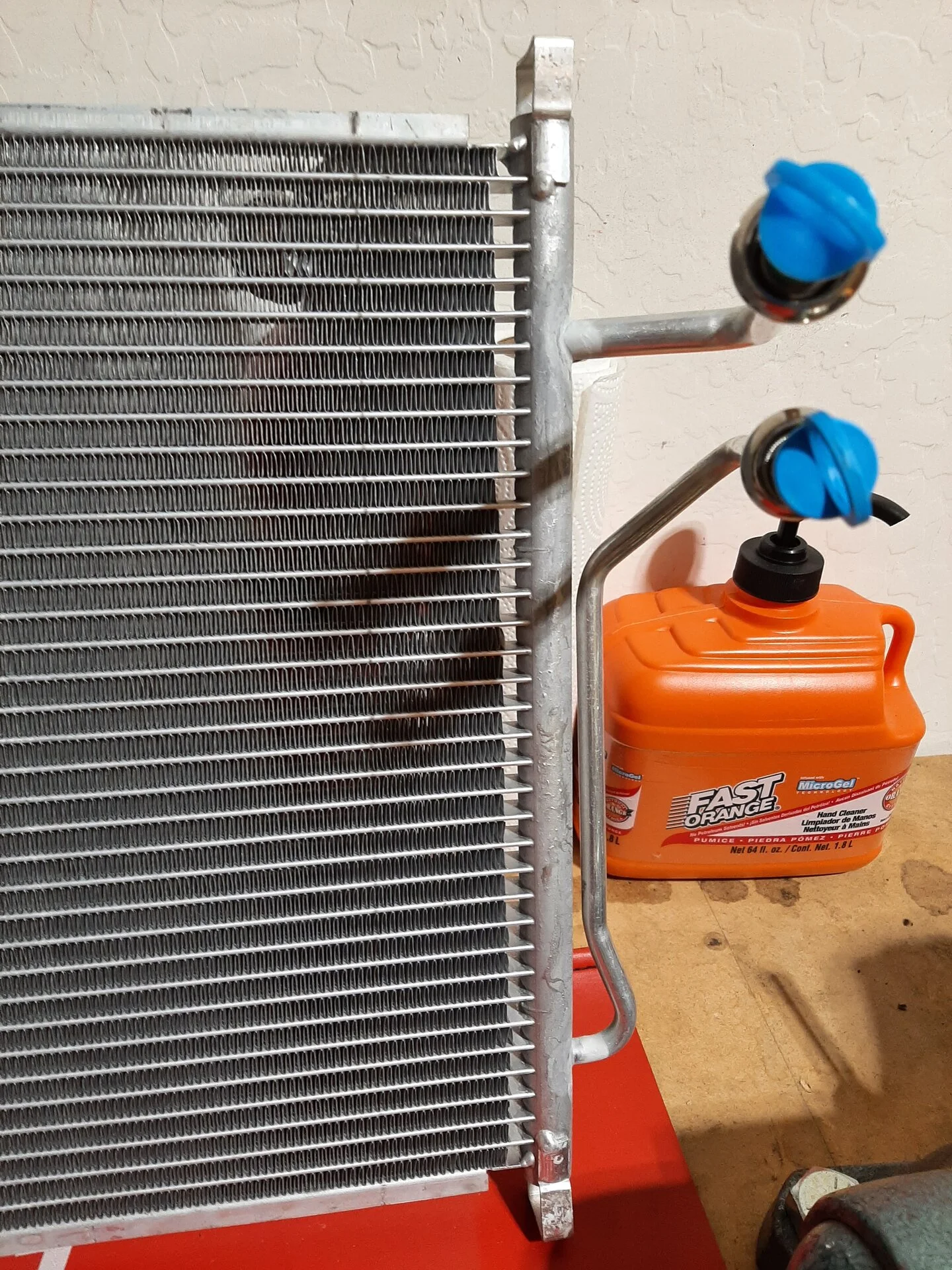

Here are pics of a Spectra unit I ordered.
There are no end seals or provisions for them. These seals are very important. The 2 lines come out at a different angle and they are longer.
The OEM unit is actually beefier built than the Spectra.
So; a repop '97 condenser isn't a mirror image of the original. Aftermarket companies are under no obligation to copy the original to the "T".

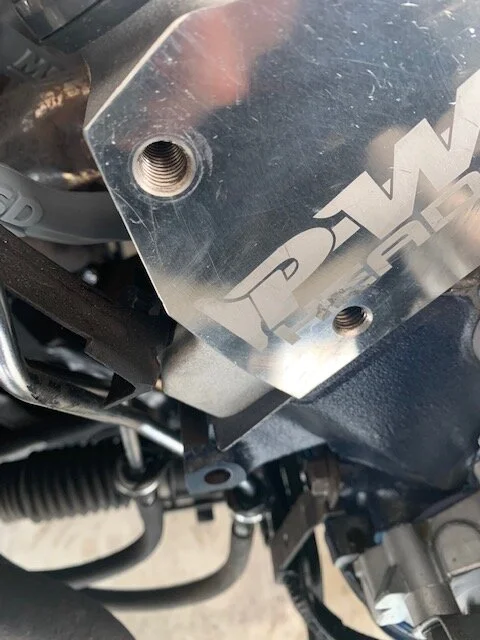

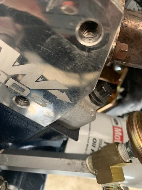

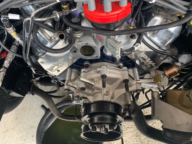

Before I rebuilt the engine, it was a stock 302 with an AOD with the usual bolt ons, stock fan and shroud, a/c worked mint and the engine never overheated. I tore the car apart to freshen up the 302 and it morphed into a 347 and built AOD with a stall convertor and Lentech valve body, this is where I'm at now with it running hot. Today I took the front accessories off just for my own piece of mind, as you can see from the pictures, the head gaskets are in correct, thermostat was a 160 degree (forgot is was that) and was installed correctly.
A lot of you guys are saying it's my fan/shroud setup, it overheated EXACTLY the same when I still had the oem fan and shroud installed.
I want to remind everyone that I have oem pullies, new Motorcraft water pump, rotating the correct way, SVE aluminum rad with the rad cap it came with, Mishimoto fan/shroud combo, I have the Holley set to turn both fans on at 185 degrees, fans are PULLING air through the rad. It will sit and idle at approx. 190 degrees and not overheat, as soon as I start driving it, it will climb to about 222 degrees before I get chicken and shut it off. I'm at my wits end here. Looking for any ideas you guys may have.
I don't recall,how did you "burp" the system? I never had a problem with any of my Foxes,except my current one. I HAD to use a no-spill funnel to get the air out. BTW,I'm running a 331 with turbo. Champion radiator,HD water pump,HD fan clutch.

I said this before, and will say it again. The Mishimoto fan/shroud setup flat out sucks. My car overheated constantly with this fan/shroud setup. I switched to dual contour fans and never had an issue after that. My car has an On3 Turbo and I live in Hawaii. Yeah, it's not 118 degrees here but it isn't exactly cool here.....
