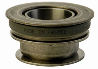

I seem to have a problem with tobs. I had one installed last week that was in my car for about a year and two days later the new one went to crap. I looked at it and saw it has some small chunks missing. I was wondering if they make any aftermarket throw out bearings that will actually last.
MMR Competition Throw out bearing (better seals and bearings) 300100 $39.99
