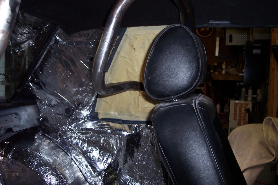

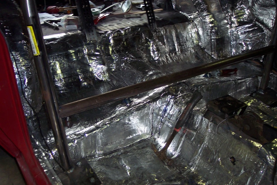

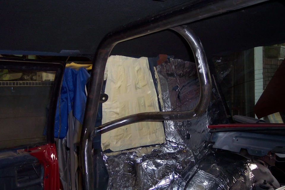

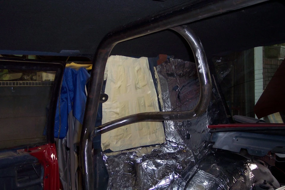

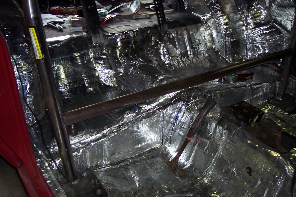

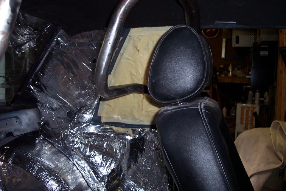

I used Stinger Road kill. pretty much exactly the same as Dynamat, except that 36 sq ft. cost me 95.00. So between the Fat mat and this Stinger stuff, the price is about the same. I went a little farther than 90 LX did w/ the product, (up the sides of the inner quarters to the headliner), and like his results, the noise level is so good inside the car you forget you're in a Mustang. Probably added 60+ lbs. but no regrets for my street car.
Here's mine:
Unlike 90 LX's car, my roll bar serves no structural purpose other than to hold my seatbelts though;)
