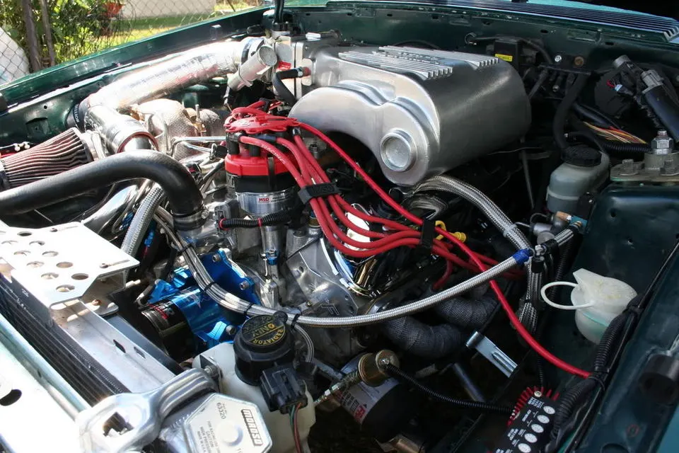

I have a 92 GT, with a heads, cam, intake & a Hellion kit with a 62-1 turbo, 9 lb spring.
Here's my problem:
When I try to accelerate, either rolling into it, or just standing on her ( w.o.t. ) ; just when it's about to make decent boost ( 80% or more throttle )( and always above 3500 rpm's. around 4-4500 I think )
The car will suddenly fall on it's face! It's like it just goes dead, for just a split second ( as if you shut the car off ) then roars back to life with more power than I've felt her have before.
At first, it would only do it once in a while, now I can't even get full throttle, cause the second it gets up there and starts to make boost in the upper rpm's, she just bucks real bad!!
It will cut out as if I shut down the car completely, and if I keep into it, the car will roar back, but fall flat again instantly, over and over. It doesn't clear up anymore. ( I'm afraid I will break something very soon ).
When the car bucks, so to speak, the wideband is showing that car is running fat ( 10.2 / 10.8 / 11.2 numbers like this @ w.o.t. ). The boost gauge shows it hitting full boost, then nothing, then back to full boost.
I have checked the following:
- pulled the plugs. good coloring. Checked the gap: .32 thou
- checked the plug wires: All good. Had an extra set, so I threw them on anyway.
- checked the Digital 6, seems to be fine.
- pulled the MAF and cleaned it, seems good
- checked the timimg, seems fine
- I have never heard detonation from my car ever, so ruled out timing
The car has a tune, witch is just set up for more safety reasons than performance right now. ( till the tunes finished at least ) just keeping it fat and safe for now, till the bugs are worked out )
I did strap the car down, and untuned, completely stock untouched bottom end, she put down 500 rwhp & 540 torque.
And it never hic upped, or fell on her face, this just started about 2 weeks ago. Right from nothing it seems
So. I am at a big loss here. Has anyone had this problem before? Any ideas?
PLEASE HELP!!!
I hope I posted in the right section, if not please let me know.
Thanx
