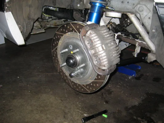

im calling this project nightmare. this all started with trying to upgrade my 4 lug brakes. that failed, in the process i replaced my tubular arms, with new tubular arms. between installing/removing the 4-lug stuff on the NEW arms, i have had to replace the balljoint on each side once.

anyways, it is now going to be equipped with the m-2300k kit with some tweaks and upgrades. here is some progress pics, hoping to wrap it up over the weekend.

update for tonight;
