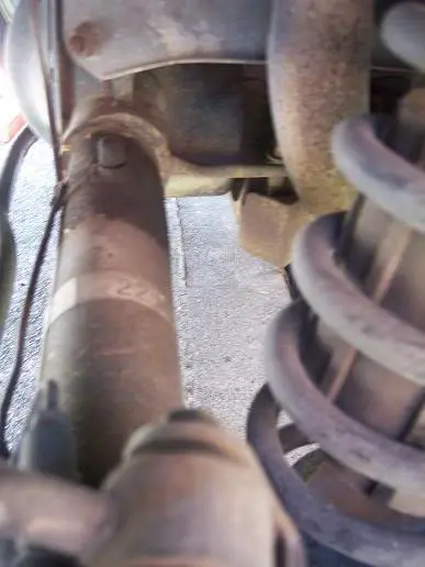

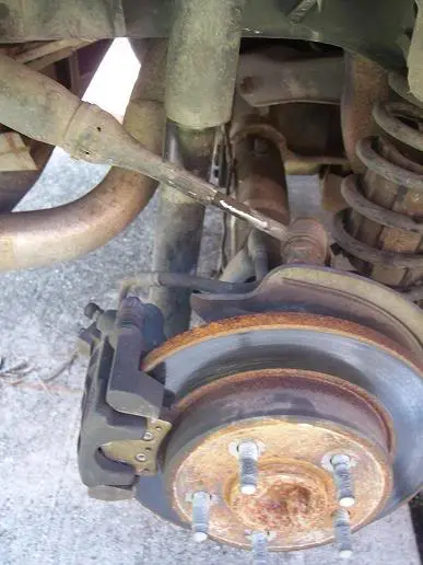

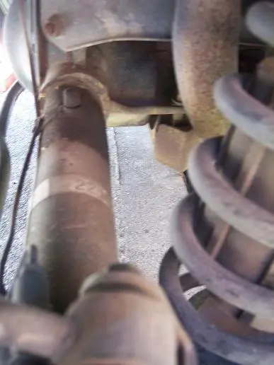

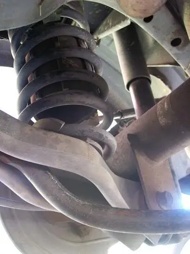

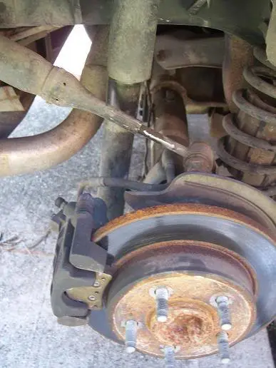

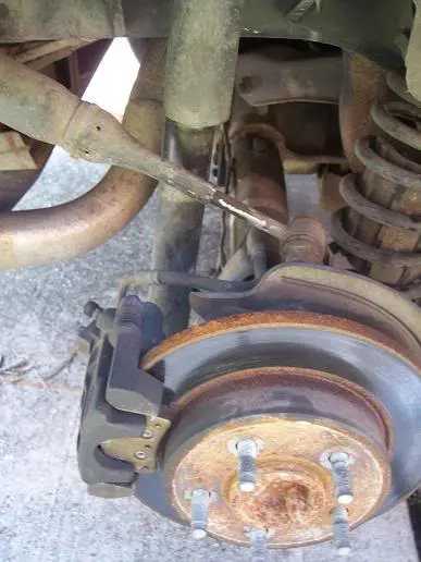

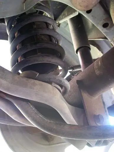

ok, i took off my rear pass side wheel and poked around... still have no CLUE what i'm looking for lol... nothing seemed loose. I doubt u can tell much from the pictures but i figured i'd let you guys get some idea of what i'm looking at...

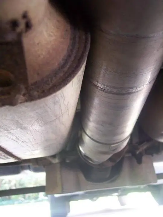

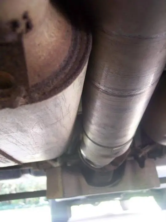

the second and third pictures show something i thought was kind of fishy. My pass side rear tire was jacked up all the way and i removed the wheel so the car was at a strange angle but still the muffler shouldn't be touching the drive shaft like that right? I figured this could be the source of the banging but i have no clue... anyways i hope these pictures help out a little.

well when the car isn't jacked up like that the muffler isn't hitting it...it is kinda close though... anyways, maybe if i stick a cloth inbetween the muffler and drive shaft and then drive down the road and do a break check to see if the noise still occurs....
if anyone knows any reason why i shouldn't do this test or knows an easier way to see if thats where the sound comes from please tell me. :-)
The cloth might rip off, dunno if that's a good idea. You should check the exhaust hangers and the rubber isolaters they're hanging on. You should be able to loosen the bolts holding the catback on that side, and shift the muffler out of the way some.
Also, I saw your spring isolater in the first pic is cut. That mgiht be causing some noise as well. Somethig to put on the upgrade list.
looks like that muffler is too close-i hate to sound like a dick but thats a problem. your exhaust moves when you get on 'it and when you hit bumps. its held on by rubber hangers which allow it to move. if you cant do fix this yourself get it to an exhaust shop and tell them to check your muffler/driveshaft clearanc issue-they can take it from there.
im guessing you moved your exhaust alignment on impact. its just metal it can and will bend-luckily it can be bent back
gcom, lol looks like u got it... +10 for u

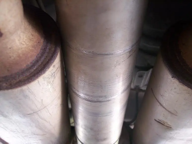

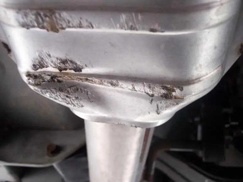

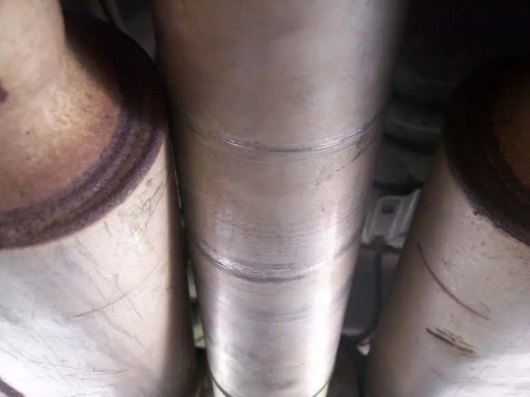

this time i put it on some jack stands and after further inspection it looks more like the h-pipe took more of a beating than the actual catbacks... and sence the h-pipe is bent or.... kind of dislodged, i figured that might be more the problem... anyways once again: pictures. I want y'all to see what i'm seeing.
<p>
ok heres a shot of the cats, they look uneven, but this is my first car so i'll let u guys tell me
<p>
this is the scar from... the horrible speed bump

On your problem, I agree with the other posters who say there is no way your muffler should be that close to your DS (jacked up or on the ground). The mark on your DS is key evidence of contact. It's hard to tell from pictures, but your mid pipe may be bent out of whack. If so, I don't know whether it will be more work to fix it, or just get a new one.
But if I were you, I'd start by loosening all the bolts at the header to mid-pipe, and mid-pipe to cat-back. Then try to wrestle the exhaust back into proper position. Start from the front of the car and work back. Get that mid-pipe back on both hangers. And get the passenger muffler away from the DS - about the same distance and the driver side is in your picture.

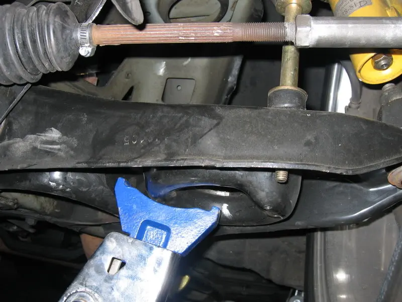

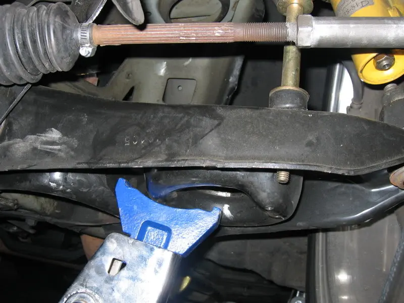

A safe place to place your jack stands is on the front LCAs. Place the center of the jacks between the 2 openings, just under the spring perch. Once on the jacks push on both front fenders to make sure there is no movement. Where you have them now is a recipe for disaster because you will be pushing and tugging.
do u think u can get me a picture of what ur talking about? i'd superly greatly appreciate it.
Here is a picture. When I was under there I realized it may not get up high enough for you since you are doing the exhaust. It should work but if not it's good for future jackings.

and beings nobody told you the little shock in this pic that runs diagonal is the quad shock
