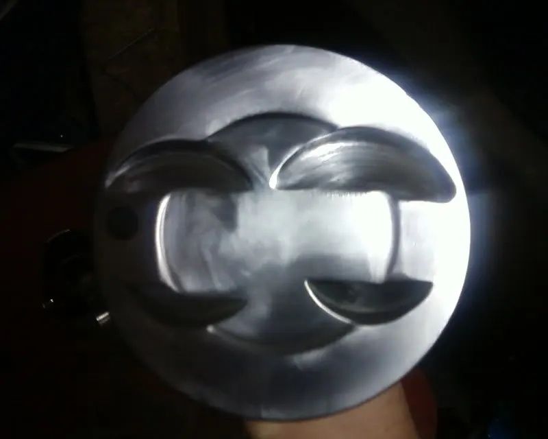

you wont be able to do it with 2.02 valves i think they hit even with the stock cam.
i had to cut my pistons it was a freakin PITA!!!

Hahaha. Take some pictures of yours.

Nov 13, 2009
  • Nov 13, 2009
heres mine
