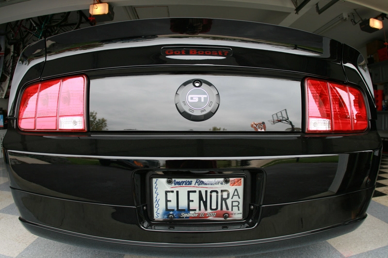

Was the first thing I did with my car back when I got it.. Here's a shot - Flat Black for a little break up from the gloss paint. I have a Gloss Black one as well that will be going on ebay this week..

After seeing that pic so many times now, emay...I couldn't resist any longer...
Jordan made it over to your place...

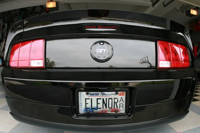

Sorry to be off topic but in the reflection of your trunk lid. Is that Michael Jordan dunking on your basketball hoop? Don't know why that caught my attention. The flat black emblem is sweet by the way. I'll be doing that once it gets warm out.

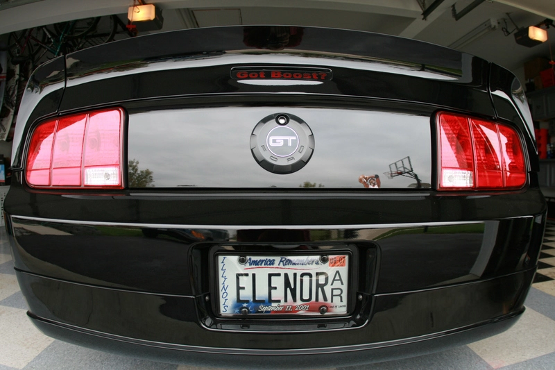

Thanks, emay!
Back on topic... If I hadn't gotten the honeycomb tail panel, I might have blacked out the faux cap, but to me, that would be too much black back there and it would get lost.
