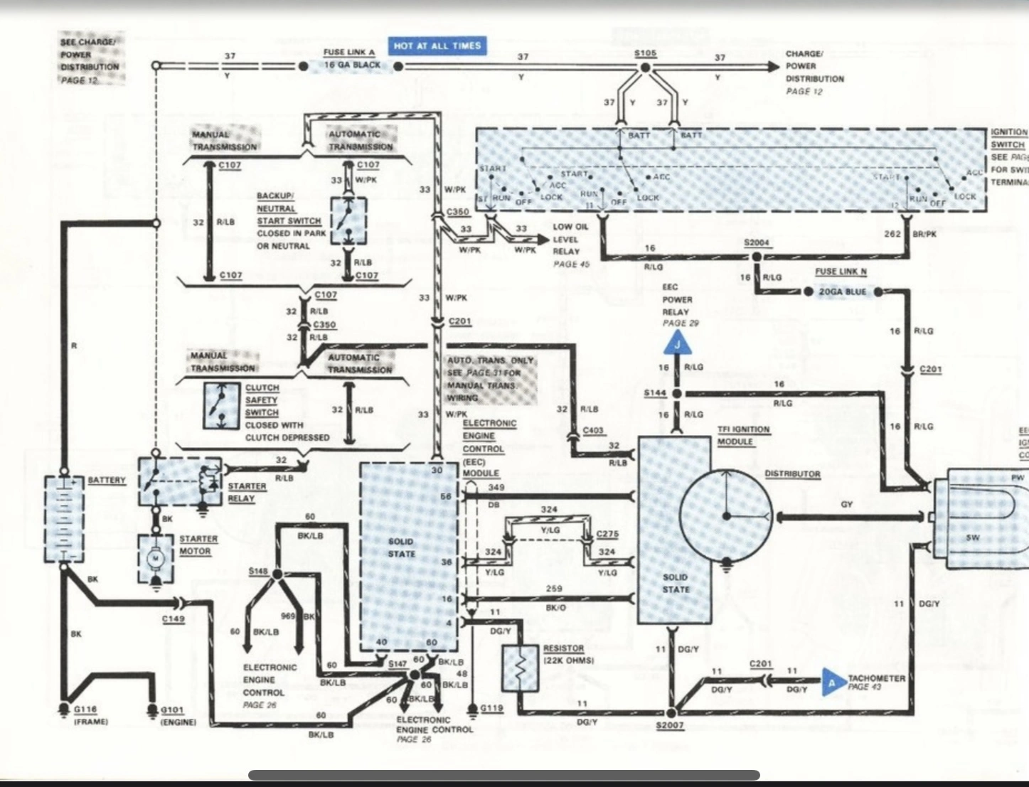

FastDriver said:
I think my A9L was both problems. The ticking/clicking was it's way of trying to warn me.
The ECU relay is located right about the ECM. There is nothing inside the ECU itself that would click so it could be the ECU relay opening and closing that is making that sound.
The coil for the relay is fed from the ignition, but bounces around a bit on the wiring. This is the '88 EVTM but i think it's the same other than wire colors. This may point back to a failing ignition switch. Wire 16 off the ignition switch, through the fuse link by the wiper motor and on to the coil/tfi and then connection J to the EEC relay
Reactions: General karthief

Replaced the ignition switch early on with all the electrical gremlins the car had, but I think I have another one on the shelf and don't mind swapping again. As far as the EEC relay goes... great... I'll look for it.

EEC relay also powers the fuel pump relay. SO if you lose the ECU relay it kills the pump momentarily as well.

Found a spare EEC relay on the wiring harness that used to be on the blue '93. Swapped it in. No dice! Cleaning 10-pin connectors next.

Can you confirm that the relay "clicks" when you turn the key to on?
edit: nevermind. If the fuel pump is priming correctly, it's being fed from the relay so it's working
