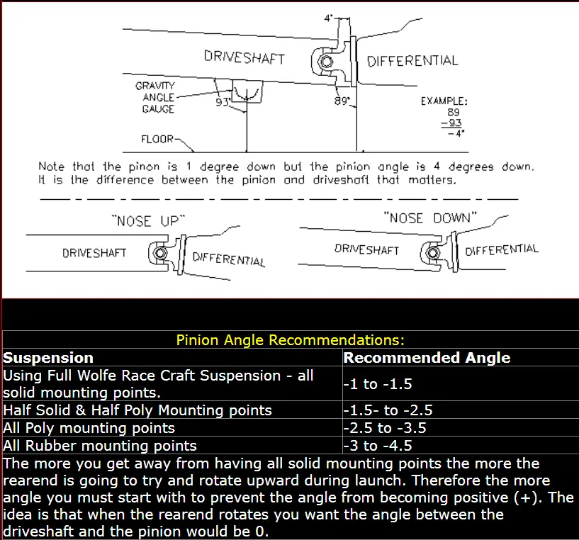

Along those lines, this is an old explanation and table of recommendations from Wolfe Racecraft:
I would add that knowledge to the article I posted earlier when I talked about setting pinion and engine angles at parallel under normal operation.

More or less finished T56 install. The yoke is significantly further out than it should be. Looking for 3/4 - 1". It's ~1.8" out. With 1.5-1.7" of spline engagement I decided to go ahead and take it for a cautious spin.
It went ok. 1st 4 gears are fine. At 50-55, it started vibrating. Tried 6th, which made things worse. Decided to take it easy & come home. Vibrations maybe be the pinion angle being completely out of whack, as I maximized the spacers on the trans. Might take a look at that tomorrow.
I'll get an 11/16" spacer Mon-Tues and install it. Then, I'll feel more comfortable doing a more rigorous test drive.
Despite the fact that the pigtail connected right up from the OSS to the old VSS connector, Michael Bell was right, it seems. Cruise control does not work. It accelerates when pushing the button, but does not maintain speed.
My biggest hope it to get rid of the vibration between the pinion angle & driveshaft spacer. If that happens, I'll be very confident in working through the rest.

Finished up the T56, tonight.
Driveshaft length is a bit short: I received the Steeda 11/16" spacer. It should have been 0.6875", but measured 0.669". On a straight edge, it looked like the yoke extended out beyond the output shaft housing by ~1 3/16 - 1 1/4". Ideally, I wanted .75" - 1", but according to the other rules of thumb, the amount of yoke-to-output-shaft spline engagement will be fine. I'll keep my eye out for a 44.5" driveshaft, which, without the spacer, would be just about perfect. But, I suspect, this will be good enough. While, I have a 44.5" FMS driveshaft on my garage floor, the vibrations it caused eliminates it from ever going back into a car.
*edit:* I'm editing this for my own future reference. After a lot of subsequent work on the D/S to reduce vibrations, I realized that I'd been measuring wrong. I used the point on the yoke that begins to expand away from a 'flat' cylinder as the baseline for measurement. I should have bottomed out the yoke in the transmission, because the yoke will not fully go into the trans. It was difficult to get a perfect measurement with the tools I had available to me at the time, but I believe the distance I'd been measuring as a baseline was 1/2 - 5/8" with the yoke bottomed out in the trans. Therefore, given the measurements above, it would put the actual yoke extension at between minimum 0.5625" (9/16") - 0.75" maximum. This may be worth addressing later with more precision as .5625" may present some risk of impact to the output shaft. This also means that a 44.5" driveshaft would not work. Another option to consider may be a better yoke. I believe the yoke on my buddy's D/S went all the way in, despite being perceivable the same length. In any case, for the time being, I'm choosing to take the risk.
Vibration very minor and/or eliminated:
I checked the pinion and engine-trans angles. The pinion was nose up ~2*, while the engine-trans was nose up ~2.3*. I left it alone. On the test drive, it no longer had the vibration that the old driveshaft caused. The D/S spacer probably helped in this department too, by moving the forward U-joint closer to the output shaft and reducing any wobbling that the previous limited spline engagement length may have caused. While there is still a minor tremor above 75 mph, it feels like it's the rear tire and not the drive line. More driving will help me figure that out. I suspect it may be my old Nittos. I plan to swap the winters back on at some point to test that theory. It's possible the new-to-me-but-used driveshaft or its yokes may be to blame, but my gut tells me that they aren't.
Driving Impressions & Gear comparison:
I could tell a MASSIVE difference with that 2.66 1st gear. I gave it a sporty-ish launch, and it bogged like it never has with the older 3.35 1st gear. I revved to 3k and came out of the clutch aggressively, was not at WOT and it bogged down pretty far. With the 3.35 1st in the T5, anything above ~1,500 RPM would have easily spun the tires. The T5's 1st gear yielded ~26% more torque than the T56.
It didn't like 6th below ~50 mph (~1,300 RPM), where the engine has some pulsation.
For comparison's sake, 1st gear will run just about 10mph more (44 vs. 34 mph) to the limiter. I'm honestly not a fan of how much harder it's going to be to launch the car, now, but I am a fan of how much more useable 1st will be in normal street driving. In 6th gear at 80, I'm taching 2,150 RPM on the 275/40/17 Nittos, whereas with the T5, I was right at 2,900 RPM. That's a HUGE difference to NVH, and I'm sure MPG, that will make things nicer on a longer trip!

FastDriver said:
Vibration resolved... mostly
Well, guys, I got the driveshaft back from the shop. The fella I worked with there, named Michael, said that while it was balanced, run-out was about .030" on each end. He used some heating/cooling technique to straighten it out. Said when it was done, he had it to about .008". He said they liked to see .005" but that was the best he could do.
I reinstalled it, this morning. I'm excited to say, the improvement in the vibration is a night and day difference! Now, before I lead you on about it, I can still feel a very slight pulsing at 75. It's something I can live with, and I will not buy a new D/S over it. However, it's also something I would sense even if I drove the car for the first time, and it's unfortunately at a speed I spend a lot of time on the highways at. That said, by 83 mph, I can't feel it anymore unless I'm trying to feel it by holding the shifter and focusing on it. By 90, it's gone, even there. Under 70-ish, there's also nothing. I'm so relieved to have finally found and almost entirely resolved it. It was maddening. Now, I can turn my attention to other things.
Here ya go, guys. The D/S was perfectly balanced, but it wasn't 'true'. It had a runout of about .008" which continued to cause a noticeable vibration and after more driving after the above post, I'd say it was most perceptible from about 63-80 mph. The vibration was no longer overwhelming as it once had been, but it still was annoying. I also don't think prolonged use would be good on the main bearing in the trans or the pinion bearing in the diff. So, I plan on scrapping it.
edit: And now (29MAY23), I think the driveshaft was no longer a problem, at this point. Turned out that the rear carrier bearings/pinion bearings were at least part of the driveshaft issues that I had. The original driveshaft was definitely contributing massively when it was out by over .030", but at .008, it was probably no longer a leading contributor, though it may have been the cause of wear for the rear-diff bearings.
