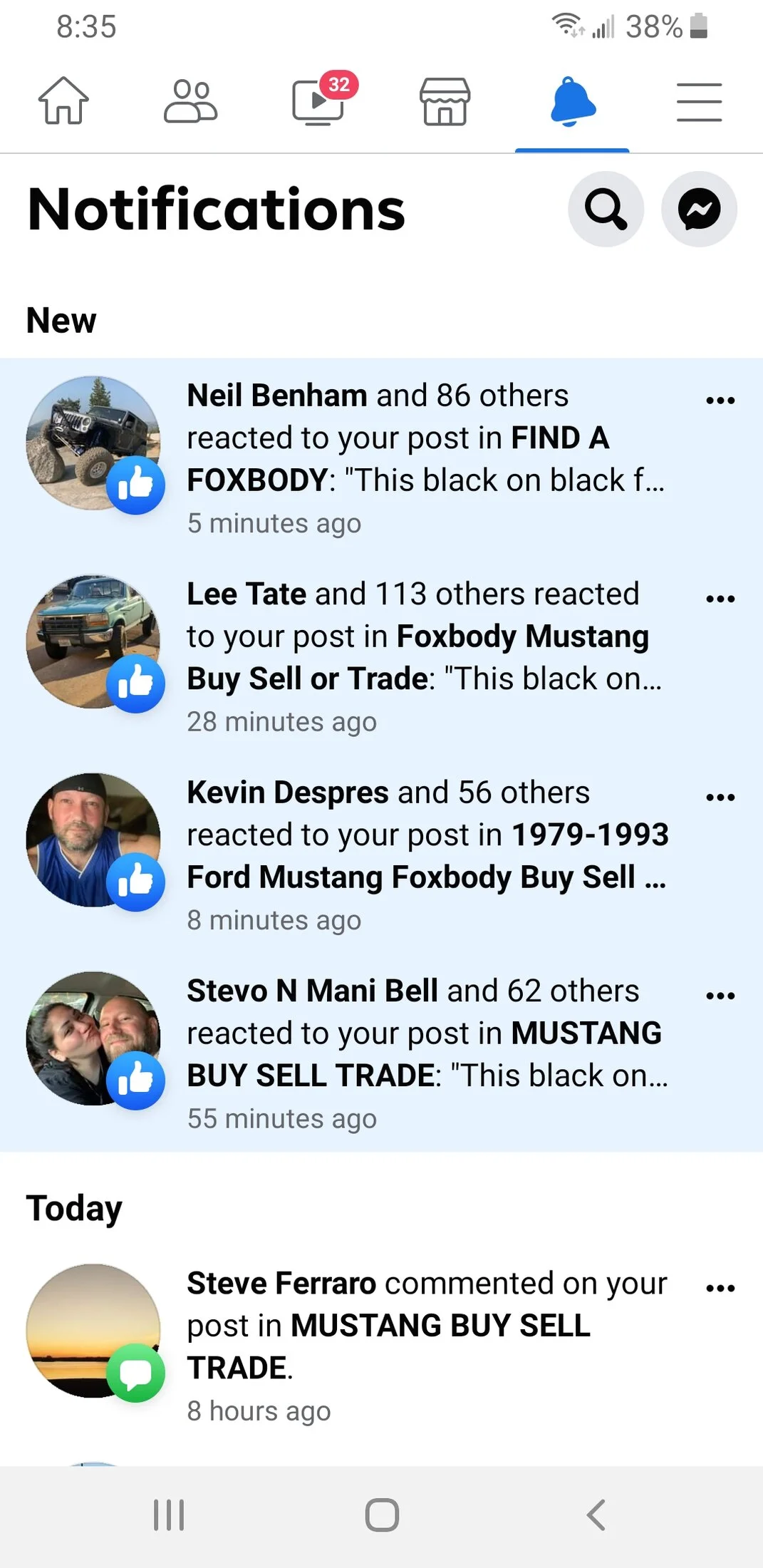

At over 300 reactions in 2 days, it's getting plenty of attention. One guy says he's gonna try to put the funds together. 2 others are in the Fort Bragg area and say they'd come see it if I brought it out there. It's all talk at this point, but it has given me the impression it could go for asking or perhaps more.
While I don't do this hobby for the attention of others, it's refreshing to get such positive feedback on Black Jack.

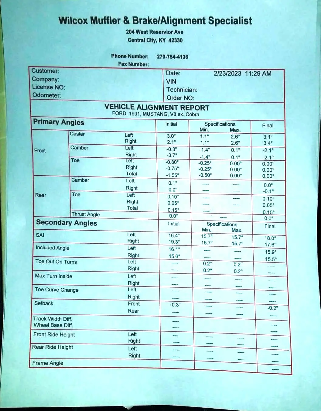

Remaining Minor Vibration Resolved:
Alright, so it's not absolutely flawless, but before I took the new driveshaft to the driveshaft shop, I wanted to give the U-Joints one more go. The ones that came with it were obviously used. So, I swapped them out, tonight. The vibration that bothered me is finally gone. It already was minor, but now anyone driving/riding in the car for the first time will not walk away thinking there was anything out of the ordinary. This is so relieving. Black Jack has never been so smooth! It took 2 transmissions, 2 sets of U-Joints, test fitting 3 different drive shafts, Wheel & Tire balance, Axle bearings, messing around with the pinion nut, Adjustable Upper Control Arms, learning to and aligning the pinion, D/S, & Trans. I learned a lot along the way.
MM Caster/Camber plates & Steeda Bump Steer kit:
The other thing I had someone else do for me, today, was install these kits and align the car to my specs (-2* camber, 0 Toe, & up to 6* positive caster or as far as it will let you go. I admit I was a bit disappointed with the caster results, but the rest came out right on the money. The caster isn't terrible, but before the plates, the same guy manages about 2* of caster:

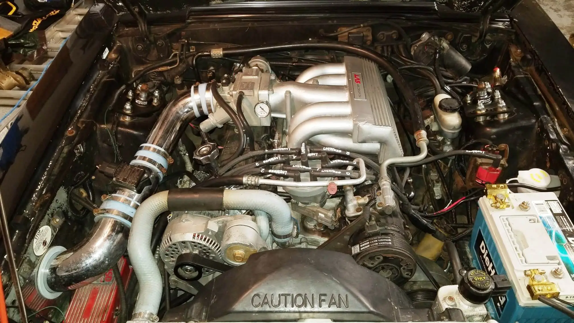

Updated engine bay pic:

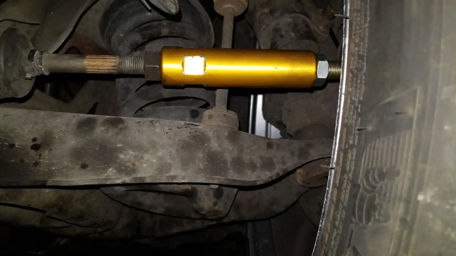

Bumpsteer kit, a.k.a. tie-rod end extender:
Alright. I've done what I've set out to do, and I'm going to lay low for a while. It's time to turn my attention to outprocessing post, packing, and moving. Never been more sick of working on one of my cars, but now that it's done, I think/hope that I'm in a place that I can just drive and enjoy.

Feb 24, 2023

I had a similar issue/problem trying to get caster on my 92 but I'm hoping it will be better when it's all done with the build since it will also have the K member and control arms.

I wondered if their standard K-member would help since it moves things forwards a bit.

I am running the full MM suspension on my Coupe and the most I could get is 4.5 degrees. I am running the reverse offset control arms so the wheels are in the stock location and so I did not have to relocate the sway bar. If you run the non-offset or forward offset control arms you will get more caster but realize this will move the wheels foward 3/4" and 1-1/2" respectively.

That's how it is on my blue car. I'll take a look to see if I can find its caster setting.

It is. But it works.
