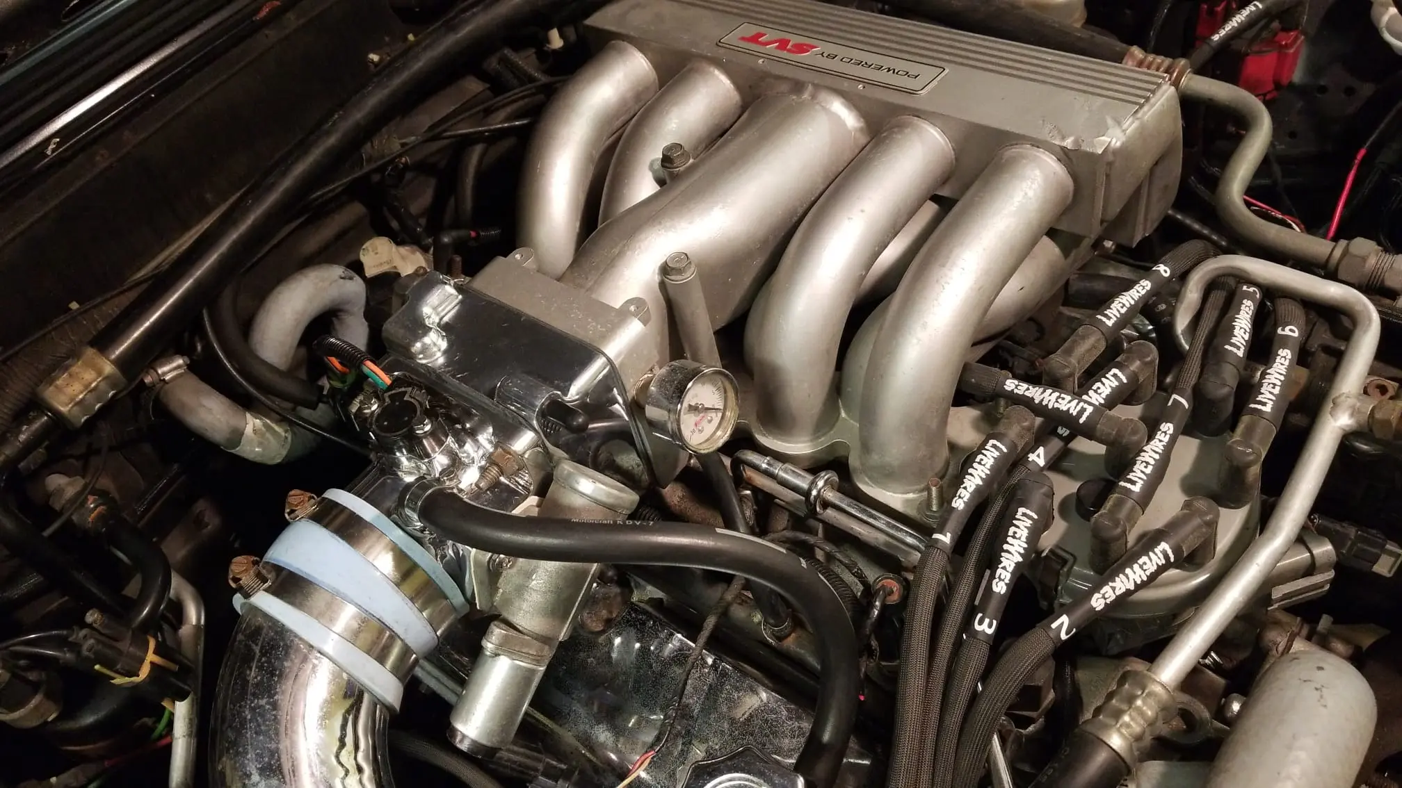

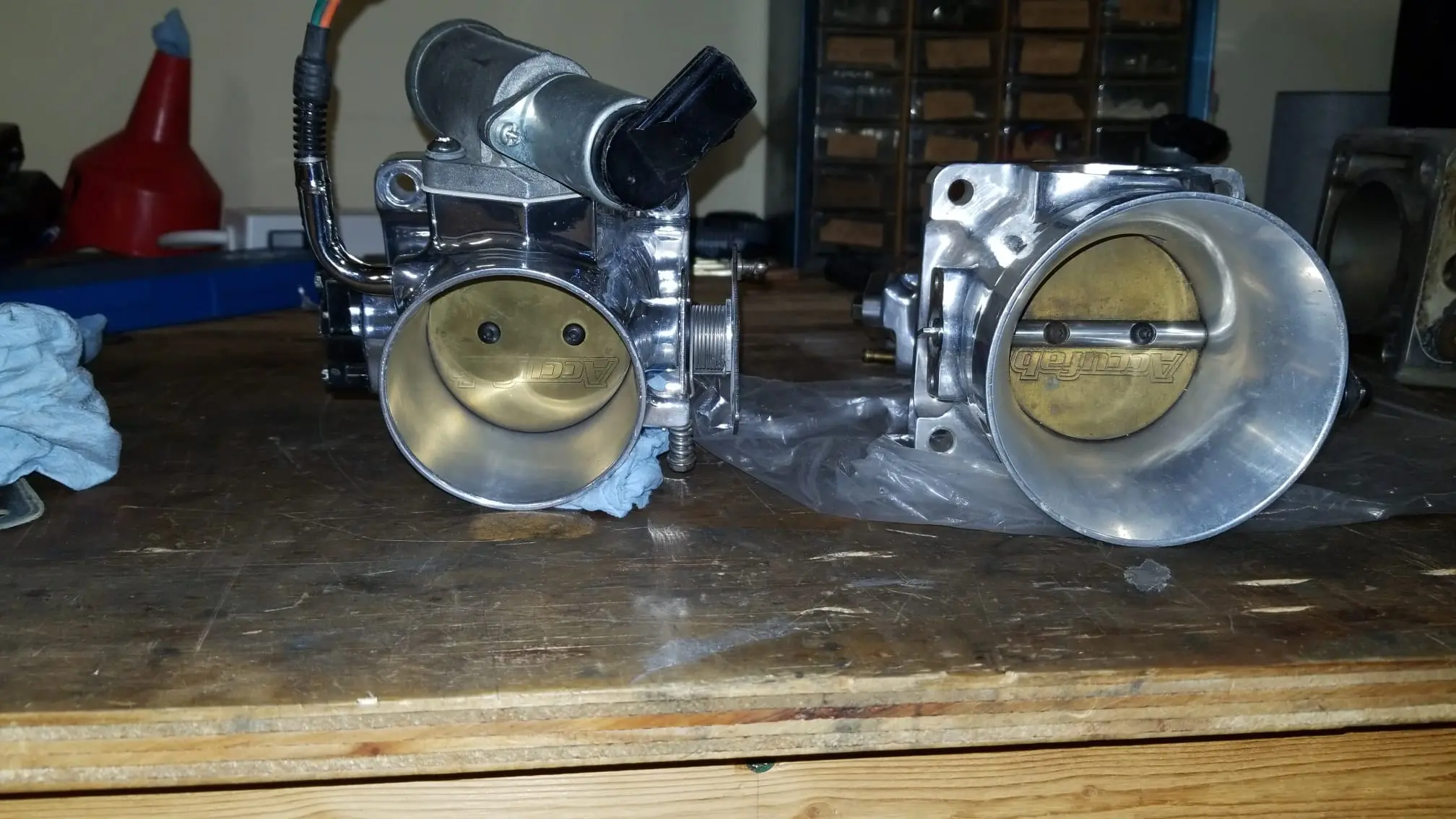

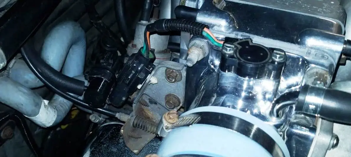

New Accufab Throttle Body:
Goodbye, BBK TB. You whistle better than me, but your services will no longer be required.
Swapped a polished (too pretty for Black Jack) Accufab 70mm TB that I picked up for $210 in its place, tonight. The whistle at idle is gone! Unfortunately, it's been replaced by a much worse whistle at about 1/4 throttle. After some quick looking, I think it may be either of the following: 1. improper port-matching with the gaskets, 2. need to smooth the IAC port & perhaps TB blade, though whistling from an Accufab was not supposed to happen.
Could be either issue. I didn't closely check the gasket alignment when I put everything together, & perhaps the gasket shifted into the air stream. I'll pull it apart and check it in the next couple of days. However, 2 is still possible. I noticed when inspecting the TB that the IAC port into the TB has sharp edges and that the blade is roughly in its path at what I'd guess is around 1/4 throttle.

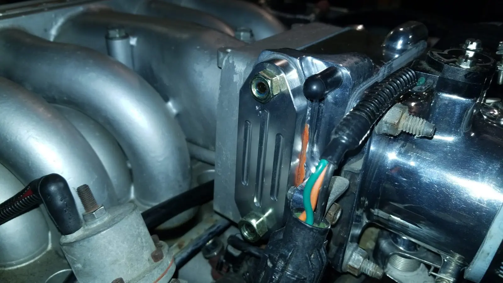

After pic:
EGR Delete
I pulled the EGR valve out while I was at it & replaced it with a blocking plate. I didn't like the look at the dirty intake plenum, and I want to clean up the engine bay over there, a bit. I plugged it back in for now & zip tied it behind the upper intake/head on the passenger side. Ultimately, based on a diagram provided in another thread, thanks @AeroCoupe, I'll come back to it to ensure the computer knows the EGR is non-functional, while hopefully refraining from giving a CEL.

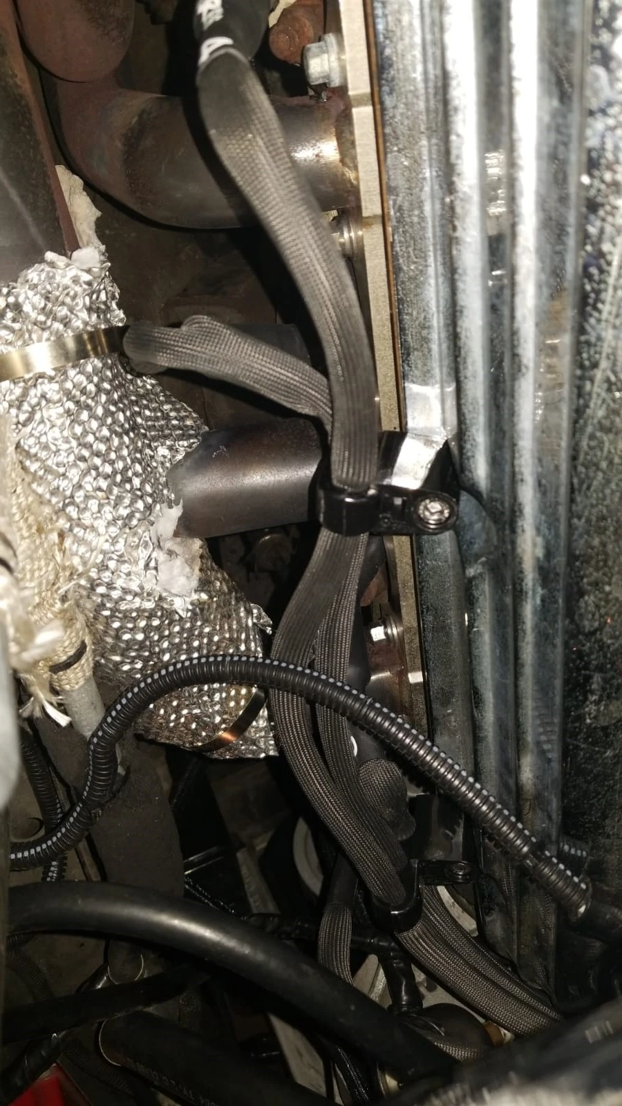

TB spacer/Coolant Line bypass
Finally pulled those hoses off & that rear one was a PITA to scrape off with the little room I had to work with. I ran a new hose, bypassing the EGR spacer completely & it looks a little cleaner in that area, now.
Other Notes:
The TPS settled very nicely in at .95 volts. I tweaked the idle RPM a bit, but 900 on the gauge (who knows how accurate...) is what the car liked. I could get it down to ~750-800 but it would start to surge. At first I took a quick cruise and liked it, but then back to surging & even stalled the engine when I turned on the A/C. First rule of tuning: give the car what it likes! Now, other than the whistling sound, the car is running like a top.
I'm still holding onto the accufab race 70mm TB & may install it one day. It doesn't work with the BBK/MAC intake tract on the car & I don't care to spend hundreds on an aftermarket one, though I might fab up something that will work eventually. In any case, I took the opportunity to nab a pic of them side-by-side:
Notably, the race TB does not have a crankcase vent tube. Also, you can see how it has more of a chamfered, funnel from a 90mm port down to the 70mm blade. This is kinda useless behind my 75mm bullet MAF, though I might still try it out.

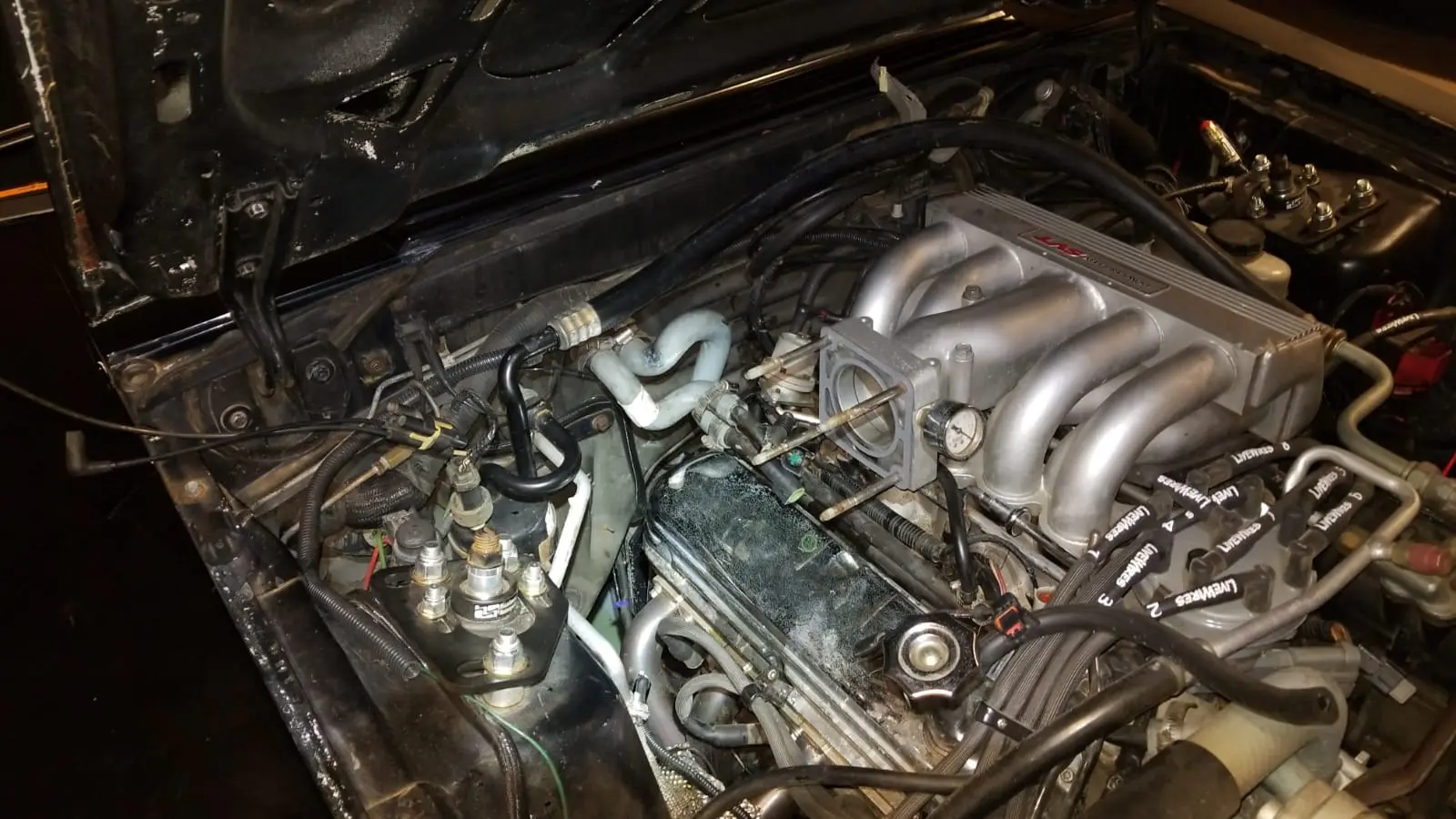

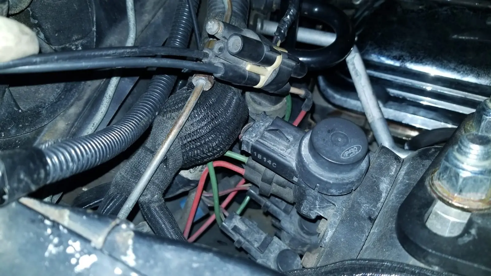

Cleaning the passenger corner of the bay:
Alright, it's been a while since I've taken this on, but is it as simple as just removing the TAB, TAD, and EGR controller? I have no smog pump, no cats, no EGR ports/tubes in the GT40X cylinder heads, which are plugged. Now, that I've removed the EGR Valve & its dedicated vacuum line from the intake vacuum port, which is capped, can I just remove these 3 gizmos attached to the strut tower? The vaccuum diagram (thanks @jrichker) seems to show me that I need to ensure vacuum runs from the check valve to a splitter that includes the reservoir & HVAC controls. Other than that, seems like I can remove all other vacuum lines without issue.
On the electrical side, it looks like (thanks, @Mustang5L5) the only thing I need to worry about is the proper EGR resistor. The TAB & TAD will apparently kick a code or two, but won't trip the CEL... fine by me.
Am I missing anything? Cleaning up this side of the engine bay will make room for my adjustable brake prop valve, which should be coming up soon.

TAD/TAB kick harmless codes. You can install some resisors if you don't want them. That's how i did it.

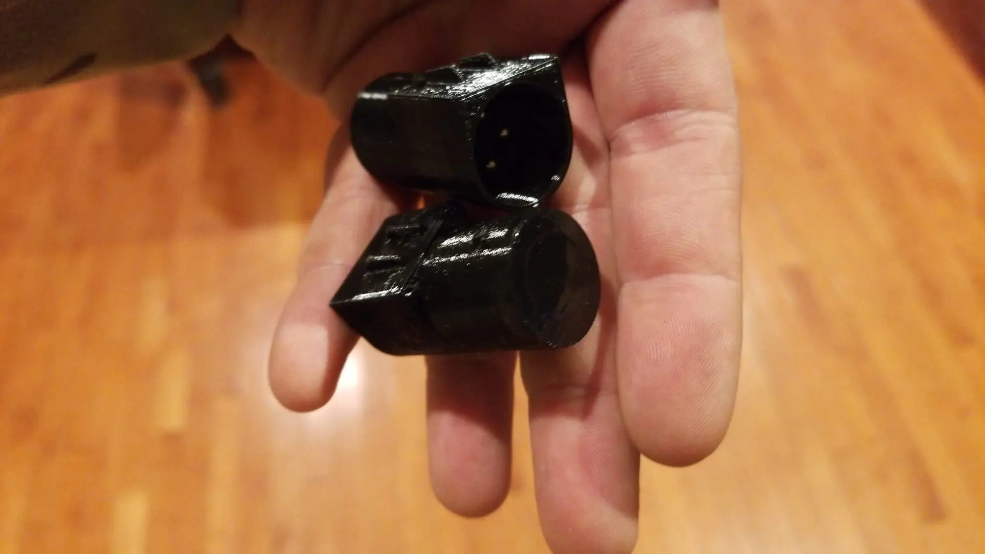

EGR eliminator plugs arrived: I'll report back on whether they trip the CEL. Look cheaply 3D printed. Will keep an eye on them to make sure it doesn't melt, but I think it'll be fine. Bought 2. I'm sure this won't be the last time I need one & I don't know if we'll keep finding them on the market.
Looks nice without the EGR hanging off the back, and I'll probably tuck it away and leave it connected, even after what's coming next... Looks better plugged in than having an empty plug.

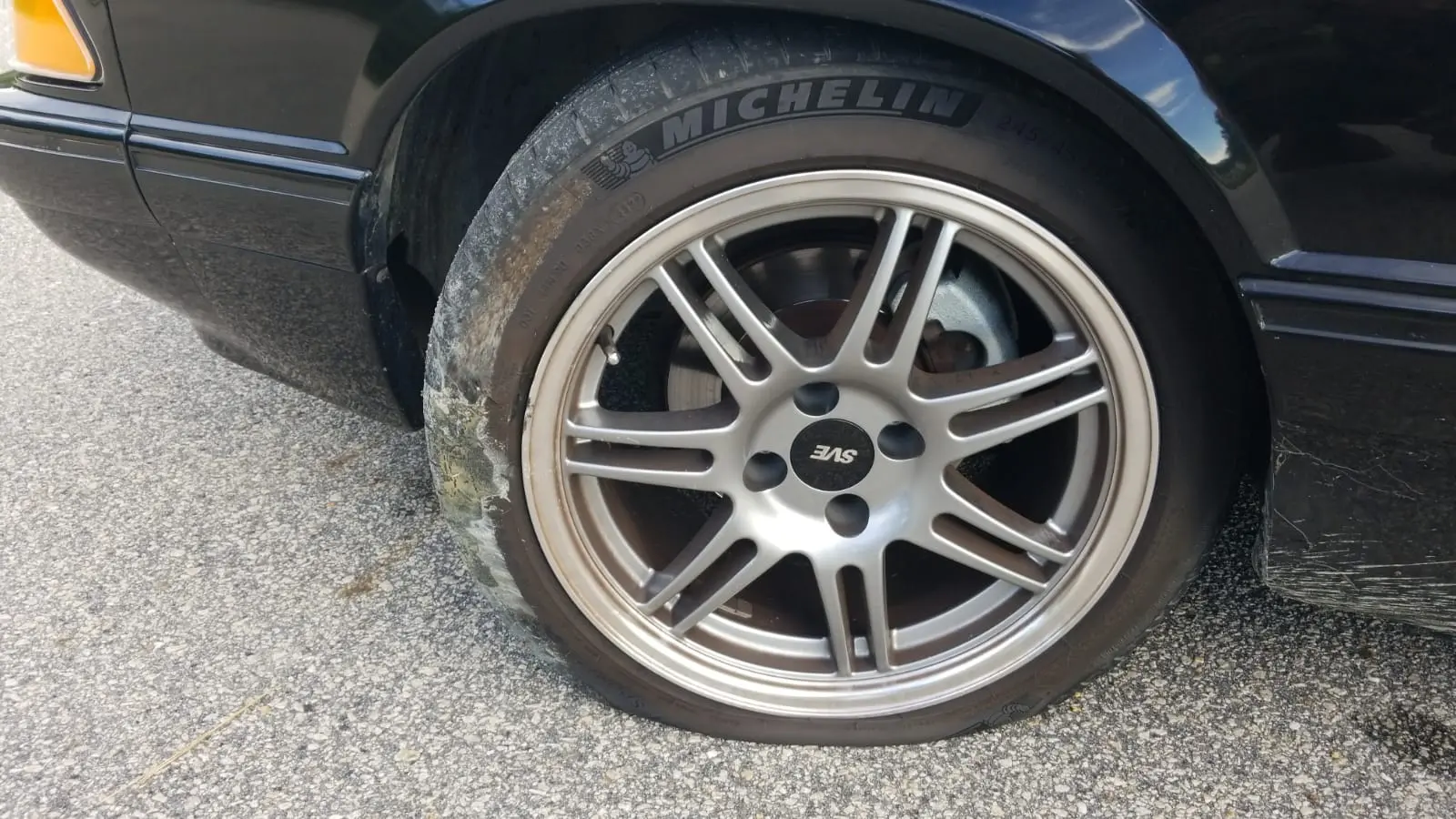

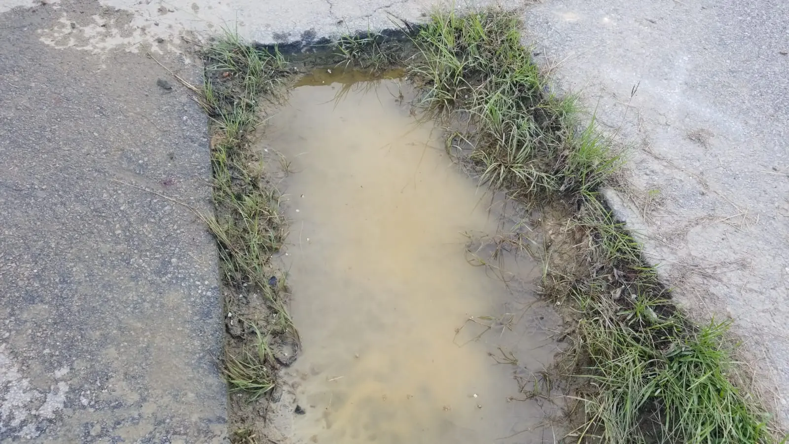

Friday wasn't the most pleasant of car days...
Was on the way home from work, wanted to swing by the military clothing store and decided to take some back roads on post and try to work my way over to the store. It didn't go so well, and I was just about to use that parking lot to turn around when:
It completely caught me by surprise. I took that first pic from full standing height @ 6'4", and because of a little hill and drop, I just couldn't see the pot hole as I approached. Fortunately, it seems like the tire did a pretty good job protecting the wheel and most of what looks like damage to the wheel in the above pic is really just the rubber of the tire that stayed on the wheel when it got pinched. When I go to 5 lug, the new wheels in the garage are going on, anyways. So, I probably just hurt the resale on these by $100-200.
On the bright side, it looks like tire rack's road hazard warranty is going to cover the tire replacement. The tire's already enroute and should be here Wednesday.

Ooh . Contact the city and see if they’ll cover the damage from the pothole if that ever happens again. Had a friend who had two wheels replaced on his truck when it hit a pothole, all covered by the city.

I'll look into it, but I doubt an Army installation is going to pay up.

What kind of rando pothole is that?

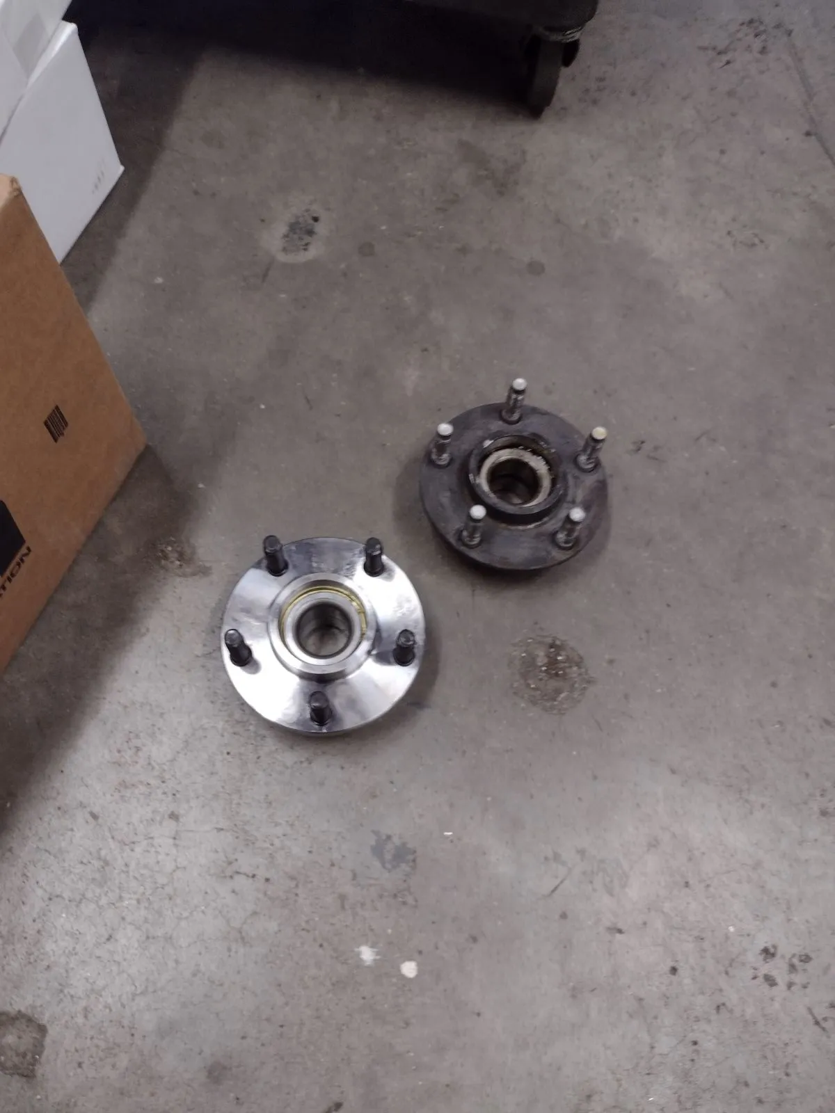

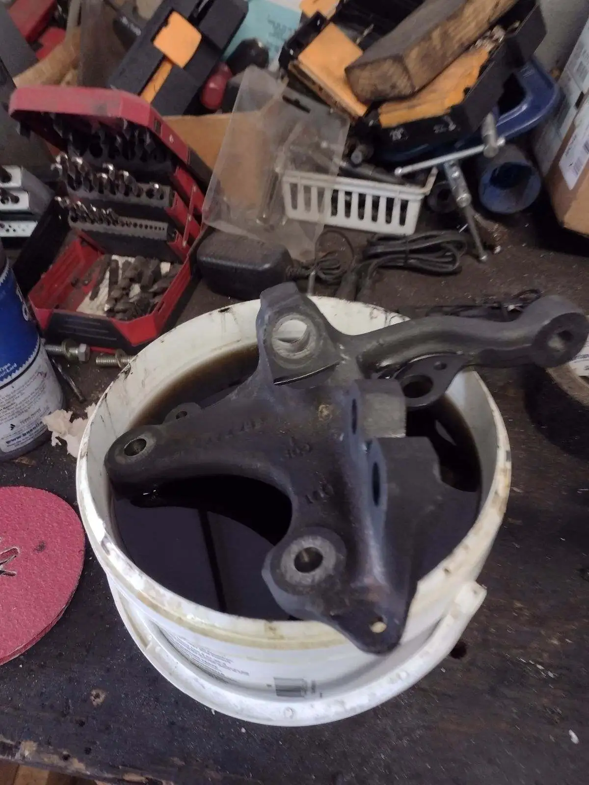

A gallon of evaporust worked its magic.
New shiny hubs:

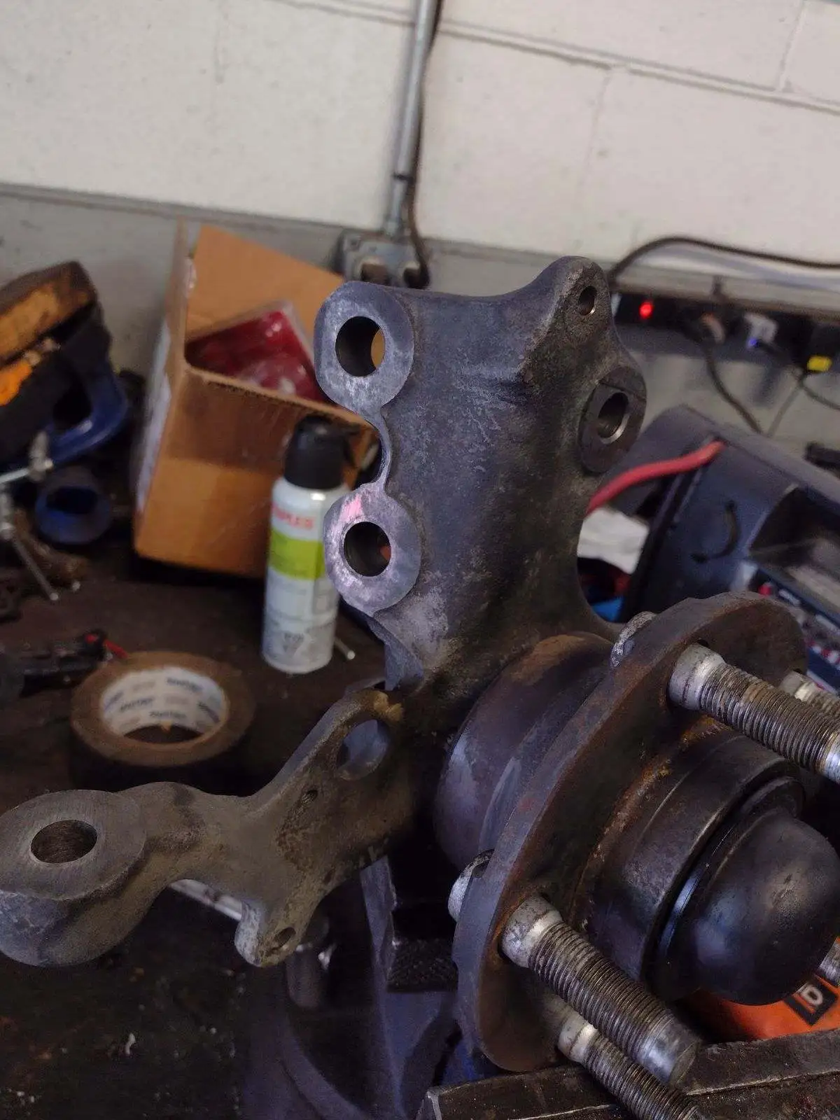

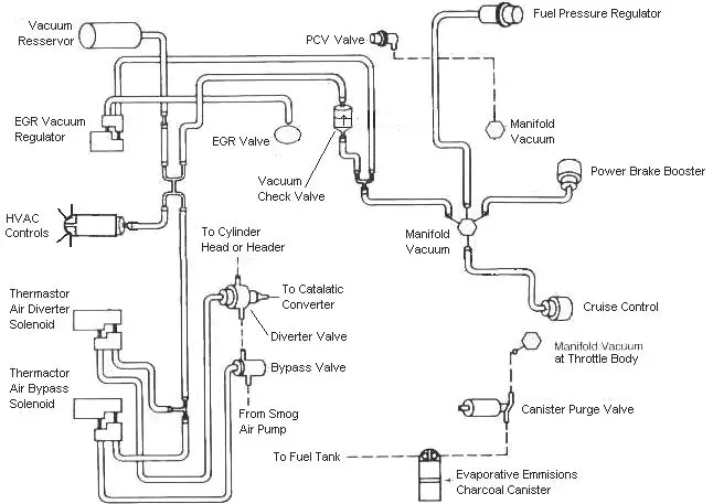

Just finished up the Cobra brakes, and the pull to the left on initial braking and pull to the right while letting off is gone! The pedal is nicely firm & responsive for normal driving. But, even after bedding the pads & adjusting the prop valve for correct front/rear bias, it takes a ton of pedal effort to get to the braking threshold before lockup... It's too much! My leg would be exhausted on a track day. I think I'll check vacuum & if that looks fine, then I'll convert to the 94 Cobra MC, even with the 93 Cobra booster.
Please help with cruise control:
Biggest problem is the Cruise control no longer works. I've tested continuity in the wiring from the trans through the Dakota converter & back to the point it goes into the wiring harness and everything checks out. Fuses are all good. I noticed the brake lights are just a hair from triggering. Is it possible that the brake switch/signal to turn off the cruise control activates before the brake lights would turn on? Can I pull a fuse or something to eliminate the brake switch from signaling the cruise control to turn off?

I'm glad the brakes are better for you now, but I can't say on the cruise control as mine never worked and I never cared. Does the cruise need a vacuum source to work? I feel like it does but don't recall.
Yes it does need vacuum
That's where I would start looking then, those are easy to miss and a PITA to troubleshoot... do you have a smoke machine for it?

I do not have a smoke machine.
