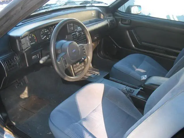

I could get pics of my dyed pieces. I redid the 1/4 panels (the parts have been sitting for a year and I cleaned and needed to re apply the dye.) and will be redying everything with a coat or two to make them look uniform before going in.

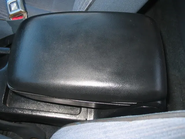

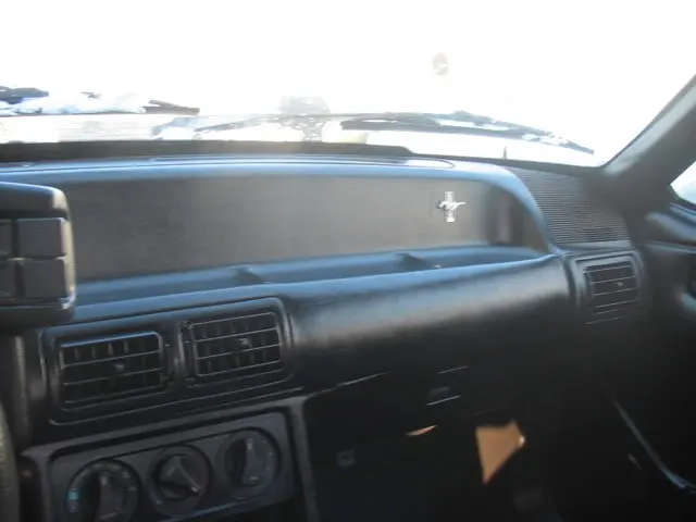

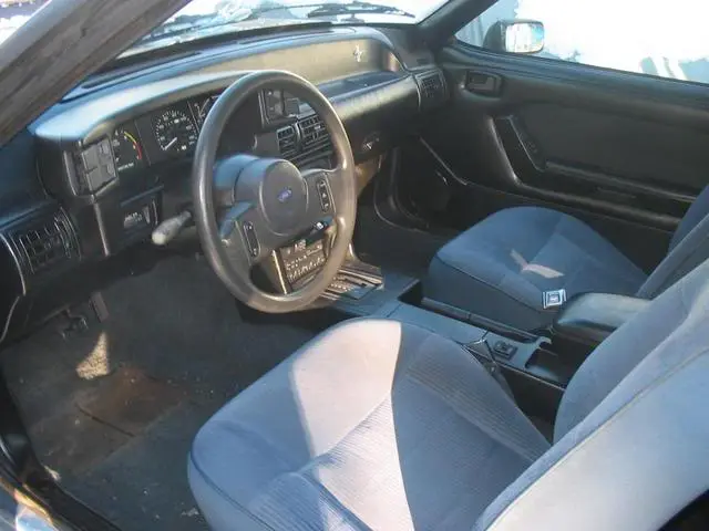

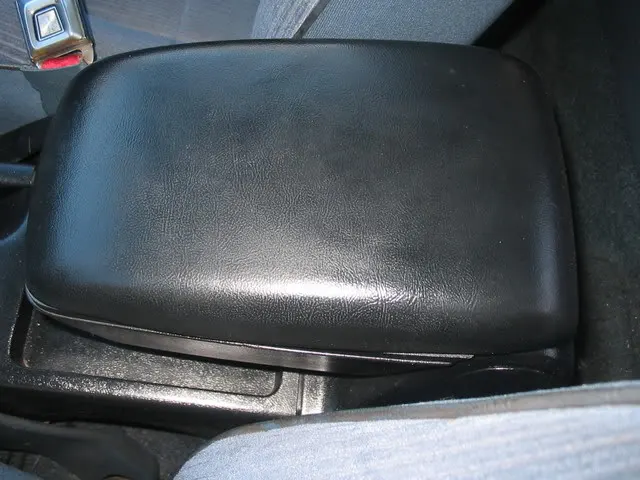

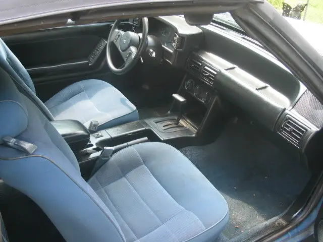

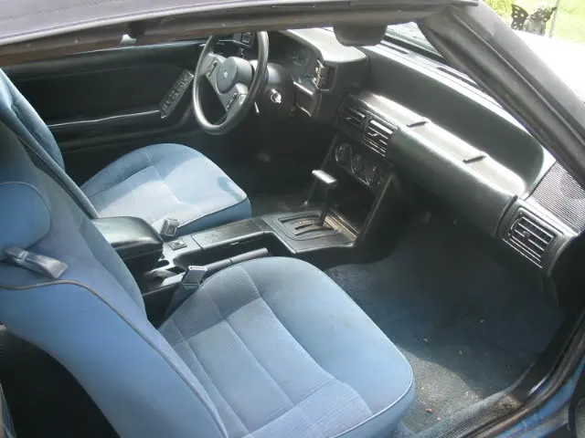

its been close to 6 months since i dyed my interior and i figured i would post some pics of what it looks like now to show you how it has been holding up...its been driven about 400 miles since it was done and is still holding up great. the only areas i have a problem with is the door sills becasue of peoples feet draging over them.
i still havent done carpet or seats because i cant decided weather i want black seats, grey carpet and then a few grey inserts on the door panles. or to do grey carpet, black seats, and then a few inserts or just go all black, choices choices. ive gone a complet different direction with the car since i bought it so the paint color will not be original, the idea of keeping the car looking like it did when it came from ford in 88 kinda went out the window after about 2 days of ownership.
anywhere here are some pics.

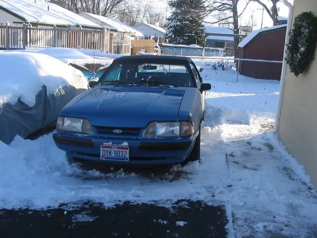

5 inchs of snow sucks btw.
figure ill add a before shot too!
if done right you can have a black interior for very cheap!
cant tell me the tuff stuff...$6
5 cans of paint/dye............$30
wasent worth it for the change it made....i love it.

Trust me, you might not come on and admit it, but it will wear...
Like said before, 3000+ miles easily on mine, and there is red that came through in a couple places, it scratched in a place or two etc. It looks good and touches up easily, but the wear is why I plan to actually do a real black interior!

i have. like i said the only pieces i have problems with is the door sills...nonthing else so far...the dash its not like its getting rested on so its perfect. same with most of the other peices...

nope door panels and armrest havent had any promblems from, mine stuck well was done when the temp was around 90* though.

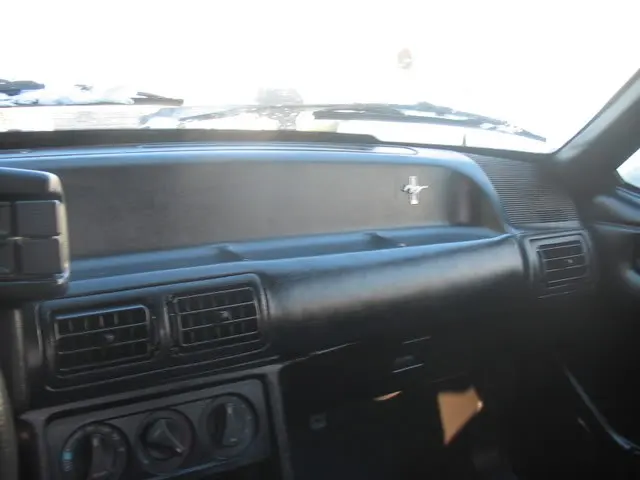

They do have the pony that is blank and doesn't say 25 years
I could care less. Here's my '88 with a 1990GT OEM black interior in it. Right on the dash...a "25 years" emblem. Nobody ever reads the thing :shrug:

after see your pic i think im going all black!
Well Ryan when you really start driving the car and it sees conditions like rain, 150-200 mile trips (or 800 in my case) it will start getting thing. I did all the prep, sprayed them in the right temp, and even recoated before anything ever went in. The arm rest on the drivers door wore through, I resprayed it, and it wore through once again. Part of the center console got scratched and the red shows through, and the sill plates as well.
Also only the 89 and 90 dashes with the pony logo say 25th, the 91 and later ones dont have a 25 on them.

it saw a 175 mile trip last weekend...its been driven daily since the 1st of this month...still holding...400 miles strong so far...we will see...
