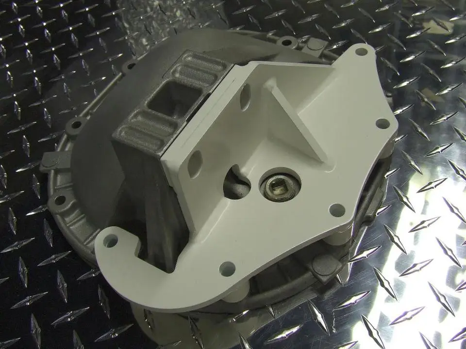

You won't have to drop the housing out completely, but you may need to pull the exhaust out of the way. I HIGHLY suggest that if you are going to remove and reseal the diff cover that you also purchase an aftermarket diff cover brace. This will spread out the torque applied to the diff housing and prevent future leaks. You can get one here:
IRS Brace

Mode03cobra - You'll be sorry for not adding that torque brace I recommended... I'm betting within a year or so and depending on how hard you drive the car, you'll be replacing that diff seal again.
