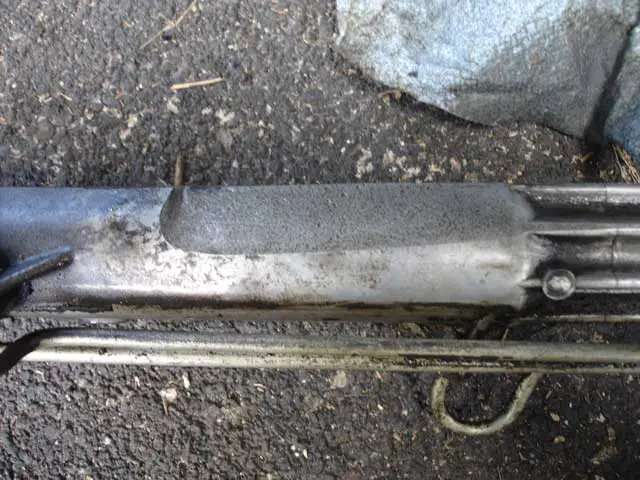

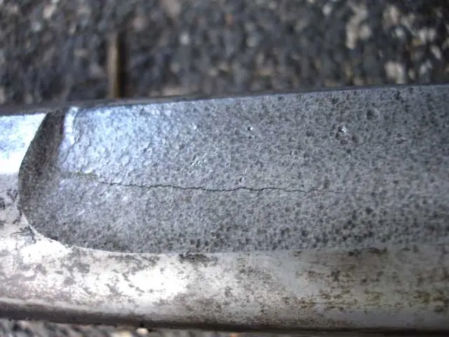

Woah guys, I was pulling out of my driveway today and as soon as I went full left wheel, the steering wheel bounced back and I heard a "SNAP", looked under the car and power steering fluid was pouring out of the rack! Upon closer inspection, it looks as though the steering rack exploded out the back, right underneath the oil pan on the backside of that line that goes into the center.
Anyone ever heard of this before? This is the first time I've seen one completely blow out of the casting! Yikes!
Wow, I have never actually seen the rack assembly or rack gear housing come apart. That is very unusual. Though, it is not uncomon for the inner rack seal and/or the plastic piston seal to give way on these.
Could it have been one of the transfer tubes?
Pictures are worth a thousand words.:)

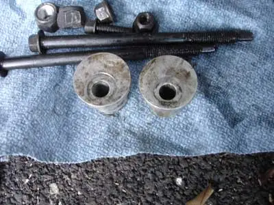

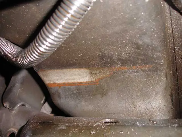

Alright so here's the pictures, looks like the passenger side motor mount is getting weak so with the torque of the motor it's rubbing on the oil pan, the offset rack mount bushings push it up just far enough to where it makes this possible, I got a set of new Energy Suspension motor mounts sitting right here, guess it's a good time to put them in :) Wanted to wait to get my LT headers but guess that just not possible, safety before performance!

AHah, yeh well I guess that full left turn (when the pressure goes all to the right of the rack), is the straw that broke the camels back ya know? Definitely a good thing it didn't wear through the pan, actually I took a good look at it just to make sure, but it's a steel pan and the rack is aluminum so thank the heavens for chemistry! You know these offset rack mount bushings don't even really make that big of a difference I don't think, and I have the bumpsteer kit, so maybe I can just go back to a set of polyurethane's while I do my motor mounts..
Yeh, I got the bumpsteer kit already, and I can re-shim it to where I don't need the rack mount bushings, I think I'll reuse them anyways though, I got brand new polyurethane Energy Suspension motor mounts so that'll raise the motor a bit and they'll last a hell of a lot longer..

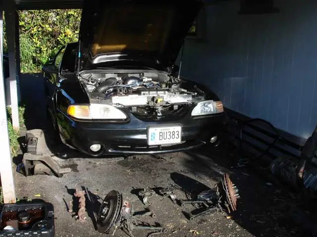

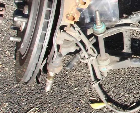

Oh, by the way, I took the entire subframe out of the car today, just felt it would be easier to do the motor mounts this way, and then while I was at it, I decided to just go with longtubes, so the exhaust is off, just waiting for my LT's to come in, take a gander!
