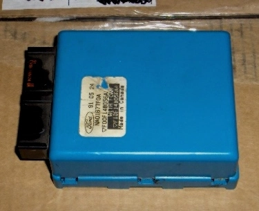

ok...cant check the fuses under dash as the cover is gone..and i have no idea what possiton which is ect...cant find a book that tells me..also did some searching and found ppl talken bout there blinkers not working in relation to a blue box....i found this behind the HVAC controls kinda......is if for the blinkers? if not..what is it?
I believe that blue box is your air bag diagnostic monitor.
