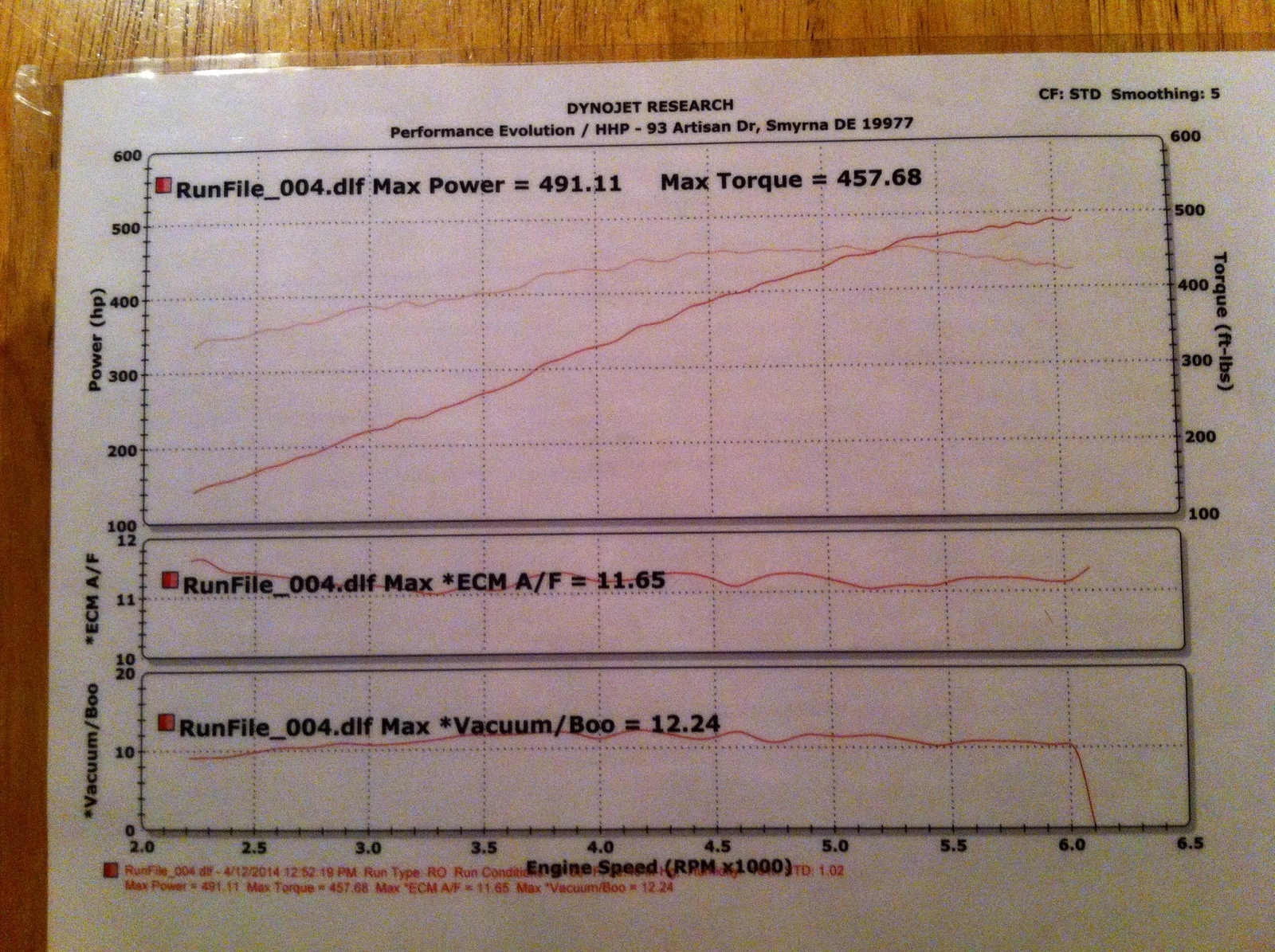

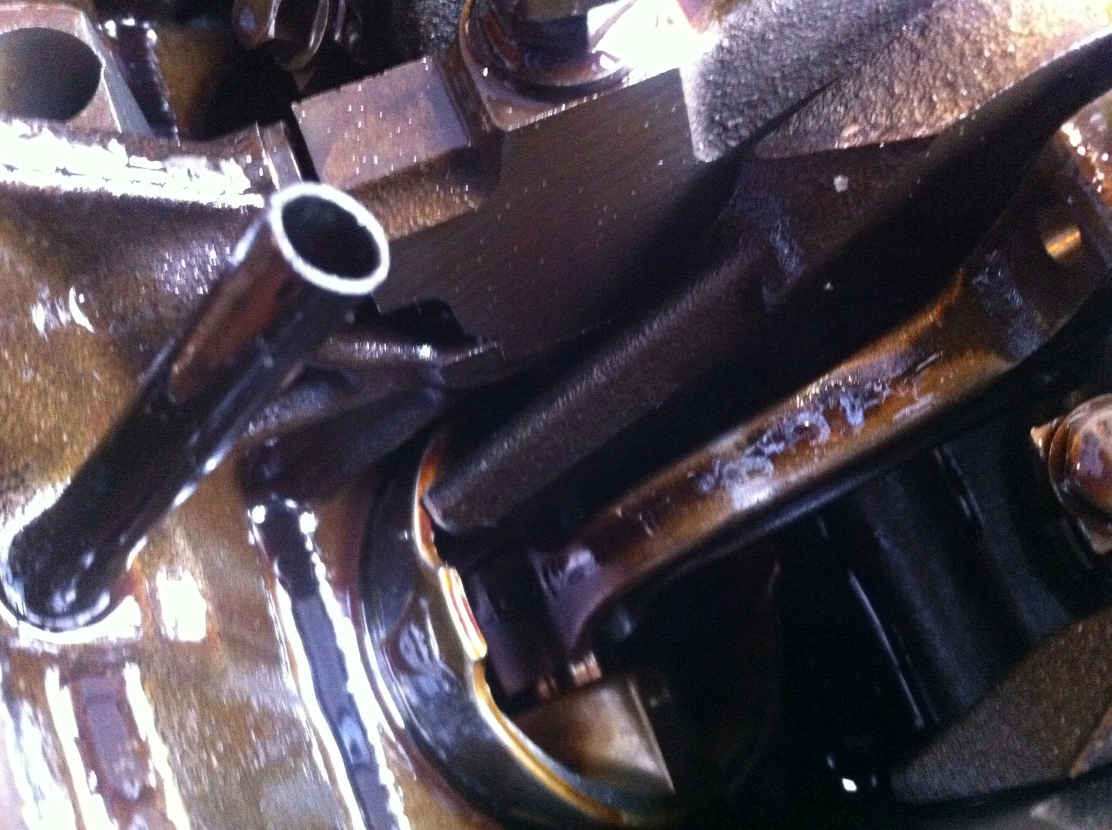

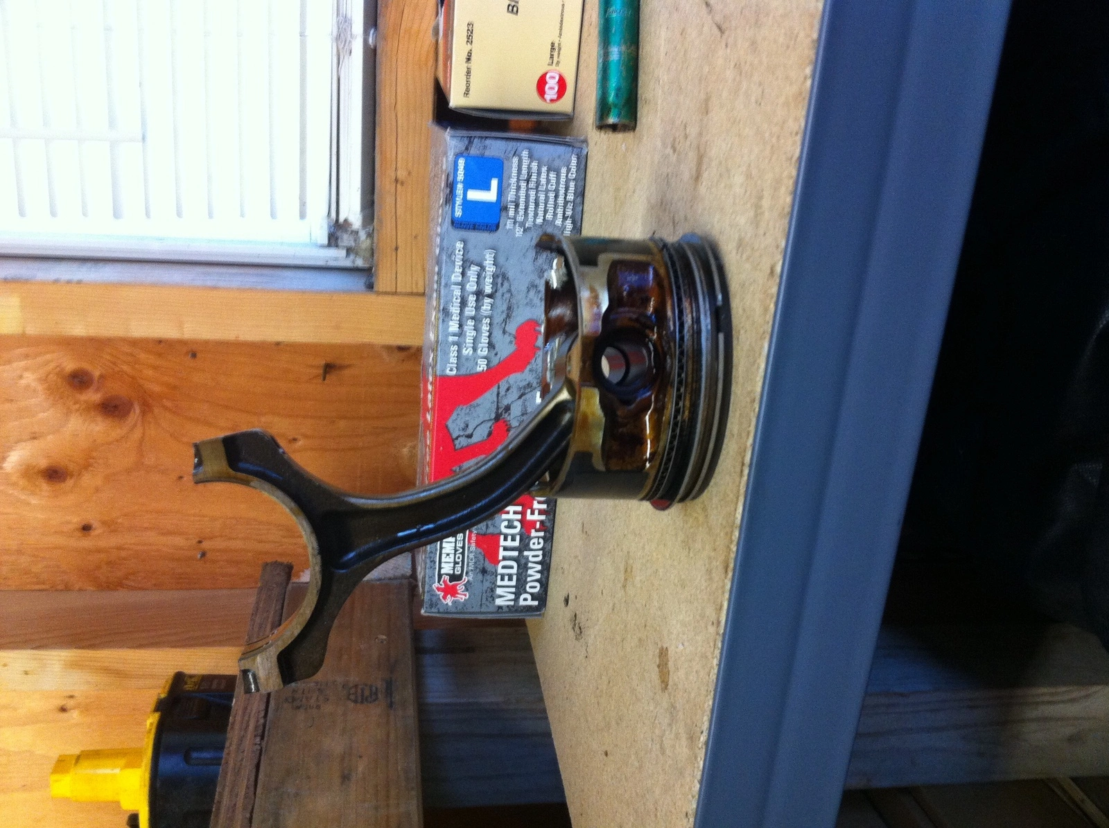

Lbs of boost wouldn't be the concern with forged parts it's hp. Your average manley rods are rated to 750hp......can you make more.....probably.....but plan on $20,000 to make 750hp. If you're gonna go supercharged I have now learned a good set of ported pi heads go a long way. I'm running trick flow heads and cams and literally saw nominal power gains on the dyno for the $3500 it cost. The manual 5 speeds are rated to 350-400 so just like with the rods you can push more I ran 480hp on a stock t3650 before my new build.
And 500hp on a stock bottom is absolutely a no. You might as well light it on fire. 480hp lasted a couple months in my car but I already had a teksid block to install
