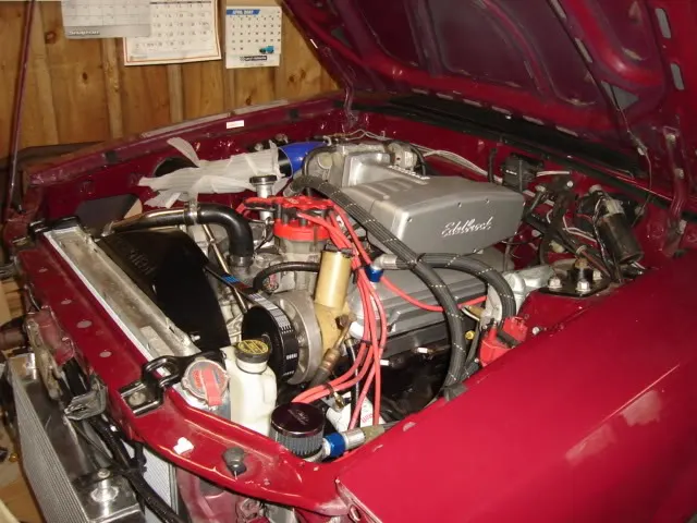

It will not go into the valve cover at all. Just buy the fittings, figure out what would be the most convenient place to mount them on your valve covers, mark, and drill a hole. Bring them to someone with a tig welder and have the fittings welded onto the valve covers. Then run some hose to a catch can with a breather on it. Oh, and obviously do the drilling and welding with the valve covers off the car...
Or if you don't want to weld on your valve covers and have to repaint them, you might be able to try drilling and tapping them and threading the fittings in with some sealant for a cleaner look.
This is a picture of the setup.

I think I'm gonna go with the breather in the end of the filler neck, i know a guy going this route and doesn't have any problems. Right now all it has to breath through is a 1/4 inch pipe fitting with a hose on it, until it pops the pcv valve out that is lol.
if that doesn't work then i'll already have a hole in each valve cover so i can go with the AN fitting and catch can setup

My buddy ran that setup for a little while with the breather in the filler neck. It was ok but it blew oil all over the engine bay every time he beat on it. Then we just came up with the hose setup.
