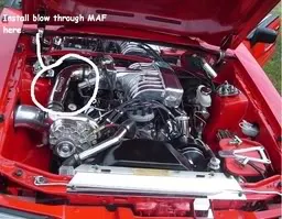

heres what im wondering:
Can I install a blow through MAF there, with out running into problems? If necessary i can wrap it so it doesnt heat up. Im not planning on running an intercooler, although if i do choose to, the SC will remain in that location

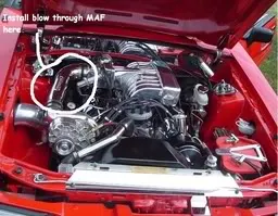

if you want to run a BOV you would HAVE to put the blow through maf there... blow through meaning it can be used with boosted air running through it, a draw through maf does not allow accurate measurements of boosted air... Also, the BOV will need to be on the S/C side of the maf

correct, i know that much, but will it provide accurate readings being so close to the sc and tb?
I am running a blowthrough meter (protube) on my Procharger setup. They are easy to install. PMAS makes one called a protube, you can get it in 3" or 3.5" whichever you need. Just make sure you mention there is an elbow either before or after within 12" of the meter. I am sure you can make it work, but dont cut until you get the meter, they are pretty long, you will only have a little left of the vortech pipe. The only problem i can see is that the air coming from your Vortech is going to be hot, much hotter than an intercooled car, which could definitely hurt the performance of the car. Best of luck with it!
