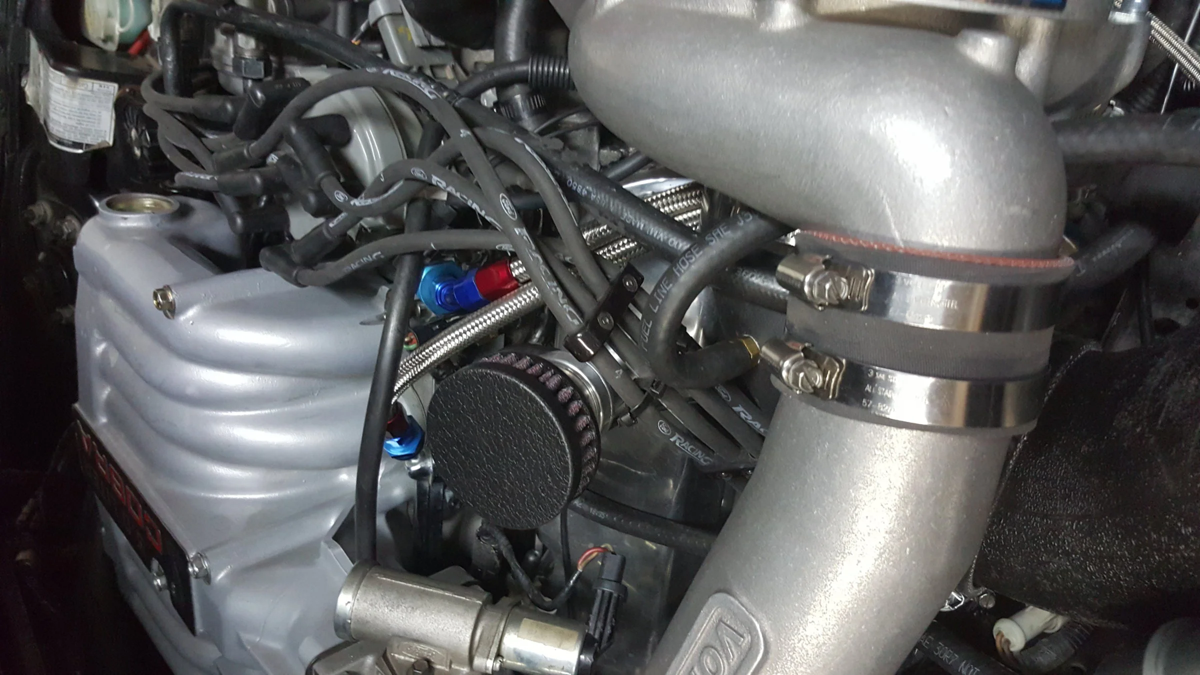

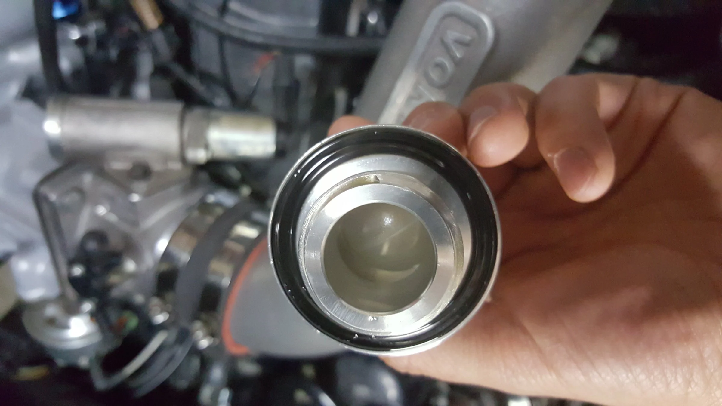

I run a heavy duty check valve between the stock pcv and upper intake . I then run a breather on the vc with a check ball so it does not let in unmetered air during vacuum conditions also let's any blow by out. I also a vaccum line connected between the blower inlet vc tube. No issue with 15 psi.
Good to know. I'm going to try the check valve in line with the PCV and the line from the oil filler neck, to the blower inlet first and see how it holds up. I like the look of the one way valve cover baffle, but I'm worried it's going to interfere with the strut tower brace?
