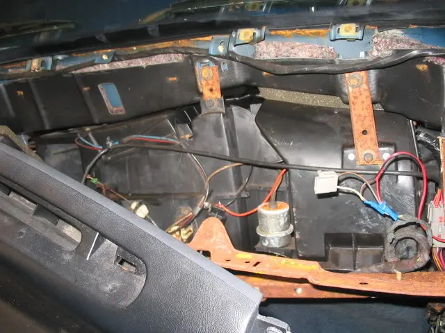

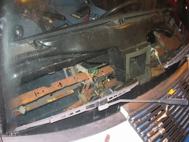

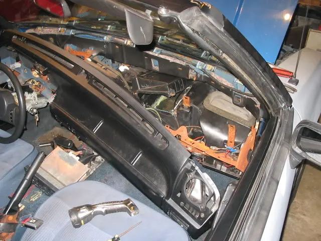

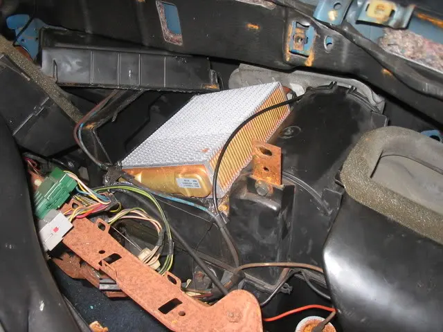

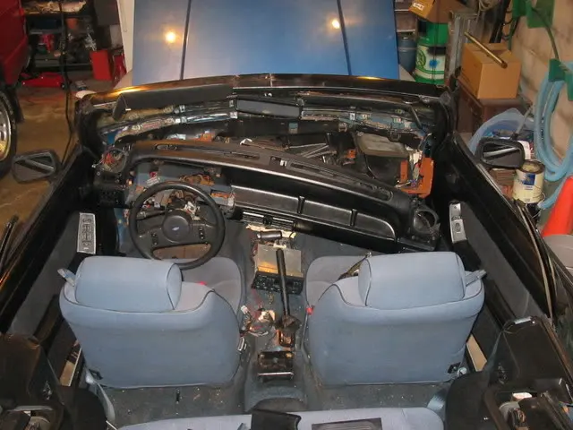

you got to go even farther then pulling the heater core, you have to pull the whole unit out to replace the blower motor...and without pulling the metal dash frame out i dont see you coud get to it.
its a pita to do.
a few pics i took from when i did mine 2 months ago
i followed the write up from musatngs monthly when i did mine, just bag and tag ur bolts, i didnt i just threw them in a metal pan and boy did i regreat that.
good luck getting the dash back onto the metal frame just right...its a pain to do!
