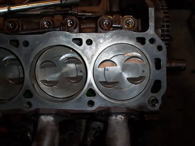

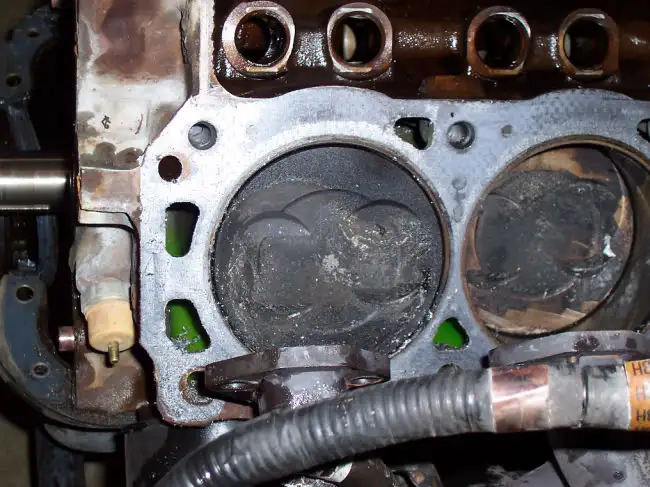

I think that's from your "steam cleaning" of them. I don't think I'd clean it with anything other than maybe a paper towel and make sure you use a vacuum so nothing gets down in by the rings. You don't want to "scuff" the walls at all with anything.
What's the deal with my cylinder walls?
I have never seen them like this the last 3 times I have broke it down? :shrug:
Are they burnt or am I ok and how should I clean it off?
This gasket looks obliterated. :nonono:
Just say no to O rings Rob... they do more harm than good in a situation such as JR's and yours. There is a reason they are blowing, if it doesn't blow there... something else is bound to let go.
Ok the order of this thread is messed up so I don't understand it all. Rusted cylinders means lots of water. Is this what they looked like when you removed the head? In my opinion 3 blown head gaskets in a short period means there is a bigger problem then gaskets.

Yeah they looked like that after I pulled them. It was in there for 4 days before I got them off. I blew the first set with to much boost on the dyno. The 2nd and 3rd ones went w/o a proper tune and too much timing. The 2nd set popped with 20 degrees locked timing and the last set popped with 10 degrees timing and I put the spout in on the way to get it tuned and it detonated and poof.
I ran it w/o the spout and no tune for 3 weeks WOT with no problems and no detonation. They popped I put spout back in about 10 minutes afterwards at the first hit of detonation. :nonono:

Here is pics of mine cylinder walls
Before and after cleaning
