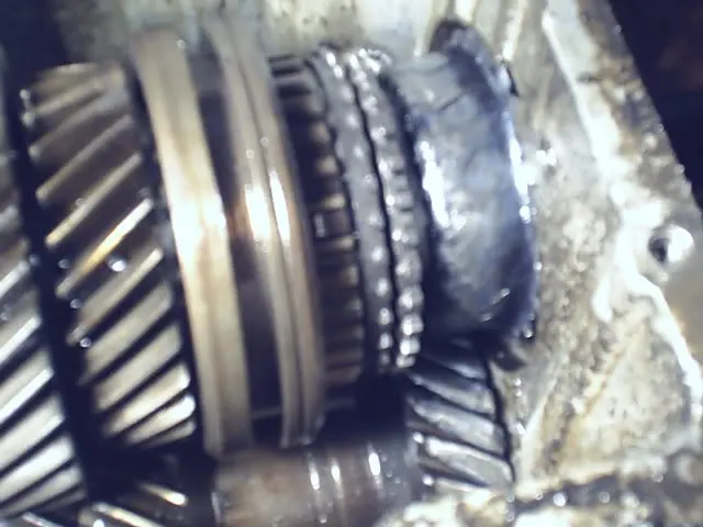

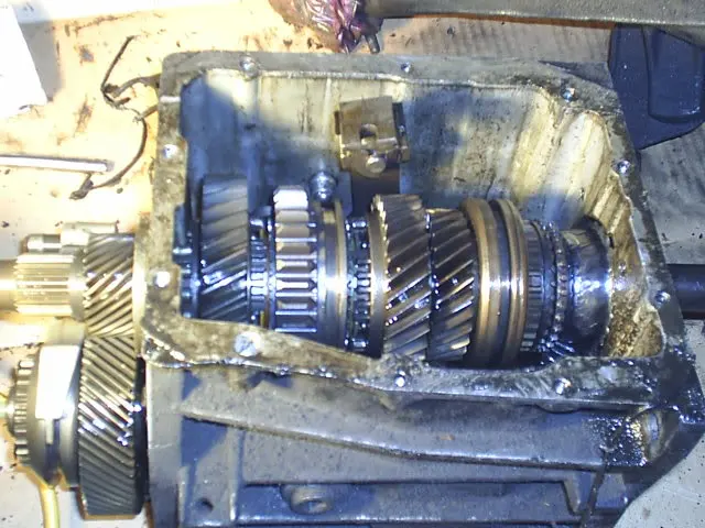

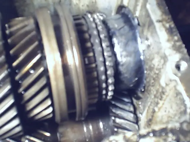

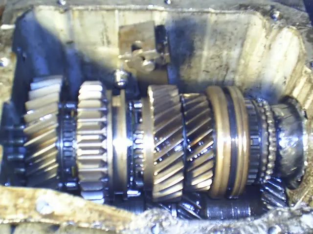

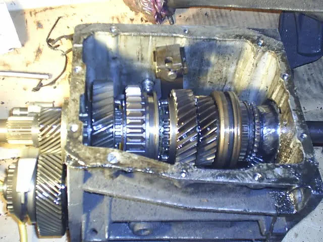

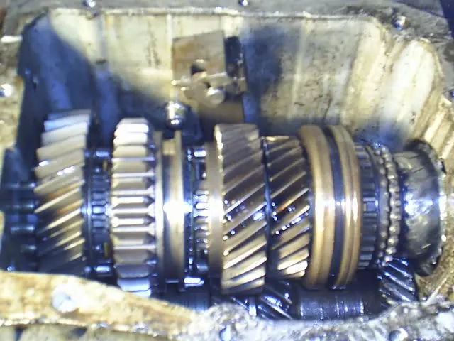

blown my tanny agian
trips52
Mar 2, 2003
172
ocala, fl
just blow all the gears in my tranny except 4th...... damn this one only lasted 8 months...... but i did get it used from a juk yard.... they said it came from a 93 gt 5.0.... but how can you tell....... any how should i get another t5 from world class new have this one rebuilt.... or go to a tremmic TKO..... whats envoved if i go to a Tremmic TKO...
dang man.........i beat the piss outta my t-5 never had a problem with it.........you must be driving it harder than me.......you need to look into TREMEC your gonna spend more money re-placeing the t-5's then just biteing the bullet and geting a tremec......thats what im gonna do when i blow mine when the new motor goes in.
You blew the input shaft...prob tookt he countergear with it.
You are looking at a major rebuild with that trans. Only way it would be worth it is if you get some good used parts cheap and can do the labor yourself

Yup, my T-5 looked just like that pic, the input to counter shaft gear set demoloshied.
