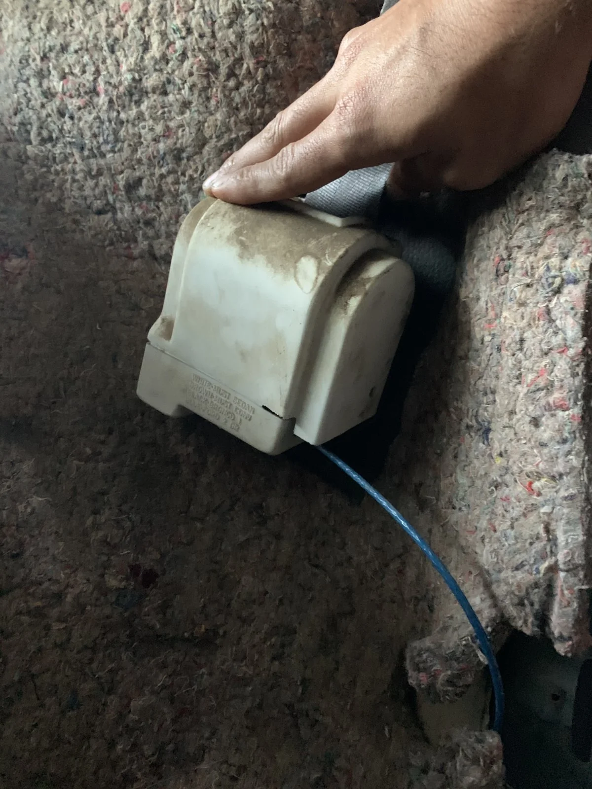

Blue wire connected to Seat belt
I need to replace my seat belt but im not sure how to remove the blue wire connected to the seatbelt without damaging it. Anyone knows how?

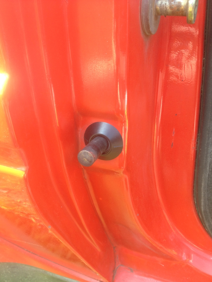

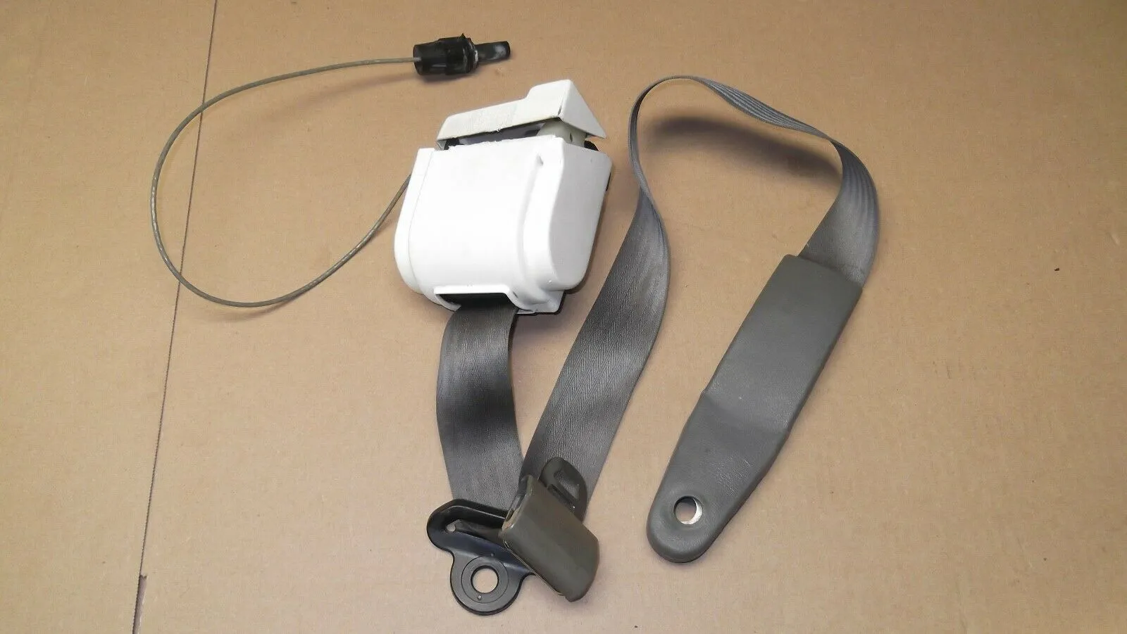

What year car is this? I think that is actually a cable that retracts the seatbelt when the door is closed. It goes to the plunger in the door jamb. You can remove the button/plunger and remove the seatbelt assembly with the cable and the plunger attached. Here is a picture of one out of a car for reference.
