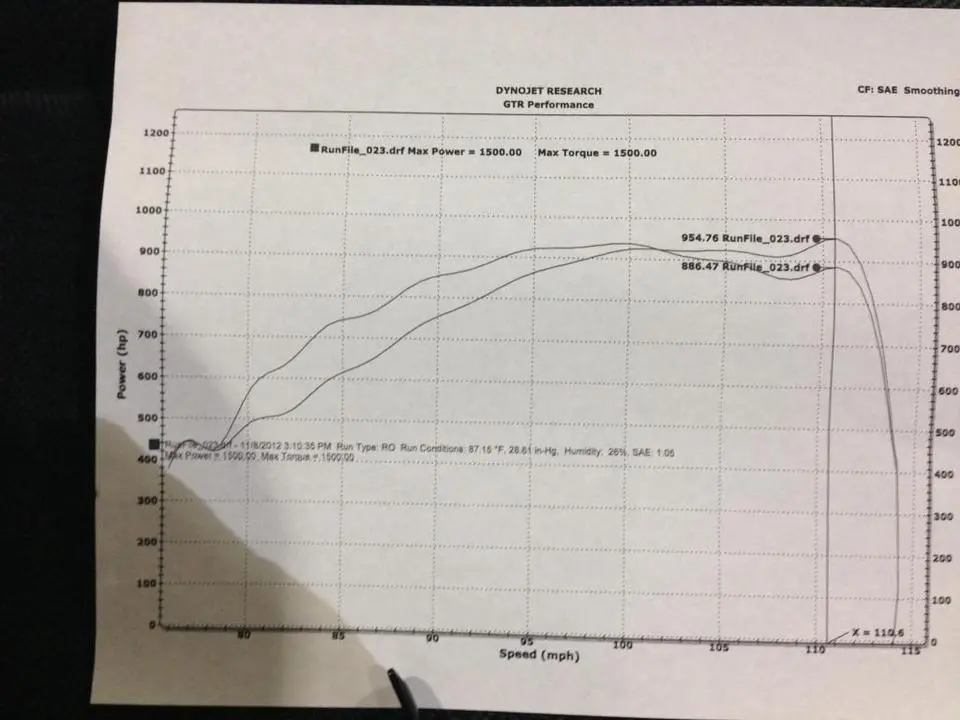

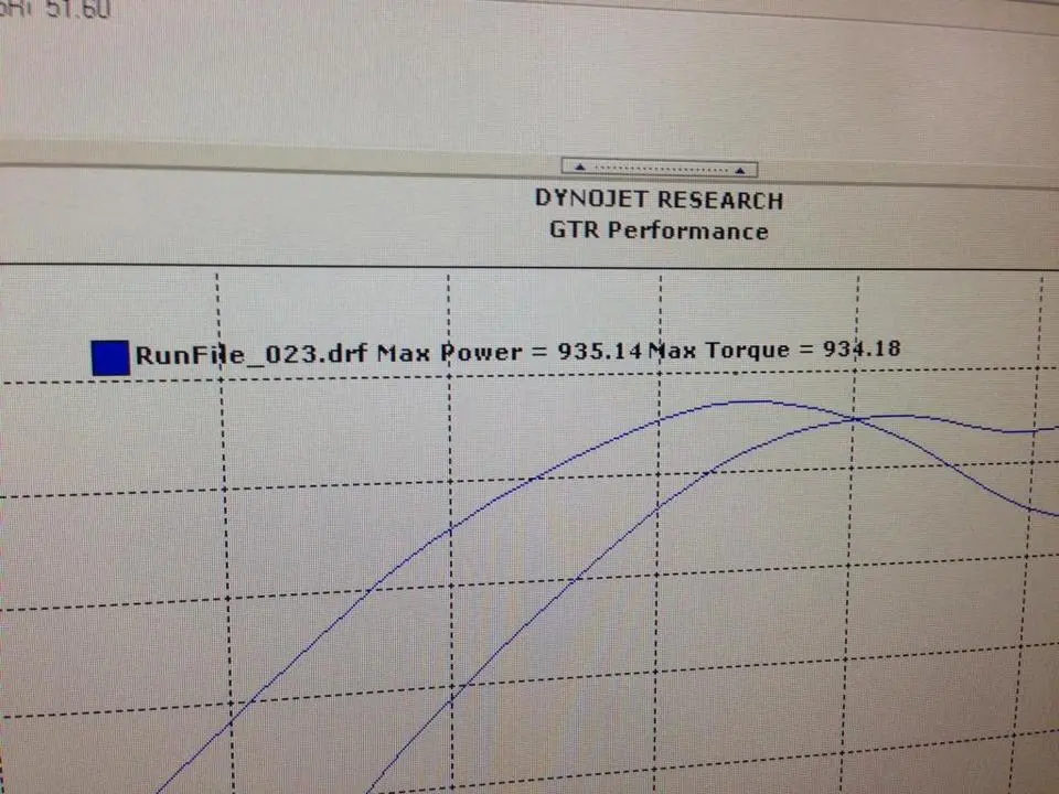

My RNH 363 with a 76GTS (3" down pipe)
made 954 rwhp yesterday at 25.5 psi on E85. That maxed the injectors at 100% DC so Bob dialed out a few numbers on the EBoost 2 controller and we settled in at 920/920 at about 24psi.
The "Big number"
another

Bob is a fan he dialed it in in 2 pulls.
Had a 14-15 psi spring in the gate, Bob added 80 "numbers" (can add 0-100) to increase boost. It overboosted at 26 psi at about 5700 so he dialed it back to 70.
