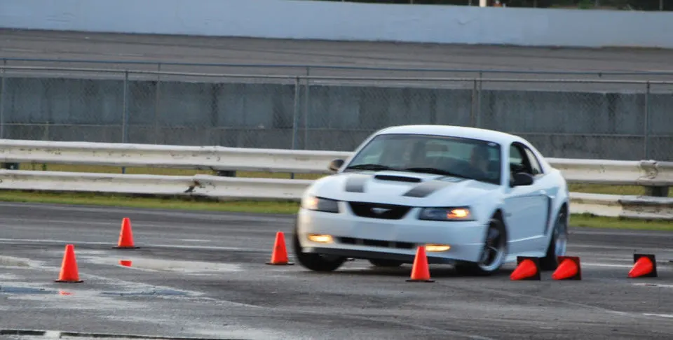

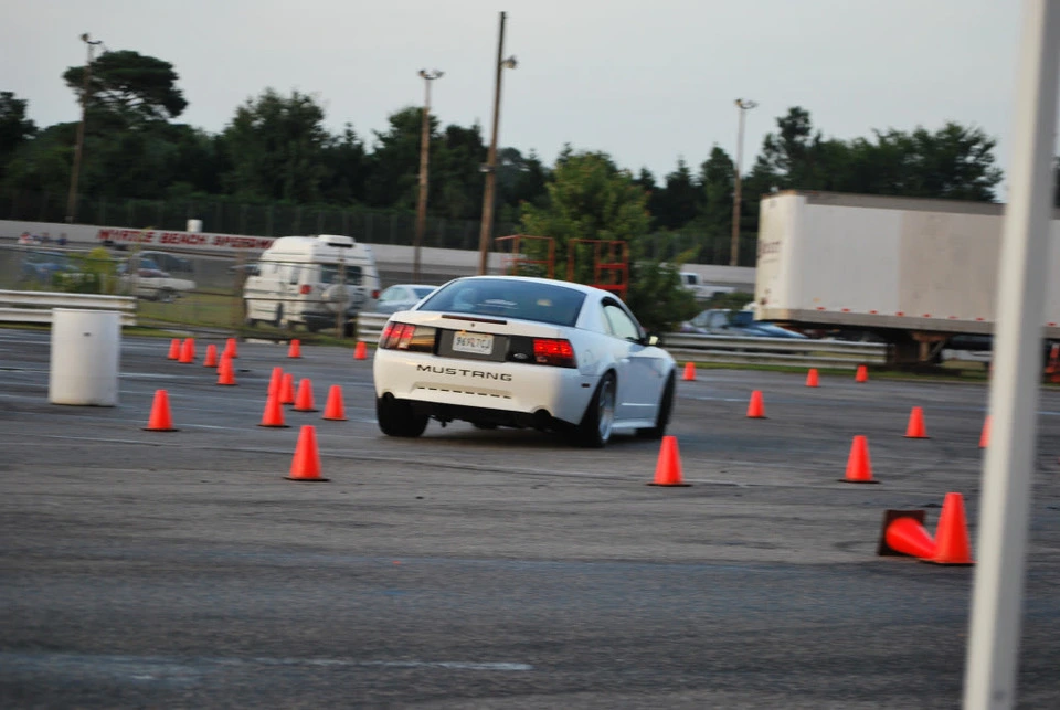

A shot from the autocross at Mustang Week. I didn't know I was driving a truck around the course until I saw these shots...:rlaugh:
Roush springs, J&M adjustable LCA's, Tokico shocks out back, have the front struts waiting to go in as soon as I can bust my old ones off, and Bullitt bolt-on subframe connectors...
I need some different springs and a stiffer swaybar out back. I'd like the front to sit lower but then I'm looking at CC plates, which would probably be a good investment anyway.

That's hardly enough body roll to comment on :cool:
Unless you have wider rear tires and experience understeer when you get on the throttle, a stiffer rear bar won't do anything but make the rear looser and hamper your ability to put power down around a curve. Stiffer springs will only make your car a PITA over every bump and expansion joint and decrease your car's ability to soak up road imperfections without losing traction.
Body roll isn't inherently bad for handling, it is mostly a driver/passenger comfort issue. Stickier tires will increase body roll as the tires can hold the same line at a higher speed. If body roll was inherently detrimental, stickier tires would decrease cornering ability and make for slower lap times.
Here's an image of the body roll on a normal street car, for rational comparison:
http://corvetteidaho.com/hib/assurance/images/553.05.jpg
You can eliminate body roll completely with stiffer springs, but you will also eliminate your suspension's ability to absorb road flaws without upsetting the car. And the last thing you want going around a corner is your car bouncing around. Unless you are bottoming out your shocks going over expansion joints and railroad tracks, your springs are probably stiff enough. And unless you experience understeer whenever you try to get on the gas going around a corner, your rear way bar is fine.
A stiffer sway bar on the rear will make the rear step out sooner when you apply power around a curve. If you have wider rear tires, a stiffer rear bar is a decent idea, but I'd look for one with adjustable end links so you can control how much rear lateral traction you give up to gain front lateral traction. Because a stiffer sway bar will reduce lateral traction at that axle but increase lateral traction at the other. In a FWD car, a stiffer rear bar is a benefit as it allows the you to rotate the car instead of just understeering off the road. In a high-torque RWD Mustang, a stiffer rear bar will enhance the tendency of the rear to step out. It can be a good thing if you have more rubber out back than in front, but it's a bad thing if you aren't having issues getting the front to bite on turn-in.
The goal of "zero body roll" is best left for open wheel race car designers.
IOW, it looks good as it is. Don't buy parts to make your car look better in pictures unless that's your only goal. :nice:

Good God your rear tires look like steam rollers in the first pic!
*EDIT* nevermind, part of the toppled cone looked like part of the tire lol
Hahaha, yeah that cone sure does make them look enormous.
