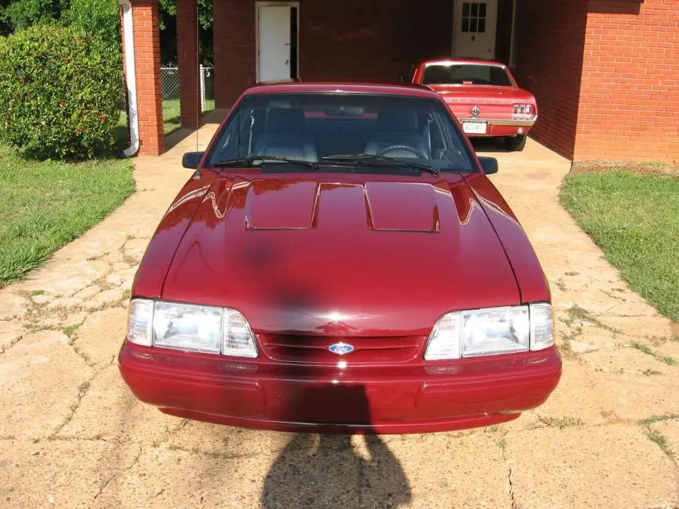

My car was originally Medium Cabernet Red.
I changed my mind, bad color choice.....
I kid, I kid ! :nice:
