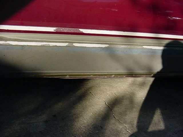

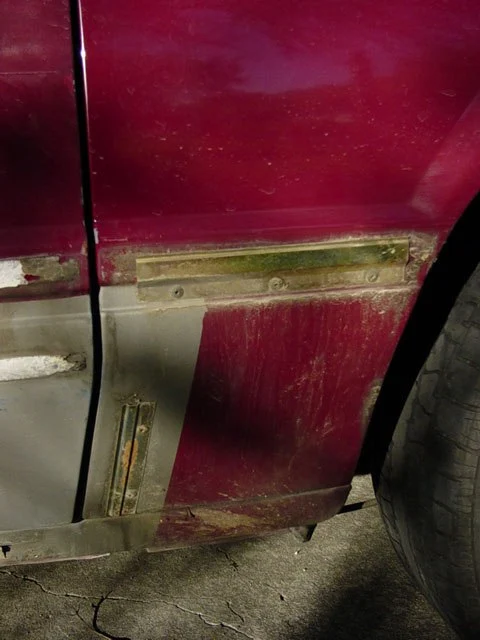

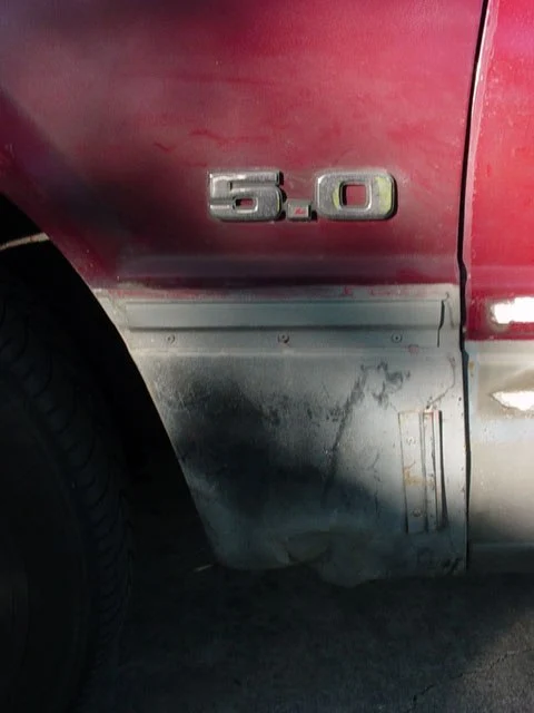

Those zinc brackets were still available at Ford when I ordered a whole new set back in 2005. Mine were rotted....by the way, they are riveted on and easy to install. It is critical to line up the vertical bracket that is on the fenders. It is where the rocker molding hooks to the fender.
