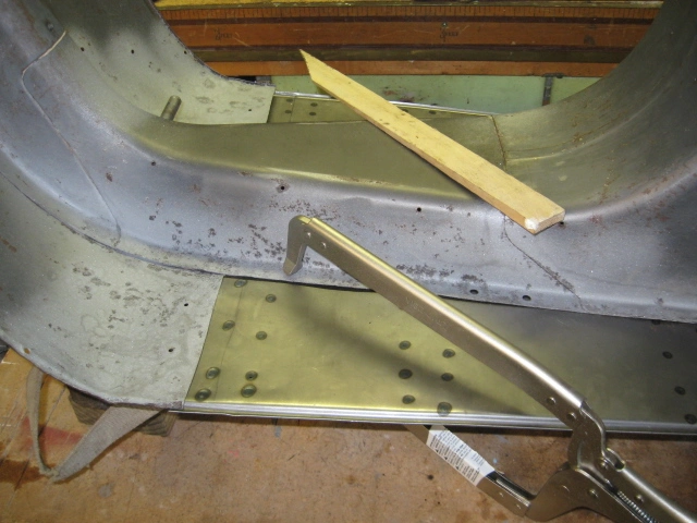

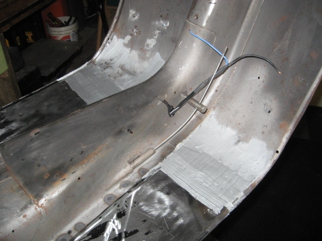

I've had great success with a product called "All Metal". It's a spreadable two part product that hardeneds to a very hard machinable finish. I've used this on any number of spot welds and feathering in lap joints. I like to first shoot bare metal with either an E-coat or the ever popular epoxy primer to seal the bare metal before applying fillers. Although, if the humidity is low, then applying the filler first has worked fine, especially this type filler. I fill the regular "bondo" type fillers tend to absorb moisture. The key is to avoid any moisture between the layers. In the following pics, I replaced a floor in a vintage scoot. The joint between the old and new is a flanged over-laping joint that has been welded , e-coated, then, a first coat of All Metal is applied.
