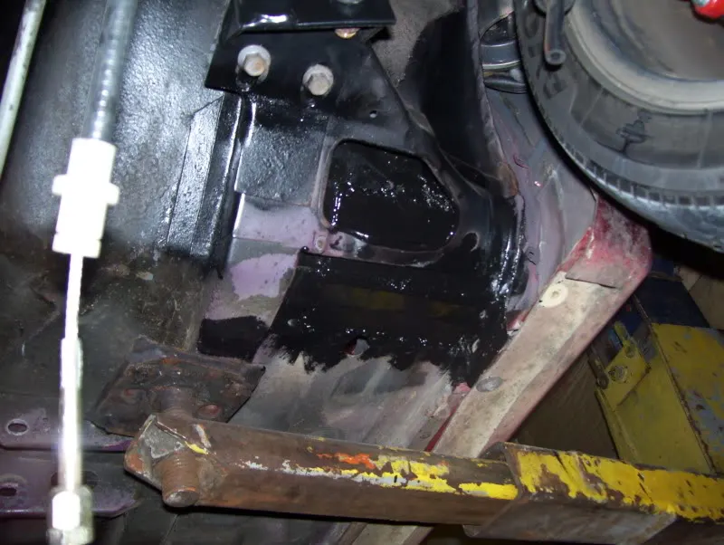

I had a good sized hole there on my vert, once i ground away all the crap metal I could almost stick my hand up there. I had access to a nice mig at the time (I only have a tig that I cant weld to save my life with) and my carpet was out so it was no big deal at all. at that seam there were like three layers of rusty metal so I cut it all out and welded a peice to go right up the firewall a little and behind part of the frame part. I'd say maybe a 2 hour job with everything out of the way and all the tools and material right there
Heres a picture after I patched it and painted the bare metal and seam sealed the crap out of it

Ok cool, both sides on mine need attention. Thanks for the picture, that helps a ton.
