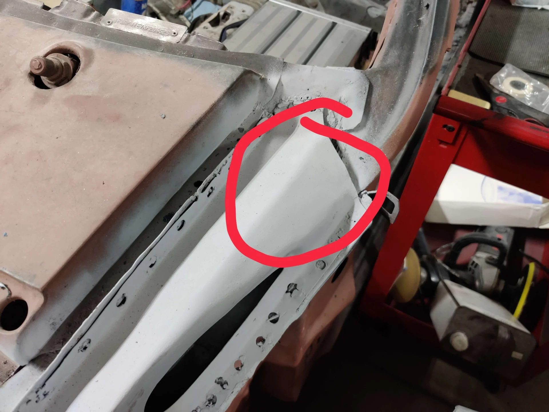

Here’s a pic I found from when I was changing the door pins. You can kind of see it here. I’ll post better pics when I get the car back.

It looks from the pic that the rust is in the pillar post, above the rocker but below the windshield. If that's the case, a good fab shop would probably bill you for 8 hours. They'd have to remove the door, cut out the cancer, fab a replacement panel, weld it in and reinstall the door.
On the other hand, you could remove the door yourself, cut out the cancer, fab your own replacement panel then have a friend or mobile welder come in and stitch in the new panel then reinstalll the door yourself and save hundreds of $$!
I'm ray Charles with that pic lol. If its not rot i'd just pull the door and fender then use a spot blaster to see how bad it really is some I've seen is just flakey surface rust that just needs to be removed and sealed, others I could put my hand threw it..
if it's rusted there you can bet it's rusted just above that under brace just below the windshield. you'd have to pull the fender to see it. Both mine and my father's car rusted there and they are Florida cars. That being said its almost definitely worth it to fix it provided the rest of the car is structurally sound, like the frame rails and floor pans and stuff.
