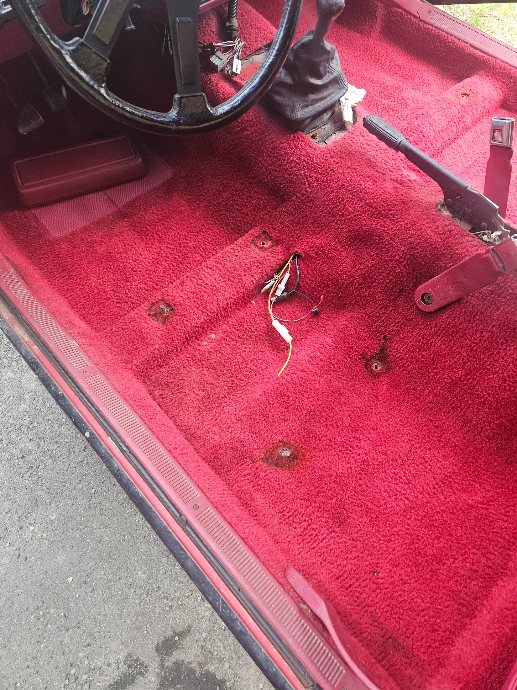

Had a chance to finally fiddle around with the car for about an hour or so. Managed to replace the ignition cylinder without major issue and it works just fine at least mechanically. Hopefully it'll engage when the time comes.

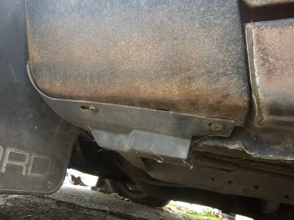

Aside from a spot of rust under where the battery tray was its pretty solid. I also scoured around the car for more rust on the underside. Pretty decent from what I could see. The dog legs in the fenders are of course less than stellar but salvageable I would guess. Not restoring the thing just getting it to driver status. I might repaint it but it's not a priority for me.

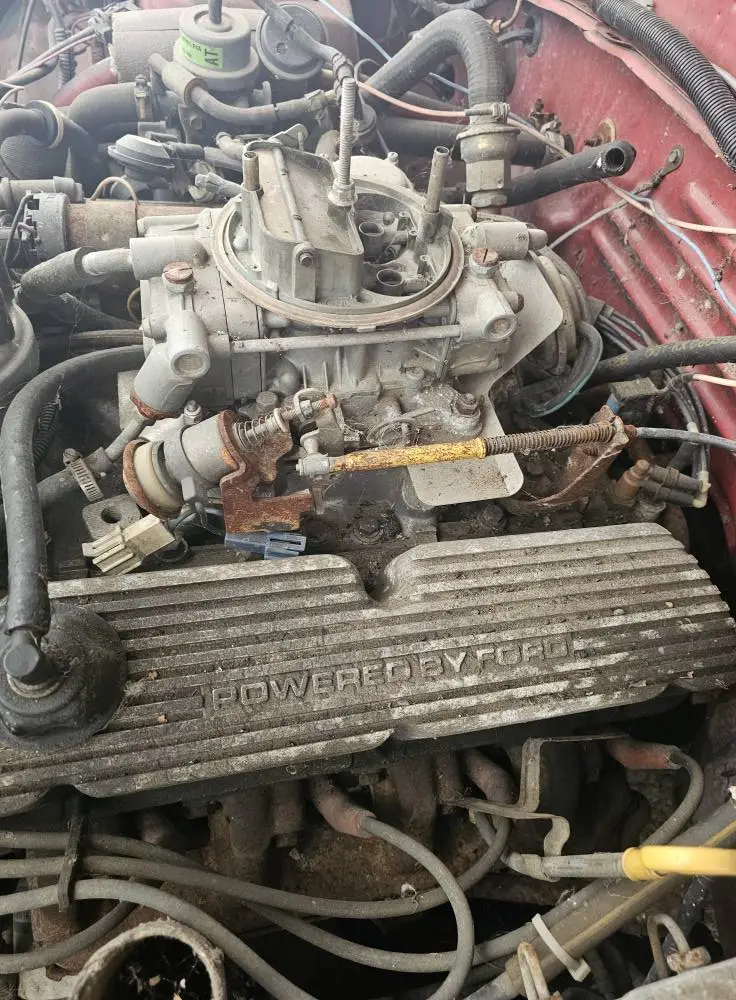

I did have some questions about the carb. Looks like it's a 4160 style holley that the PO swapped on. He claimed it's from an 83 or 84 and it "made a huge difference". I don't think he would have noticed any HP gains from it though with the smog pump still hooked up and if you did swap it from a later car for performance why keep the pump at all?
At any rate are the intake and carb worth keeping on or would I be better suited to swap it with a more performance oriented and easier to rebuild/maintain?

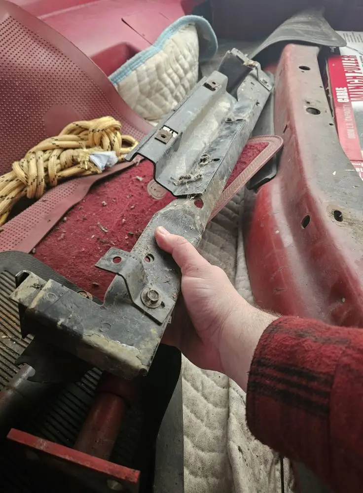

Another question I ran into the front end parts in the rear of the car. I had assumed the bumper had been removed to have the car painted but apparently the front end was removed to fit in his trailer when he brought the car down from Alaska. You do what you have to I guess. Anyway I have no idea how these bumper shocks attach and it appears as some of the hardware is missing from where the fenders attach to the bumper. I looked on the core support but nothing really jumped out at me as for apparent places for them to go. Pics I took are of the mystery parts that I have no clue what their names are.

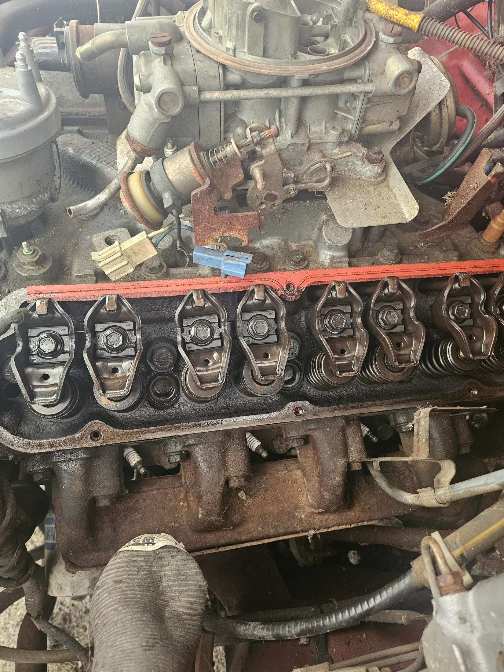

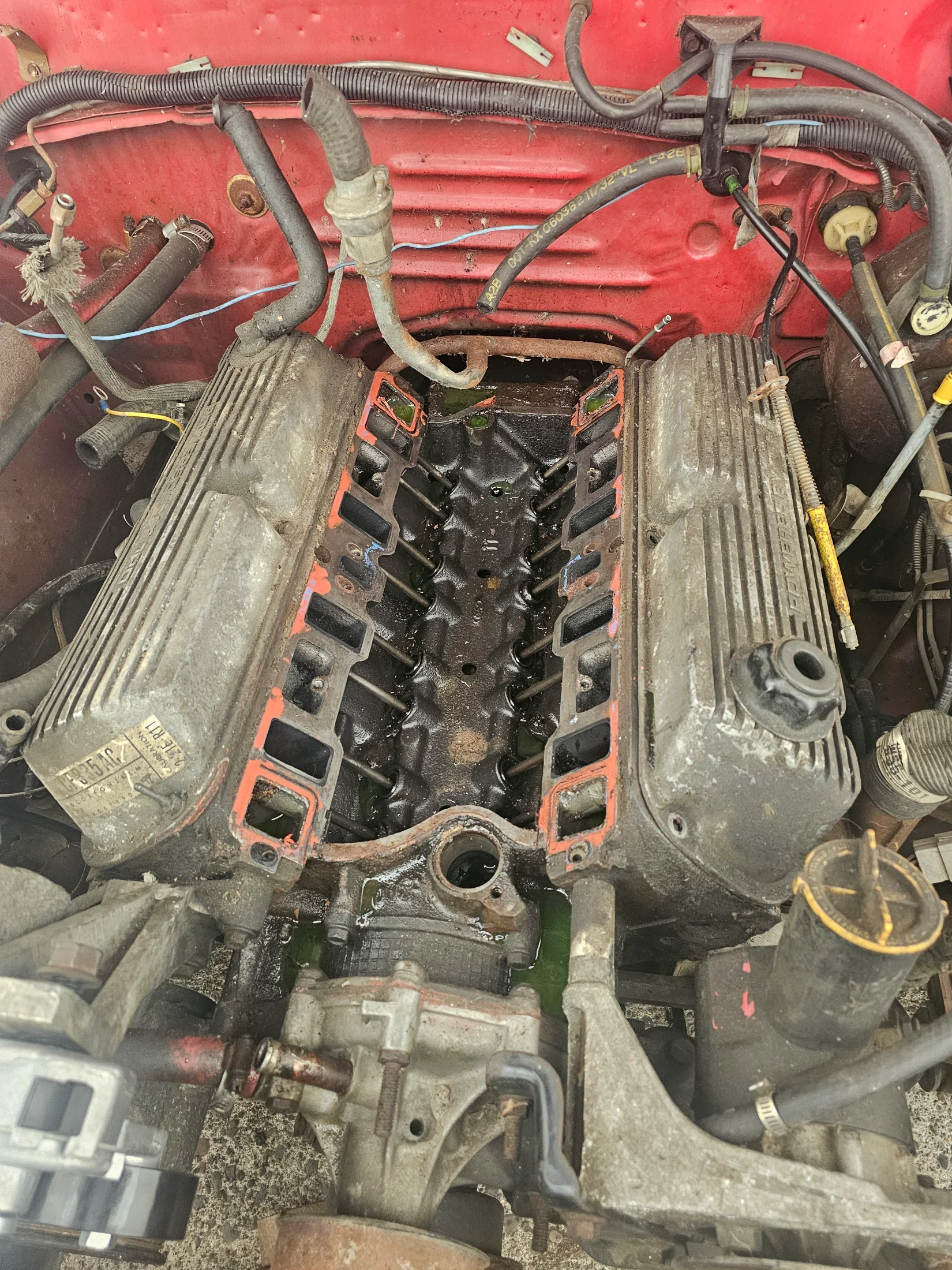

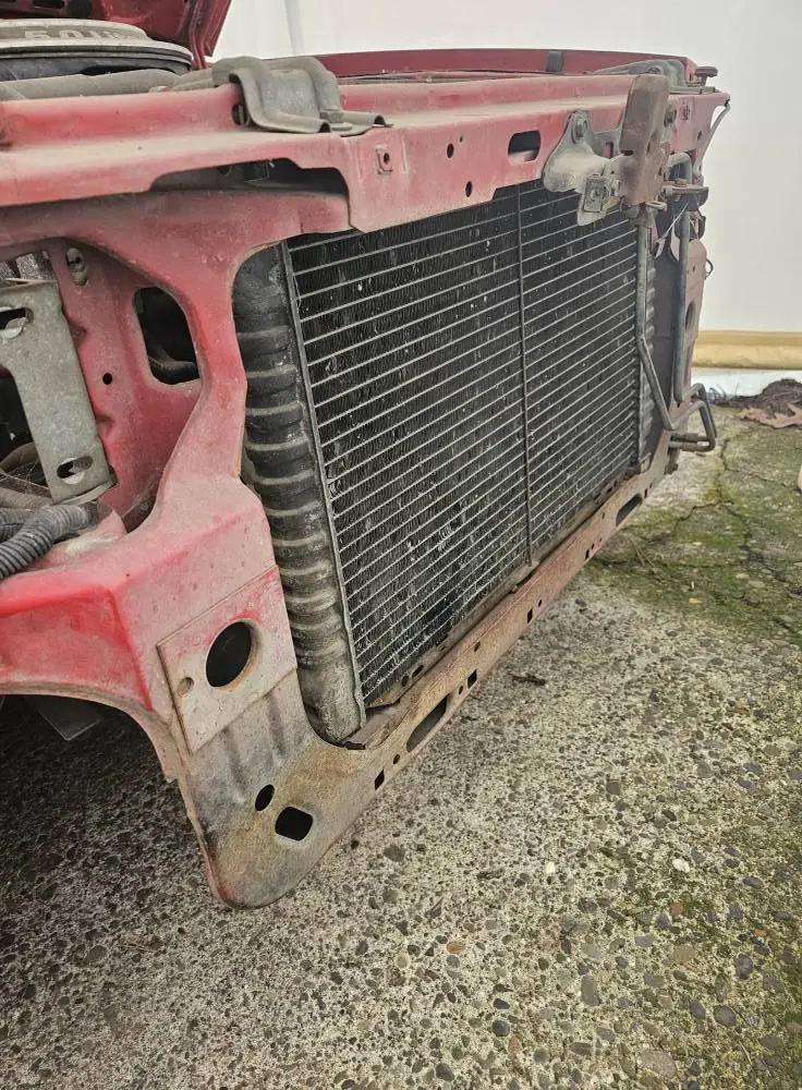

A little update for you guys.

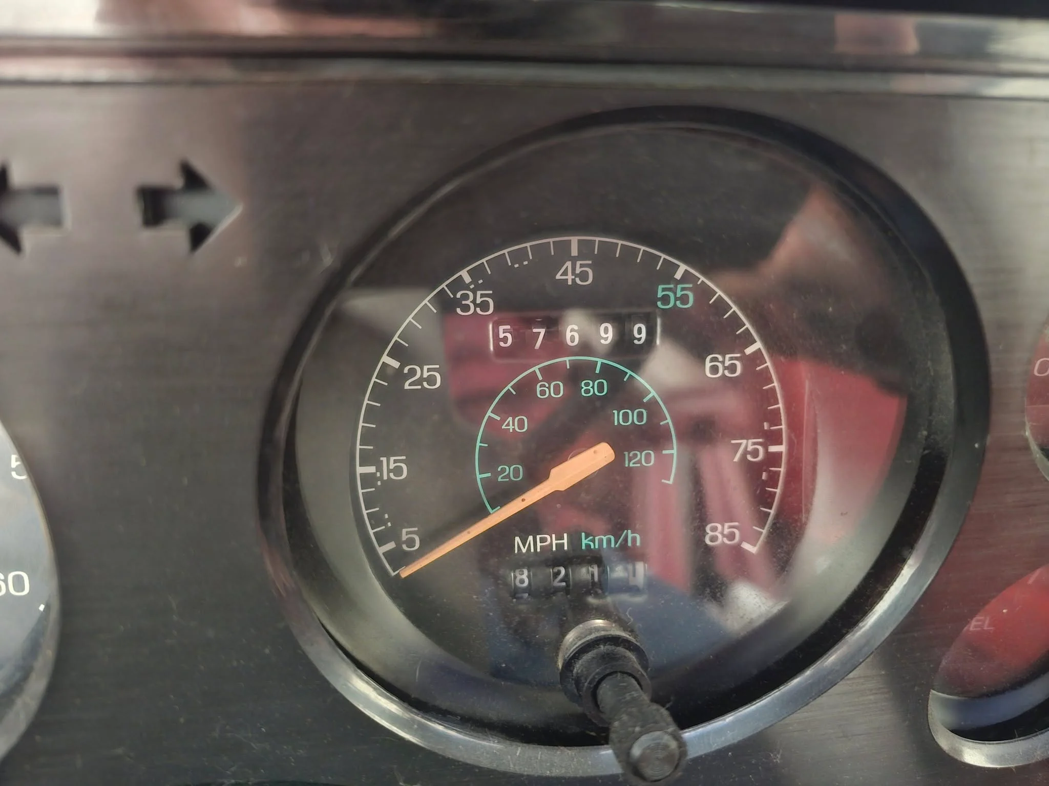

Probably the cleanest engine I've seen with as long as it has been sitting(1989). Odometer says 57k I am prone to think that is accurate.
Managed to swap on a summit intake and edelbrock carb, carb will need a spacer to clear the valve cover for the throttle linkage to operate correctly.
Discovered the EGR pipe runs down to muffler. Definitely going to end up going dual exhaust sooner than i thought. Probably just cut that tube off at the muffler and let it be loud.
Swapped in a new tensioner since the original one was shot. It's the newer style but it's all that's available new. I assume it goes on the same way the old one did? I don't have a picture of it but will get one tomorrow.
My plan is to bypass the heater hoses for now. Wild to see a steel line in the rubber of the hose on the heater hoses along with a spring.
As for vacuum I assume I just need brakes and the distributor and nothing else operates on vacuum aside from maybe the wiper fluid. I don't think there is cruise control on my car and no AC for sure.

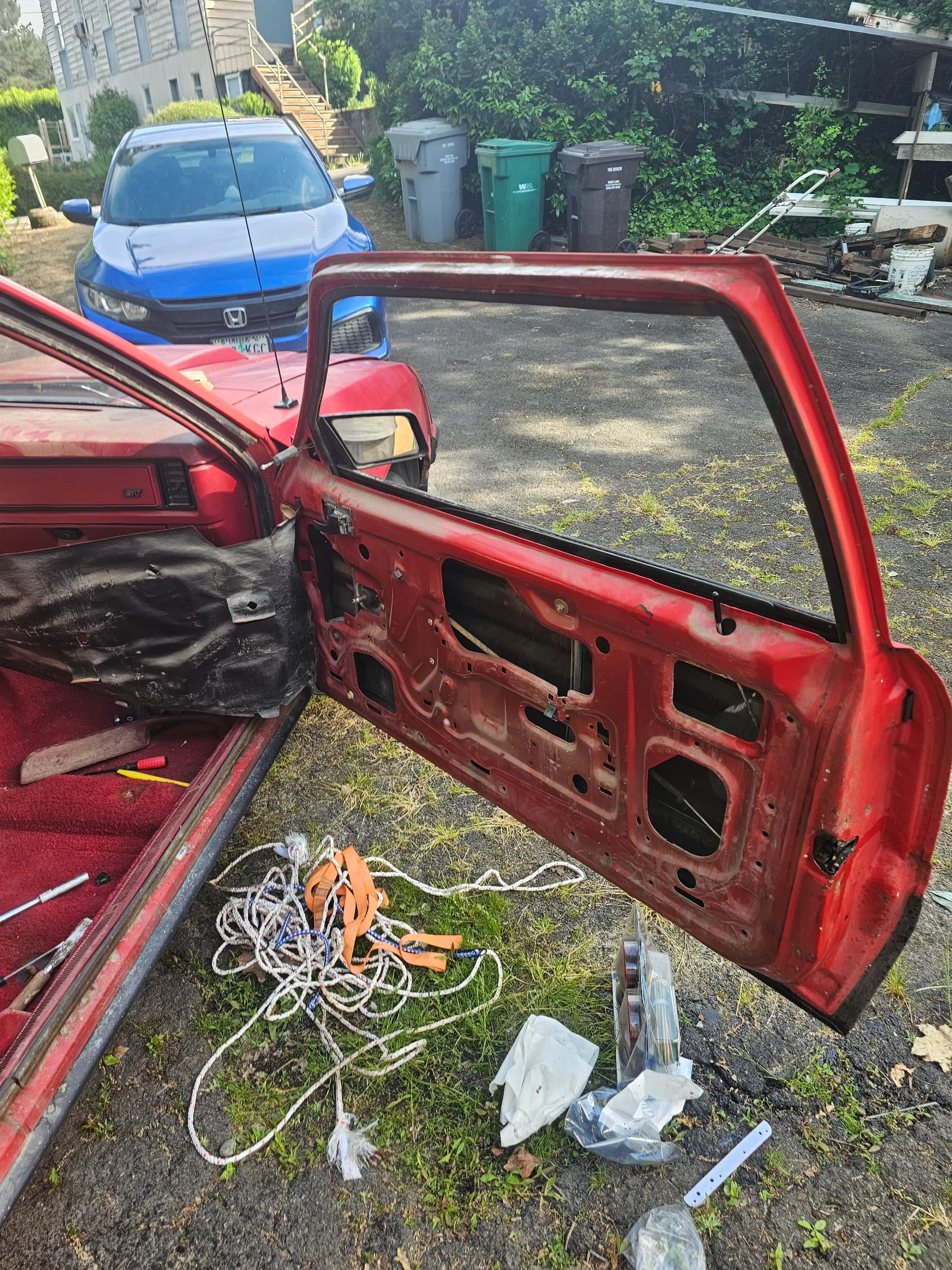

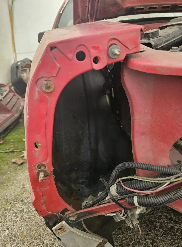

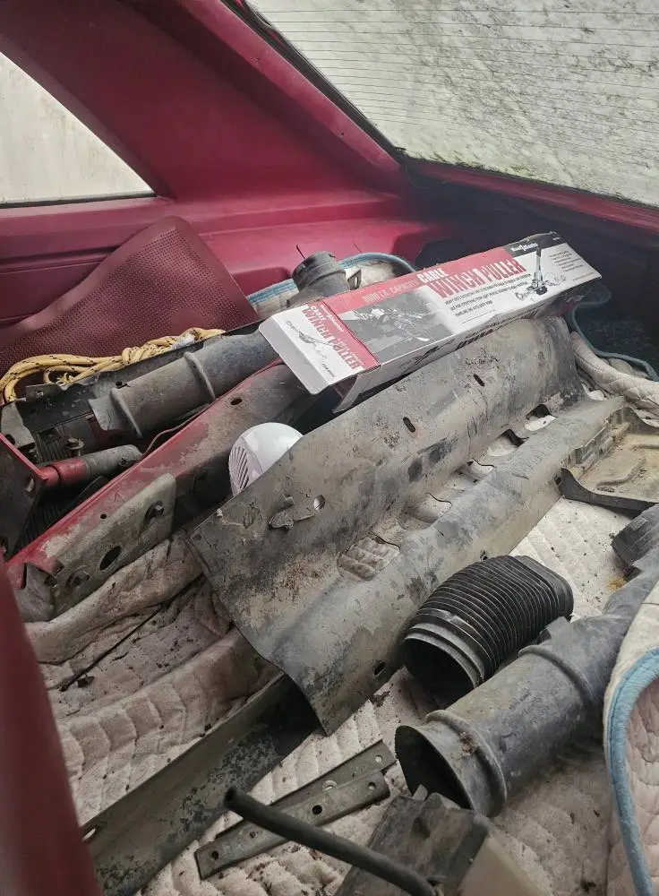

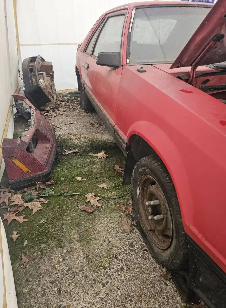

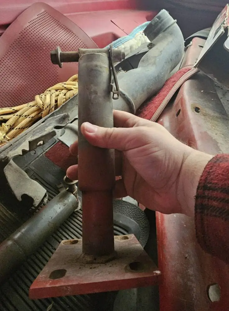

Spent a little time messing with the bumper and trying to piece that back together. How does this piece attach? It almost looks like a license plate holder and bottom brace for the air dam? I am missing all the hardware for the bumper assembly. These rubber pieces important too? How do they attach?
I attempted to remove these guys from the fender but they were pretty well rusted in there and I was curious where I could find some replacement hardware for them.
When I did get the car running I had a small fire and burned up some wires down by the trans. I assume these were for reverse lights? I am planning on swapping to a T5 so I am not too worried about them. Also what the heck is the giant square exhaust chamber about? Smog? Either way its gonna go.
Finally after the fire and the direct sunlight I decided to wash the thing for the first time in nearly 40 years. A little comet and some elbow grease and it came around. Lots of pitch damage and staining that wouldn't come out but I did find all the dents so that is a plus.

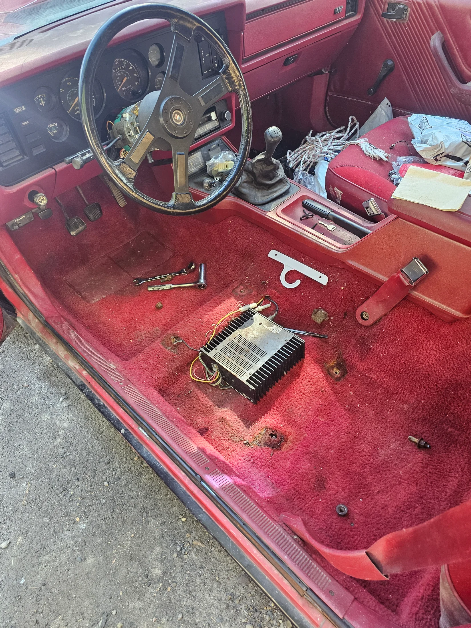

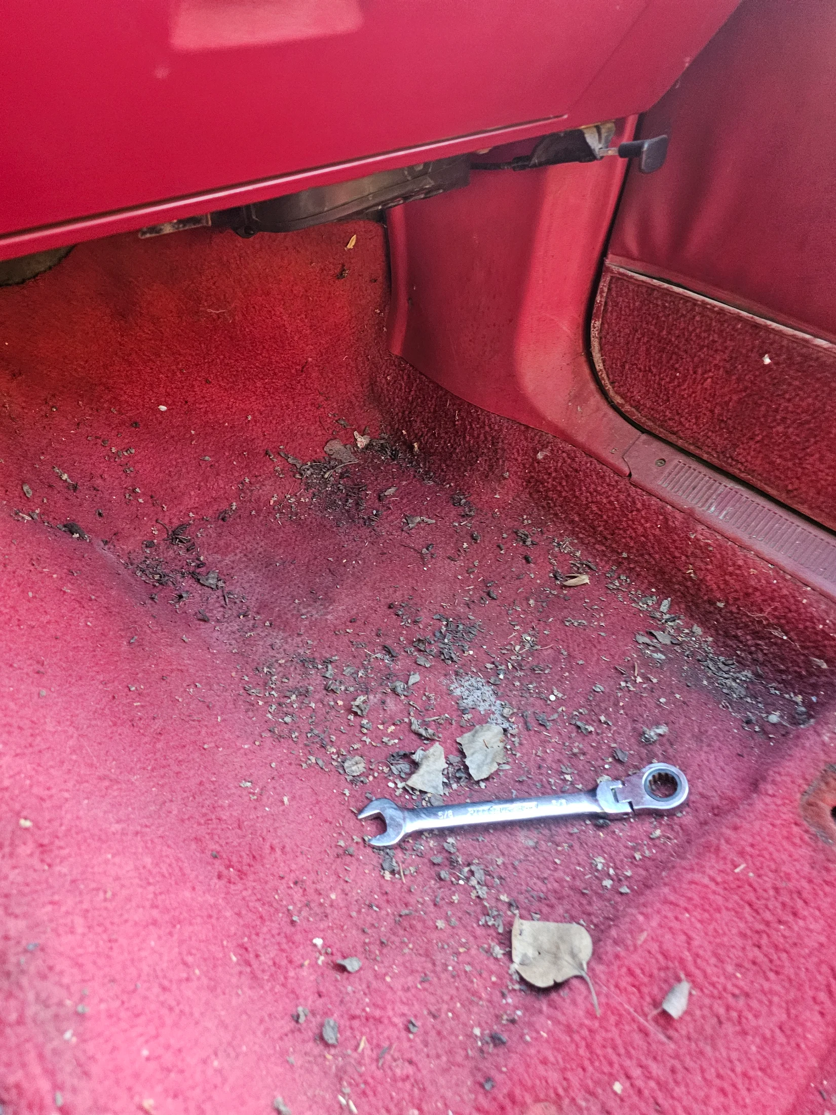

Another update with more pictures.

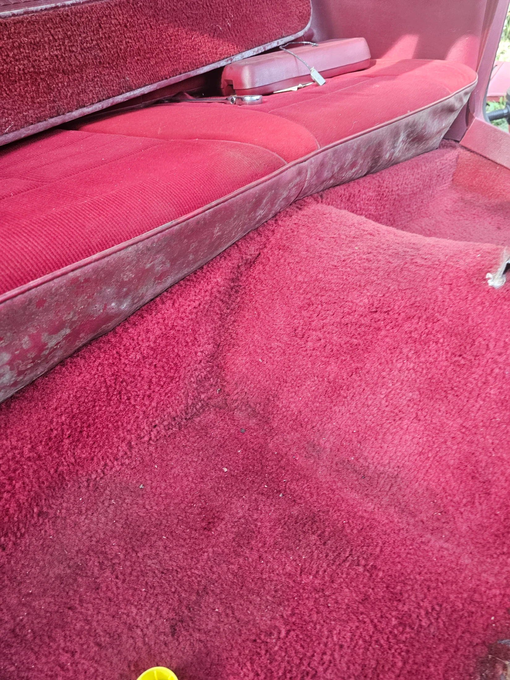

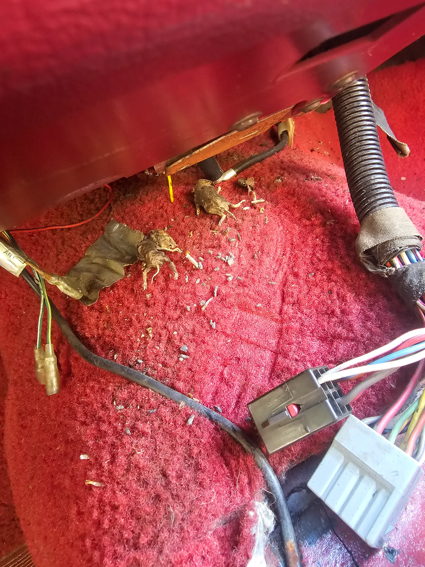

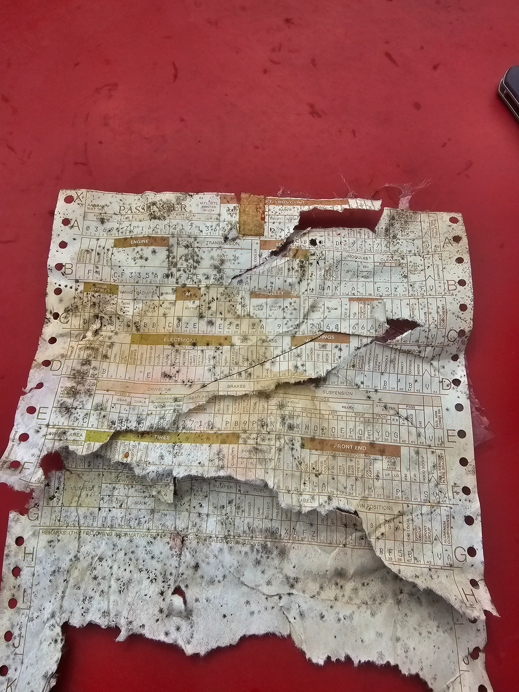

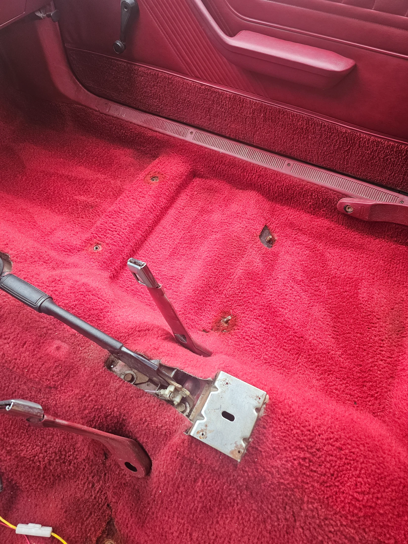

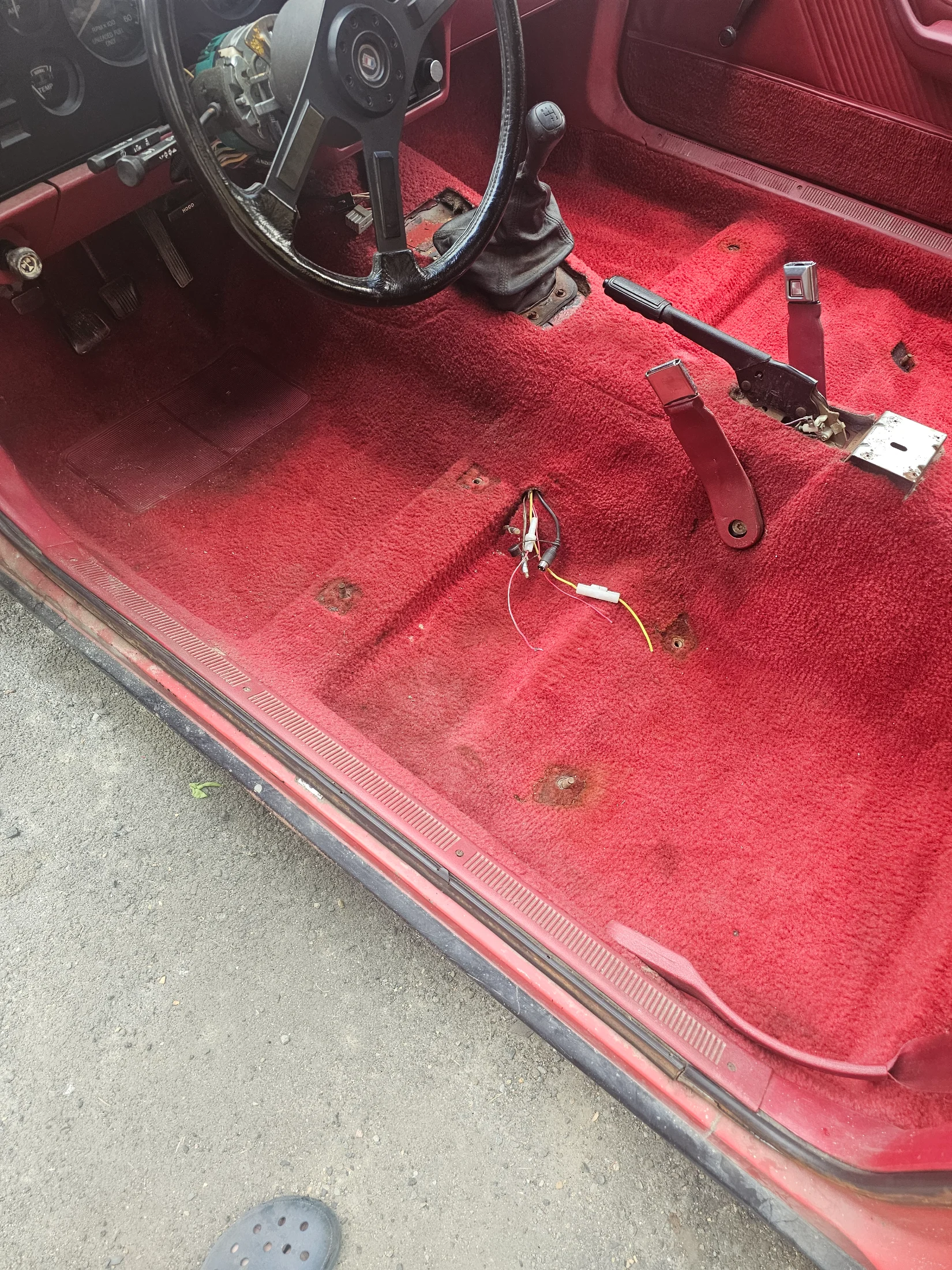

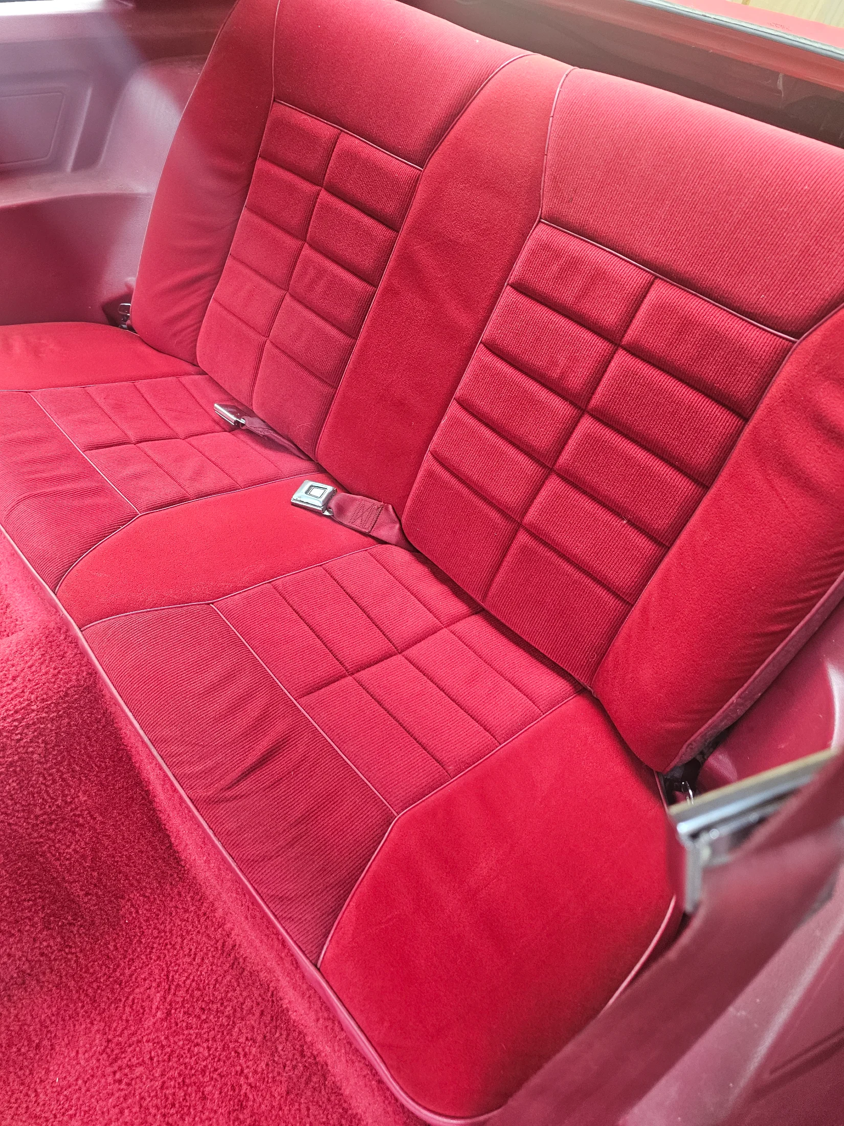

Took the weekend to go to the beach with the fam so progress was a little slow. Managed to get all the turds vacuumed out of the interior along with an eviction of the former residents. The real success story of the day was getting the passenger door opened after 36 years of being shut along with the lock cylinder replaced. Getting the interior out was a chore but the carpet cleaned up well enough. Imagine my surprise finding an Alpine amp to match the alpine stereo! Installers used duct tape for wire connections. I'm shocked it hadn't caught fire. I'm going to pull the stereo out anyway and hope to find a factory ford radio and figure out how to adapt it to bluetooth. I will take the back seat out tomorrow and get the mold off of it and with any luck find the build sheet. Time permitting I will tackle the brake system. Master has fluid but pedal is hard as a rock, I am hoping I can swap out soft lines and bleed with some success. Wish me luck and thanks for tagging along!

A few more progress pictures. Recent progress was getting both lock cylinders replaced and cleaning most of the mold out of the interior. I still have a couple of rounds to go with the seats when I have the time. Carpet came around okay but it'll need to be replaced eventually. The great success was finding what was left of the build sheet under the rear seat! First car I've owned that I was able to find one. Anyway they reproduce these? I have seen listings for reproductions on CJ Ponys website but its just a picture of the blank paper and no real explanation. It's not a must have item of course just neat to have.
Lots more work to do as I have yet to tackle the brakes and I sprang a leak on the thermostat housing so on to fix those.

Nipped off the old mounting hardware that goes from the bumper into the fender, bought some replacement hardware for that, but the holes in the header panel are hogged out so I am awaiting some panel bond in the mail before I tackle that fix.
While I was looking over the bumper I managed to break the bumper support bracket off and the fiberglass just exploded as a result. I am hoping the panel bond will make short work of that as well, suggestions welcome on how to fix the fiberglass on such a delicate area. I will try and get a picture tomorrow to showcase how it broke.
