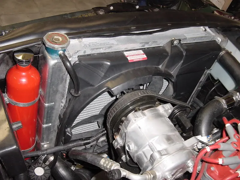

Any way, I picked up this fan from there (came out of an Econoline). It flows enough air to pull my car down the road ;) It's sitting behind a Northern 19x26 (for size perspective). It's a single speed. I paid $15 dollars for it. There were more of them there.
Using an eBay sourced 75amp Bosch relay.

Fans from the 3.8L Taurus are popular. I got mine for like $15 from the junkyard. Two speed fan, high-speed requires a high-amp (70 amp) relay. They pull a ton of air.

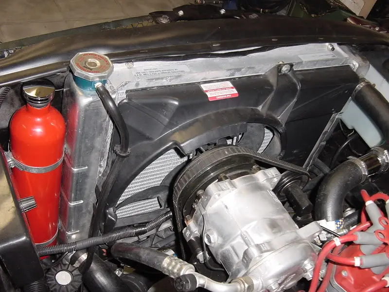

I got a Taurus fan on a Northern radiator. A 75A relay and a better than stock alternator (at least 100A) is required if you go this way.
