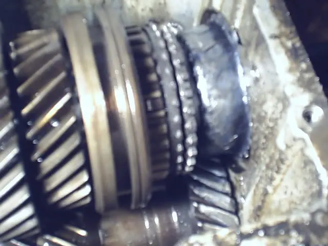

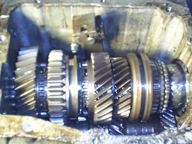

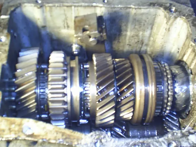

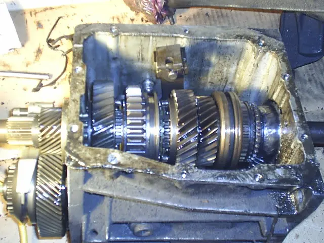

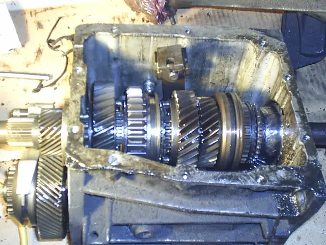

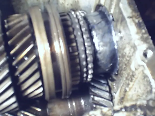

heres the rest of my horror story, i melted/smoothed the cluster 4th gear, so the tranny couldnt do gear reduction and could only do 1:1 (4th gear)
