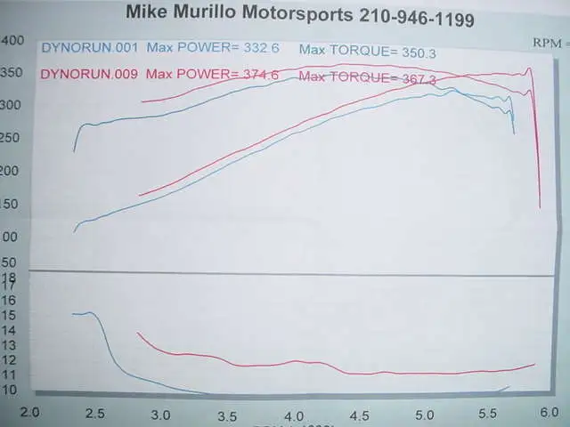

Well, it pulls throughout the rpms but it REALLY pulls around 4k-6k. That's when it pins you back into your seat.
Here's my dynosheet from when it was tuned a couple of years back. I can't find the most recent one for some reason but here you can see the powerband pretty well.
