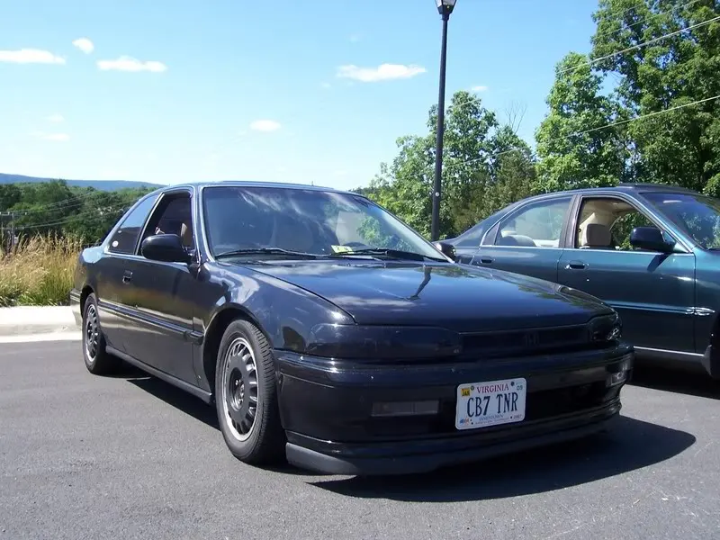

I started with a 1990 Honda Accord:

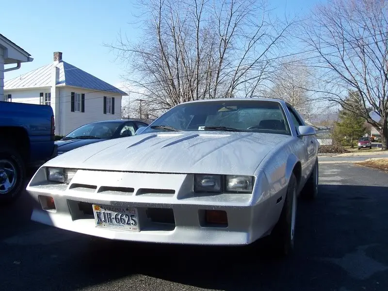

Then a 1983 Camaro project:

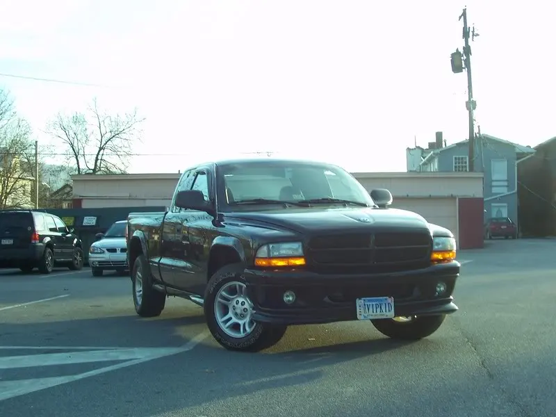

Then a 2003 Dakota Stampede: (Not a recent photo, now has windows tinted, K&N intake, and a sound system that will make your face itch!)

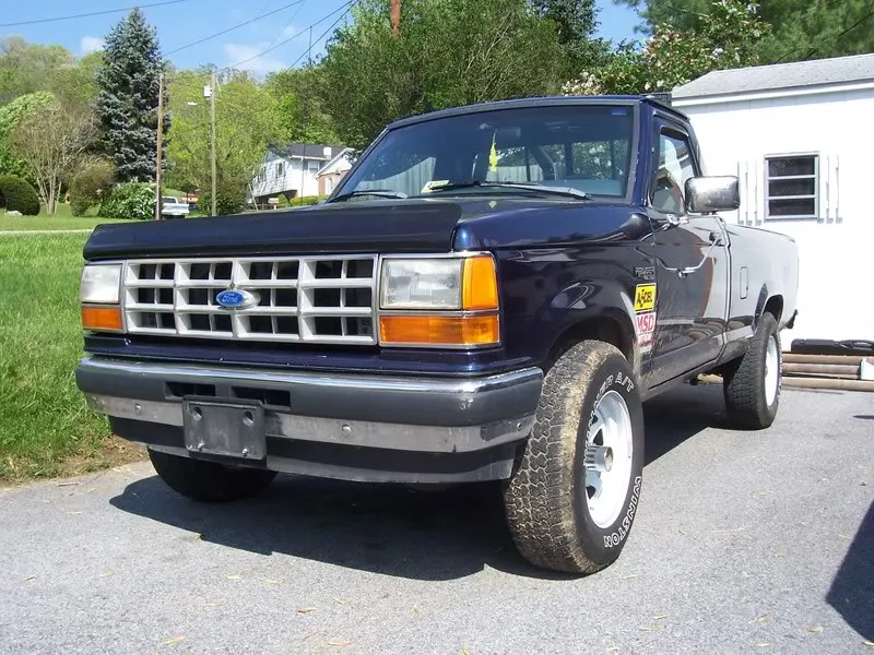

And my 1990 Ford Ranger which is now for sale.
