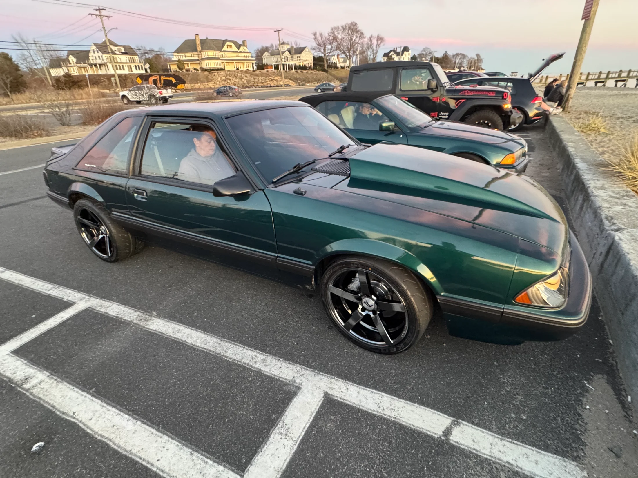

I see now my signature is not there.... I am moving this into a 1992 Mustang LX Hatchback.
Ah! Just making sure. lately, everybody with a "dune buggy" and a 302 has been showing up around here. :hide:

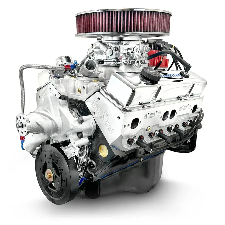

I am saving right now for a blueprint SBC in my corvette project..... I added up some hard numbers and I can't build one for this price.. I can't build one of their long block engines up like this for the same price.... Same NEW block, 4 bolt main, one piece rear seal as the SBF except a better price...

When I was young a 340 horse 350 was no slouch,, Not looking for big horsepower to get me to Cars N Coffee.. This engine sells for $5599.00 and I can pick it up at the Georgia Summit warehouse.....

I don't know that much about blueprint parts, but if their crate engine is only rated for 415 flywheel hp, i'm not impressed.
You must have a warehouse full of 500+ HP, NA, hydraulic roller, pump gas Windsors.
Can I have one? :D
  • Haha
Reactions: General karthief
Putting in perspective, 415 flywheel is 355 rear wheel.
You been around a long time, honestly, does that number from a 347 impress you?
I've seen stock shortblock 302s make more than that.
