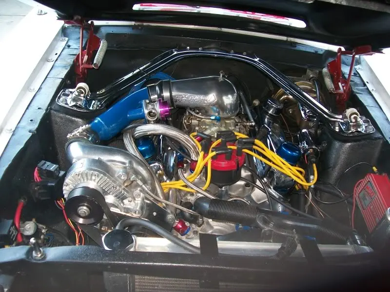

#17
  • Oct 18, 2010
  • #17
my engine bay.. ive been looking at low compression 347's thats why im curious. People say its a waste since you will be maxed on hp.

ive got mine finally stickin to the ground at the track, kinda scared to launch it REAL hard. Most ive launched at was 4k and it bogged. Im heading out there wed for a higher launch. Ive been kinda using baby steps for launching harder. Mine is a little 302 with 10lbs of boost.

It's a demon blow thru carb and I'm shocked that it runs so clean. I have all the eq. to install f/I but it's too fun to change right now. I have a question for you though...how did you handle the supercharger's intake? I am stuck trying to find a 4" 90 degree elbow that is flattened out..if that makes any sense. Yours sounds like a ball too.
