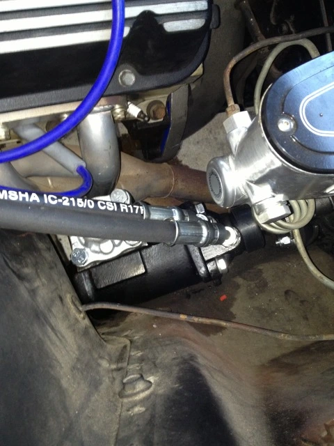

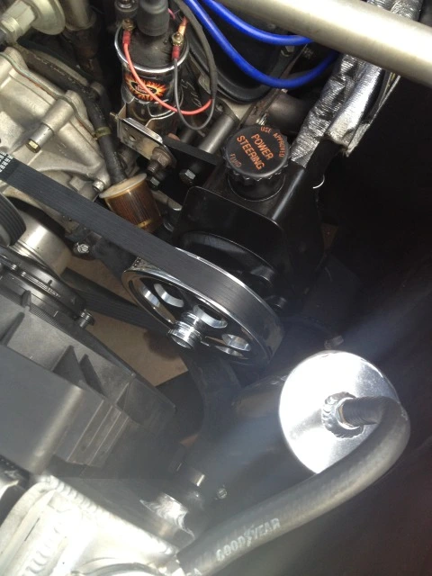

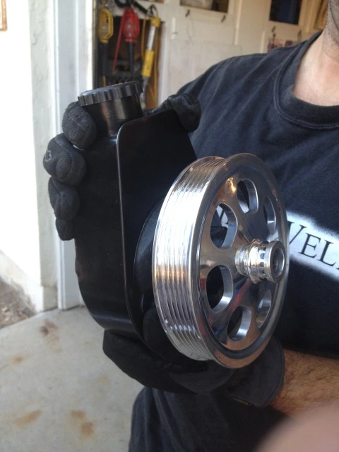

Been a long time but finally got the Borgeson kit installed. Solved the issue with the serpentine pulley and even though I never got the correct one from March I did manage to get the correct one from Summit Racing...a Billet Specialties pulley. Looks good and I love the way the car feels now. For those that need it in the future and run the Borgeson with a 6-groove serpentine setup, the part # of the pulley I used from Summit Racing is BSP-FM1035PC
