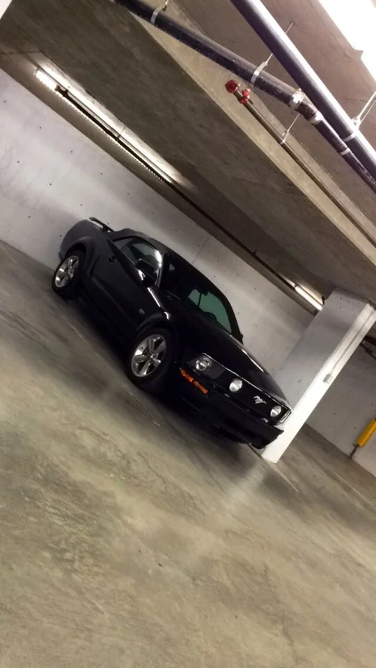

Hi all, so I sold my fox a few months ago... And now, I bought a 2006 mustang gt drop top! 5 speed (manual).
So a couple of things, it has a c&l CAI, hurst shifter, and what looks like borla stingers (axle back).
The car had been sitting for a year(before I bought it)... Anyway, I picked it up.. Drove it. Pulled hard a few times and at first noticed it wasn't overly impressive. Anyway, after driving it 10-15 kms I parked it... Started again after and it showed better performance... After parking it another spot for a bit and getting in, once I started it the check engine light was on. No diff in sound, idle, driving or anything. I put my code reader to it when I got home and it gave me two codes...
