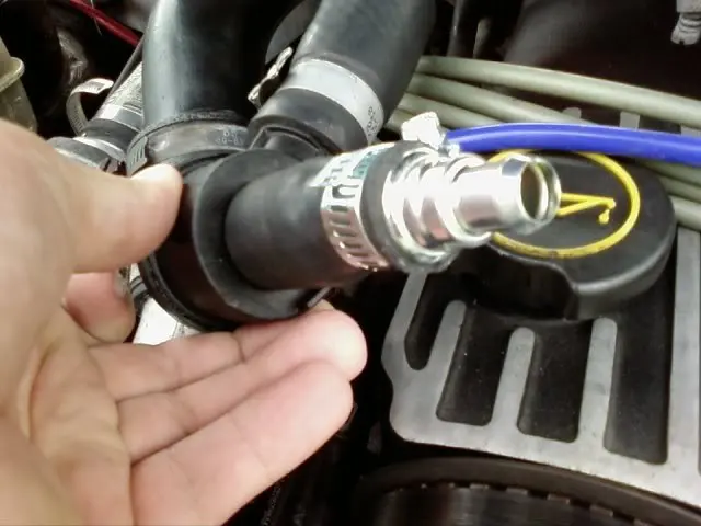

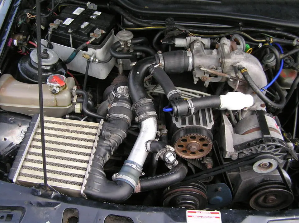

I guess you missed my post...it worked just fine for me . Here's a pic of the ghetto hardware store check valve.. (the white hand grenade looking thing above the alt.)
Then i got curious and even tried the biggest PCV valve i could get my hands on, but i was suspicious that it was too small in diameter and wasn't venting fast enough so i ditched it...
So yeah, putting a check valve at the end of the bypass valve will make it function just like a blowoff valve. It'll even make it go "whoooooosh" like everyone loves, but it won't make it any faster or run any better than plumbing it the way a bypass valve should be ran.

thanks 85 for the pics. that's neat you tried something different. Can I ask...where did you hook up that blue hose to? I sound like such a dummy but is that the vaccuum hose? And is that what effectively causes the bypass to open? I have so much to learn about blowers.
