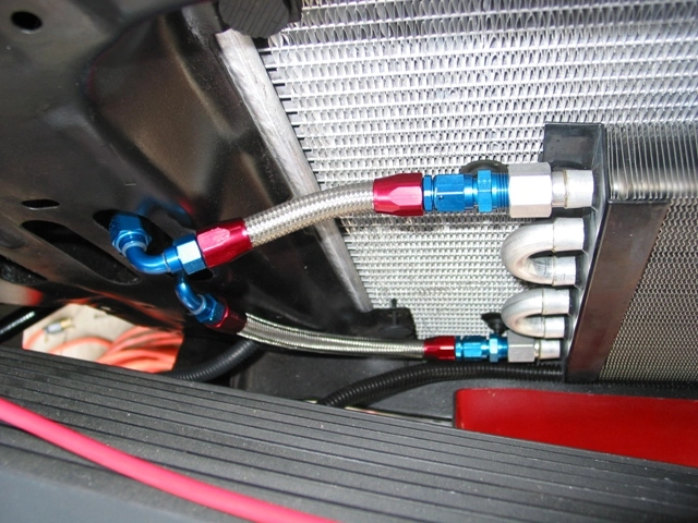

I can't say I did each end in 3 minutes, probably 7 or more each. But I did finish the job. Here's the photos.
http://www.edbert.net/plumbing.htm
...and one sample...

Edbert said:
Here's the photos.
Nice job.

gp001 said:
Also, what are the braided lines connecting to? If hardlines I would suggest making a plate the mounts to the core support and running bulkhead connectors
The braided ones in the picture above are connecting to other braided ones that go straight to the transmission.
The top line/hose has a small billet manifold that holds my trans temp sending unit, I don;t have a good picture of it yet, the one i took is pretty blurry and I did not post it. Here's what the device looks like (I used AN fittings on it also):
